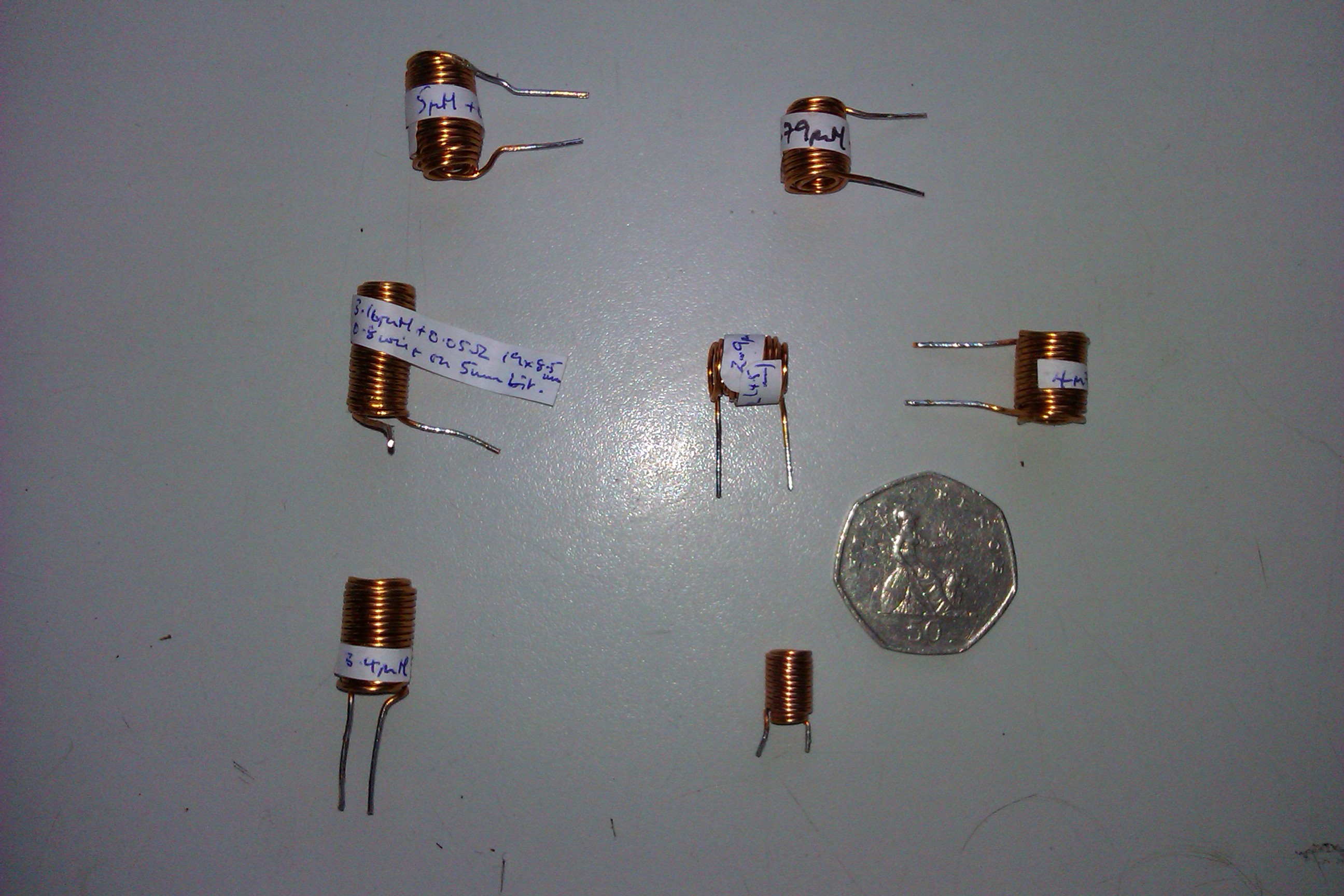

Christian, I wonder if you could elucidate for a total imbecile: I'm having similar issues with my PD 3875 build incuding a fairly 'edgy' top end. Do you mean something like this?
attachment.php
What do you mean by "15 or 20 turns in two layers on a 6mmm drill bit"?
DaveB.
Yup, that's exactly the circuit.
I mean 10 turns on each layer and you wind them by hand on a drill bit. After 10 turns you come back on yourself - still winding in the same direction and then you get both connections at the same end. They look jolly cute, incidentally - I'll see if I can find a pic to upload. Use 0.8mm or 1mm wire, or more, not so much for resistance but because it's less springy and will hold its position better.
Here we go. It seems from reading the values marked that 20 turns will give you a bit more than 2uH, but I think you'll have to count the turns - I don't remember what I did. One or two of those have 3 or 4 layers - and you can tell by which ends the leads are at.
Edit, maybe not wrong. 10 turns on each layer is probably about right.
Good man, thanks for that. I finished the amp (my first) three evenings ago and in many respects I'm very happy with it, not least sitting with a beer listening to something I made. But the lack of bottom end and the abrasive top mean that I suppose I've a way to go yet, though to be fair the ProAcs are pretty unforgiving. Onwards...
DaveB.
