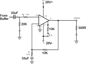

Although there is no evidence to support it, I want to believe that the LM3875 makes a decent headphone amplifier. It almost does as a standard gainclone, but the unregulated supply is just a wee bit noisy.
The case for: plenty of current reserves, designed to drive even lower loads than headphones with minimal distortion. Stable, easy to work with.

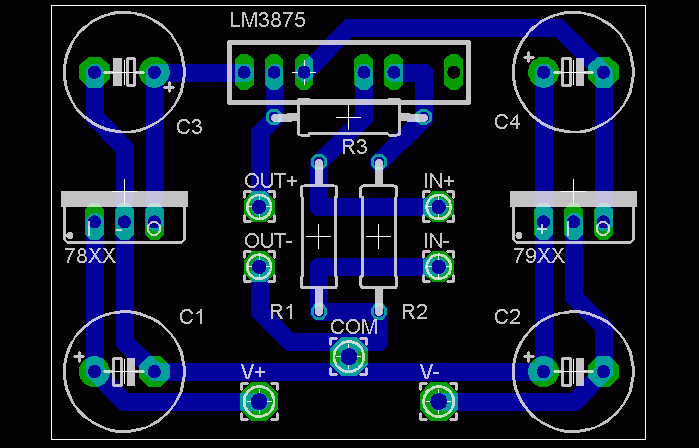

So, I figure, when not treat the LM3875 as you would any other op-amp in a headphone circuit: add in regulated supplies, and run it off 12 or 15V rails. (datasheet minimum is 10V)
This is a standard non-invering circuit, with no input coupling cap (might add it?). Simple as can be. PCB is 2"x1.4"
No clue if this is a good idea or a bad one, but I thought I'd share it.

The K-1000s aren't really a good example of a "typical" headphone... not too surprising a LM3875 based amp works well with them. I wonder if the LM3875 would still be a good choice when the load impedance and sensitivity start climbing into Sennheiser HD600 territory. My concern is how much noisier the chip is compared to typical audio op-amps. Let's try to figure that one out:
From the datasheet, you can guestimate that the THD+N at 10mW into 8ohms (26dB gain test circuit, 80kHz bandwidth) is 0.1%. This, one can safely assume, is almost entirely noise... the N part of THD+N.
The output voltage at 10mW/8ohms is: 283 mV.
The input voltage at stated gain 20x is: 14 mV.
0.1% of this is 14 uV.
Divided by sqrt of 80kHz, the e_n is 50 nV/sqrtHz
The input referred voltage noise (e_n) of the LM3875 is 50nV/sqrtHz about 10 times (20dB) higher than a typical audio op-amp. It comes down to whether a 20dB increase in noise is a price worth paying for the (presumably) lower distortion.
The output voltage for headphones is about 10 or 20 dB lower than loudpeakers. So the amplifier noise will be that much more more "apparent".

To me the voltage regulator really aren't nessecery; my speakers are completely hum free. What's good enough for speakers, will be good enough for headphones provided a attenuator netwerk is used out the output.. say.. 680R-out-33R--GND
If you are actually building a n.i. Gainclone-type circuit from scratch just for headphones, I suggest lowering the gain from 30x down to 10x, by reducing the feedback resistor from 22k to 6.8k. Everything else can be the same, though an output series resistance of 120 ohms or so (see next paragraph) can be added.
An attenuator (resistor) at the output will indeed improve the signal to noise. However, I'm not too sure that a values above 120ohms are such a good idea. The load impedance of headphones is relatively flat, but still... on the other hand it could be just the ticket - what do I know? The correct value can be easily found by trial and error.
If you want to listen to headphones with a standard chip amp (Gainclone or otherwise), then the series resistance can be easily added as part of a wiring circuit connecting the output to the headphone jack. Add another pole to the mute switch, and you have a speaker/mute/phone switch. Very professional!
It may well be that the internal amplifier noise is greater than the output noise caused by the power supply, even when unregulated. If thats the case adding voltage regulators wont make any difference to the output noise.

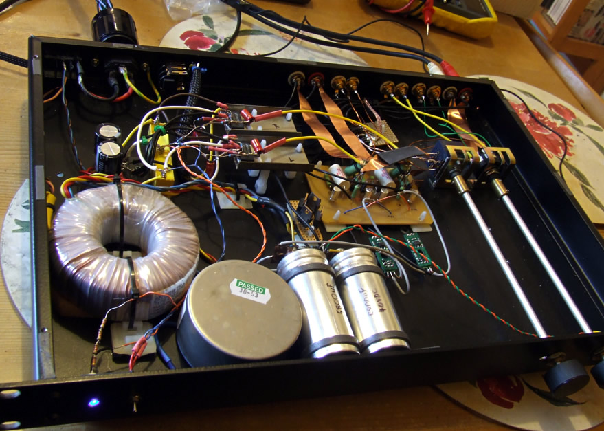

Sorry to dredge up an old thread but I thought this more correct than starting a new one...
I spent all of yesterday adding a headphone section to my DIY preamp (which is based on Pedja Rogic buffer circuit). I used a pair of LM3886 on tiny heatsinks running off a nice transformer of 17 - 0 - 17 @1A (26VDC+-). I used non-inverting configuration using 1K to ground with 33uF cap and 10K feedback resistor. I used a 1K input resistor and 20K to ground (for extra protection against the deadly floating input).
At first I noticed 40mVDC on the outputs so I added a DC blocking cap on the input. There's now basically zero DC offset but I *am* a bit concerned that if I get a fault condition my HD600 'phones will be fried instantly. Should I add DC blocking to the output or will it wreck the sound?
The sound? Well I don't own a headphone amp so have nothing valid to compare this to but it sounds great to me running off a test cd player (lightly modified Marantz CD52). After more testing I'll get it in the system running off my FULLY modified Arcam Alpha (TDA1541) player. The sound is I suppose quite dark with great bass and dynamics and is fairly open and harshness-free. You can, of course, just keep going higher with the volume. I did a rough calculation showing max output into these 'phones is probably about 1W if accidentally turned up full. I'm sure it could break them but it's unlikely to happen by mistake.
I don't really like the idea of using output resistors as I expect it would harm the sonics, but is there something real to be gained there?
My test headphones (Creative ear buds) show huge hum and noise which is inaudible through the Sennheisers so I'm not sure what to make of that. The discrepancy is enormous though.
Just wanted to share this little project, which took me about 14hrs non-stop yesterday!
Simon

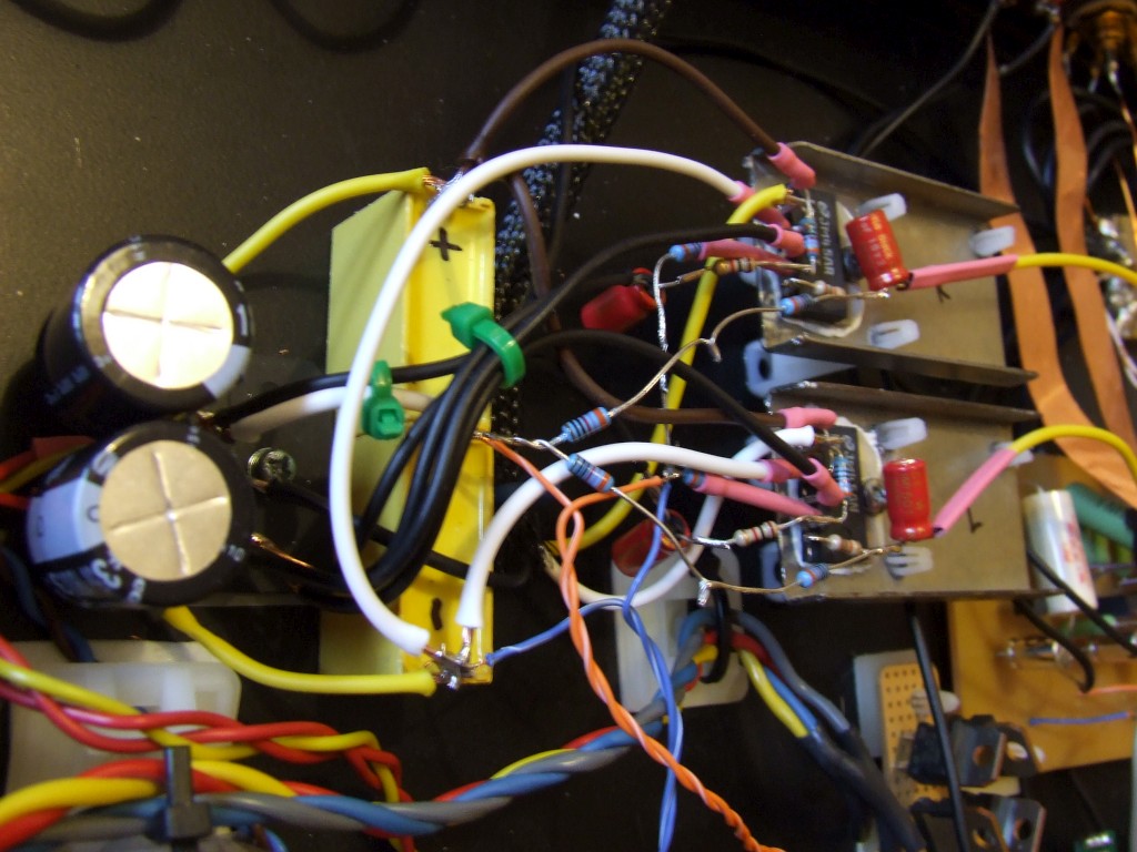

I wired up the muting circuit using 10K resistors which are joined together and then feed the switch that connects them to -Ve. Tagged off this is a blue LED (via 4 x 1.2K resistors in series [to stay cool]) to indicate the 'phones are unmuted. You toggle the switch to mute and the light goes out, I'm well pleased with that lol.
So far I've not used any bypass caps, which I realise is not really ideal, though the psu leads are short. The PSU is a big packaged bridge, cheap 1800uF Nichicons, bypassed with a 10uF film cap per rail.
The tiny steel heatsinks get very hot (you can just about keep a finger on) but are no hotter after 30mins than 2mins so I think it's perfectly safe. I didn't realise the LM3886 could get so warm at idle - just maybe I have an issue like oscillation - any opinions? Is the gain too low?
Thanks for looking and I'd appreciate any opinions from chip amp aficionados or headphone users, particularly if I've done something stupid.

the gain is almost at the minimum that National recommend.
I think you would see quite a bit of overshoot on faster signals when so much of the signal is fed back.
The reduced feedback when using gains set to between 25 to 30times gives more accurate reproduction of the input signal.
This is why many builders say they prefer a gain of 28times to other gains they have compared.
It is just possible that you may have some oscillation. Have you scoped the output?
How loud is the noise when feeding headphones? I would expect 95dB/mW headphones to show up noise much more than 95dB/W speakers
The 33uF input cap is completely mismatched to the 33uF NFB cap.
3.3uF input and 100uF NFB should sound quite different. You would need to experiment to find which is nicer.

Thanks for your useful input. National say a gain of 20 is normal but I can't see a minimum. I think it's well-known the chip is not supposed to run at unity gain and I sort of guessed ~10 would be a fair compromise between stability and being too loud and noisy (gaining only to attenuate). As this works quite well I could try a slightly higher gain and still have some use of my volume control. To mitigate the volume range issue I could attenuate the input a little more..
I've not scoped the output as I don't have a scope handy, nor do I know how to use one.
The background noise is very low on my Sennheiser HD600s and very loud and clear on cheap nasty headphones. On my Senns I hear just a touch of hum with no music playing and the noise of the source (CDP with Class A FET output stage - quite noisy itself).
If I use an input cap can I disregard/remove the NFB cap? I have some CHEAP 10uF film caps I could use on the input. I may just try this as it may sound better than the Black Gate Nonpolars I'm using.
I've put this amp into my system now and listened to a couple of CDs from my proper CD player. It does indeed sound excellent. I'm quite sure it would disgrace various standalone headphone amps, at least when running these Sennheisers. That's not to say the sound is perfect, it isn't. But then, is headphone listening ever very good??
