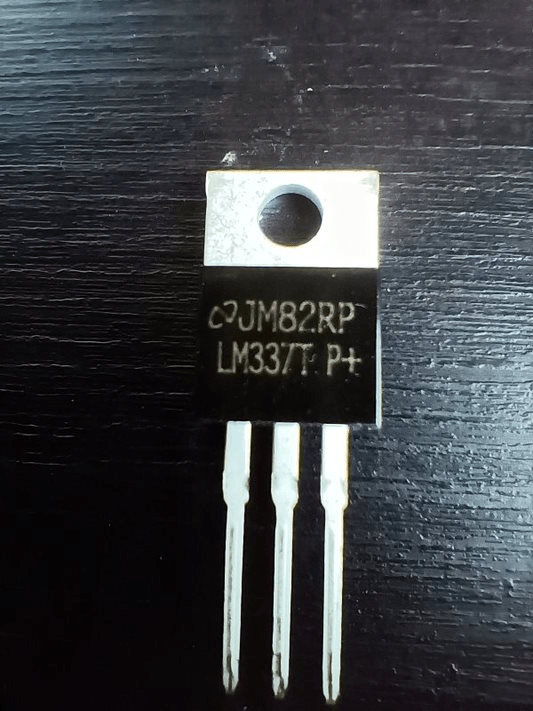

Just in today, the last batch of LM337T from an eBay seller based in China. Slightly different markings, and they all test good.
From a sourcing point of view, I have 3 bad et 2 good sellers. The odds are not great, but I don't think it's an epidemic; just know there's a large quantity of bad items out there and test them on arrival.

My personal experience: I bought semiconductors from Ali 3 times in the past . The BJT worked ok. The Depletion MOSFET arrived were re-printed Enhanced MOSFET, and none of the IC's arrived in a tape worked. Don't buy from them unless you know some vendors that can be trusted.
You must add the time needed to build the jig to test pulls/fakes from China. Then you still don’t know what they really are and what noise performance is.
Getting cheated by choice and rewarding the scammers, that’s what it is. This for about the cheapest classic regulators one can buy. Both LM317 and LM337 by an A brand cost less than 1 Euro each at a reputable distributor.

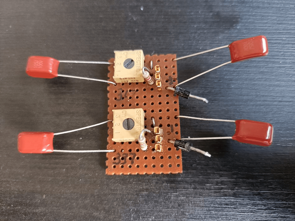

Maybe 10 minutes to build the jig (I didn't time myself).
And I don't care what they are, as long as they: 1) don't drift (check) and 2) survive shorts (check).

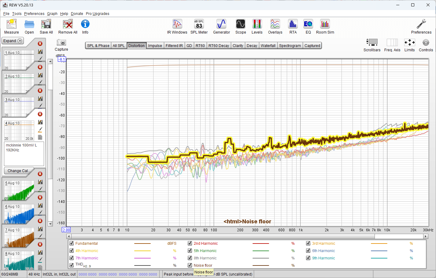

Re. noise performance, I totally relie on my secret recipe: a cap multiplier at the receiving end. A quick test with REW + Focusrite looks promising, at least better than before.
Don't get me wrong, I have nothing but contempt for scammers, but then again, I don't expect factories to do more than sample testing, else we'll be paying 10-100x more. I also don't think much of people with their noses in the air.
It is not from factories you choose to buy from. In your first post you explain clearly that you repeatedly bought the regulators from dubious sources. That are scammers as you also pointed out but you thought it to be an LM337 epidemic. Truth is that you receive relabeled non functioning stuff that may be chinese knockoffs (by own choice thereby supporting the scammers). They are good at that over there and sometimes the parts even regulate.

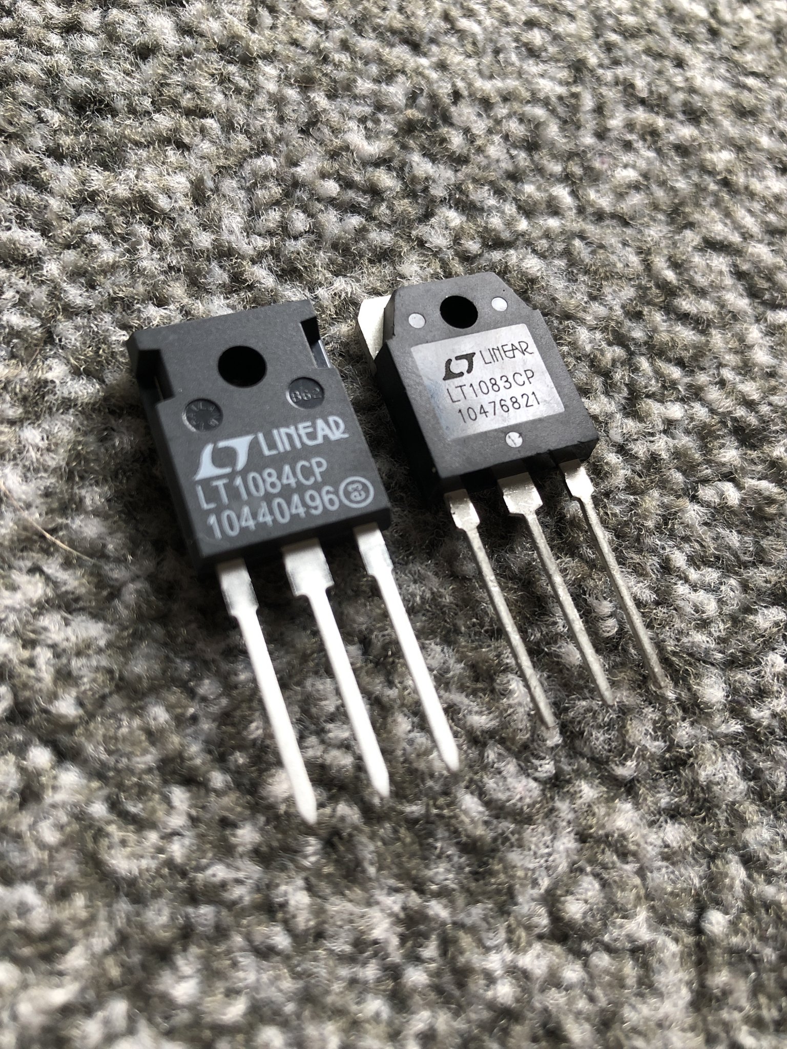

On the picture in post 38 one of the most copied regulators in China. Are they real, are they fake? They do regulate.
