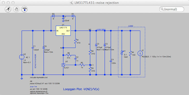

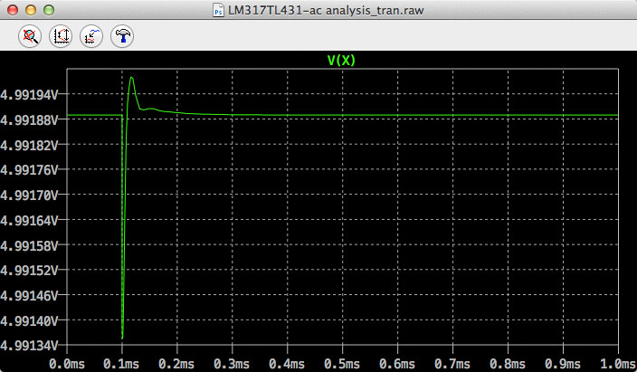

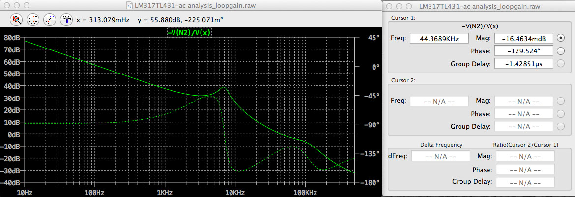

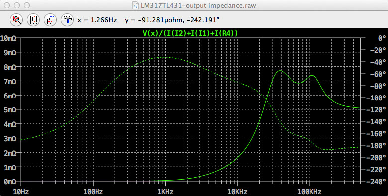

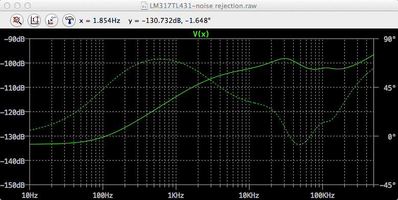

I finally finished all the modelling for the LM317+TL431 (actual circuit to use SPX431). Below is the circuit, loop gain and phase margin analysis, transient response, noise rejection and output impedance output from the model.
LTspice files and charts:
https://dl.dropboxusercontent.com/u/70685392/Electronics/LM317TL431 latest/LM317TL431-stability.zip

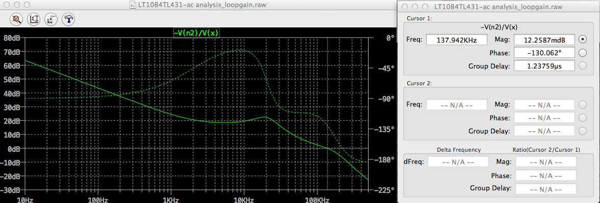

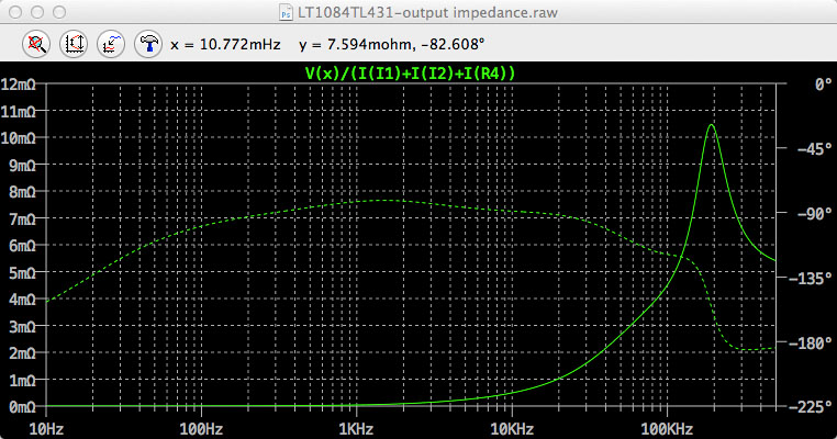

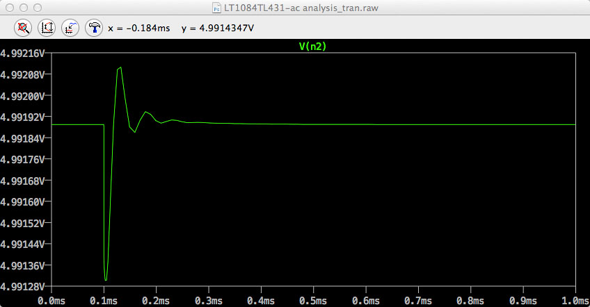

I also looked at replacing the LM317 with a LT1084.
I examined the impact of changes to R5, R6 and C2 on loop gain and phase margin, transient response and noise rejection.
An increase in R5:
- improves phase margin, worsens PSRR, worsens transient response
An increase in R6:
- worsens phase margin, worsens PSRR, improves transient response
An increase in C2:
- marginally improves phase margin, worsens PSRR, improves transient response
Phase margin is very sensitive to R5 and R6. Transient response is more sensitive to C2.
I finally settled on leaving R5 the same and optimising each of R6 and C2.

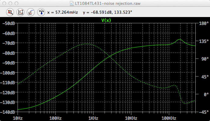

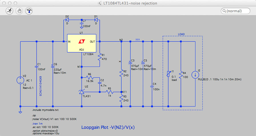

LTspice models and charts
https://dl.dropboxusercontent.com/u.../LT1084TL431 latest/LT1084TL431-stability.zip
An increase in R5:
An increase in R6:
An increase in C2:
