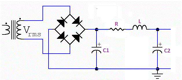

It depends how far you want to go...how small you want the ripple to be.
Here's a LCR solution (an inductor is your friend) although it might be overkill and more costly.
Example values for 60Hz mains:
C1 = C2 = 4700uF
R = 7.5 ohms, L = 10mH
I estimate a ripple rejection of about 40dB at 500mA.
You have to make sure there is enough voltage across C2 for the 18V regulator...maybe allow 5V. And then there will be a drop across R, say 4V in the example. So you need at least 27V across C1. A 22Vac transformer would do. Make R >3W for margin...it will get hot at 500mA continuous current.
Mind you, an LM317 is specified to have 64dB of 120Hz rejection with a 10uF Adj cap. so you might end up with overkill rejection at 120Hz. However, the ripple isn't pure 120Hz and contains a lot of HF hash. The LCR would definitely crush this.

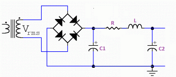

C1 = C2 = 4700uF
