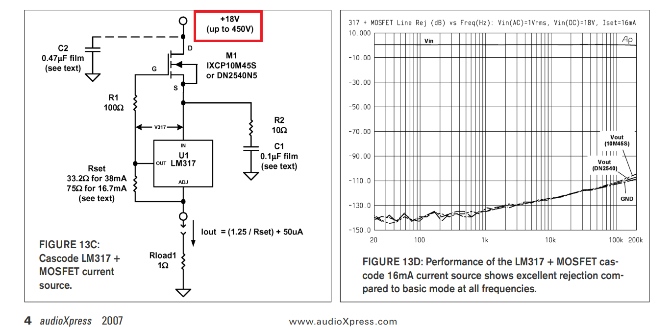

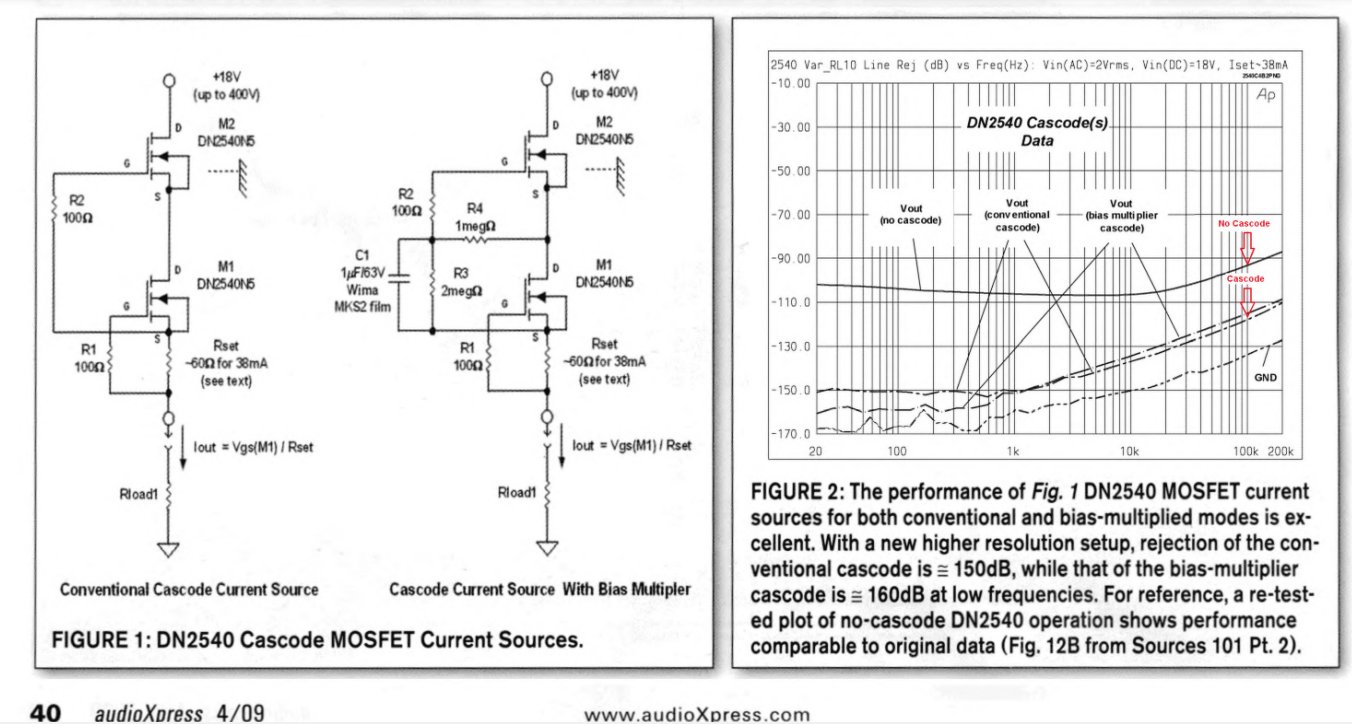

The above circuit has a problem with self-generated noise at higher voltages. Walt Jung explained this in this PDF and I can confirm it from my own tests.
https://refsnregs.waltjung.org/ax_High_Perf_Current_Regs_Revisited_0409_052921.pdf
Absolutely correct.
But the title of the thread is about LM317 configured as a current source for high voltage.
Not how to make a CCS for HV with the lowest noise.
In the latter case, one can simply replace the LM317 by a suitably low noise depletion MOSFET or JFET.
LU1014 in triode cell comes to mind, other than DN2540, BS129, etc.
Patrick
Patrick

Depends on what dynamic impedance you want to aim at.
All described in the Jung articles.
Patrick
Patrick

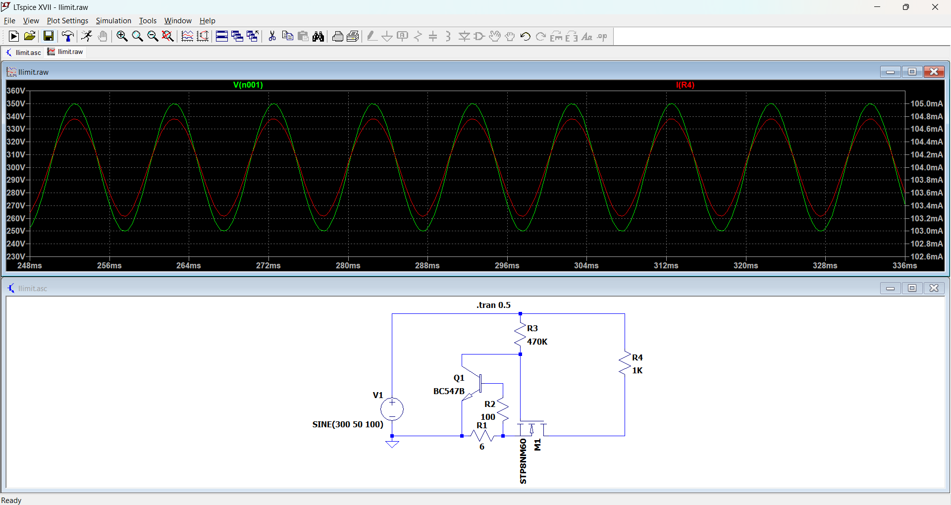

Limiter means a safety feature, thus neglecting other aspects like output impédance, noise bandwidth, etc.
The (crude) circuits I proposed fit the bill, as would other options. Complicated and elaborate optons may have better properties, but they come at a cost.
Basic principle is KISS. If you add useless features, that's your problem and responsability......
