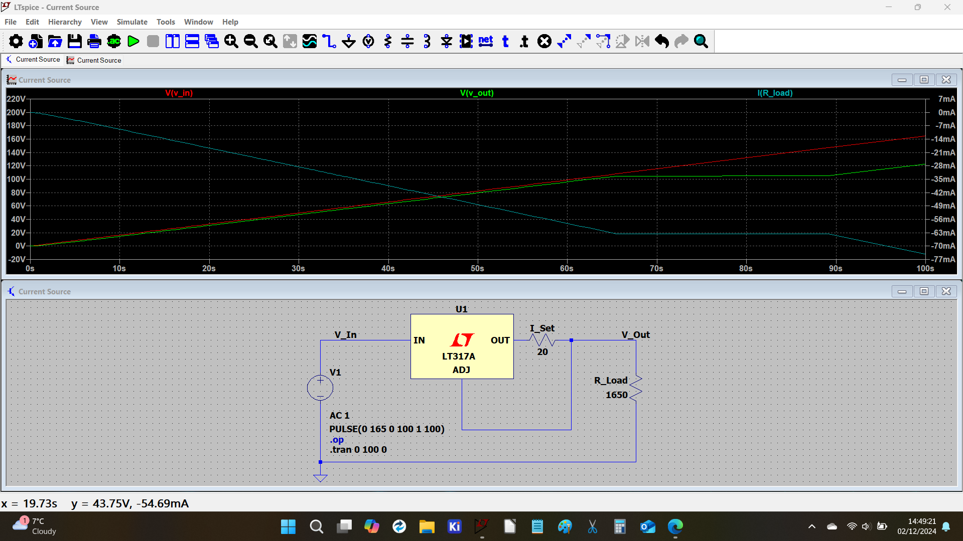

It seems just protection if you are prepared to use a fuse, hence providing heat-sinking to the pass transistor of #44 above is all that you seem to need. You may be getting into instability problems with the LM317 as causing this device not to function predictably.

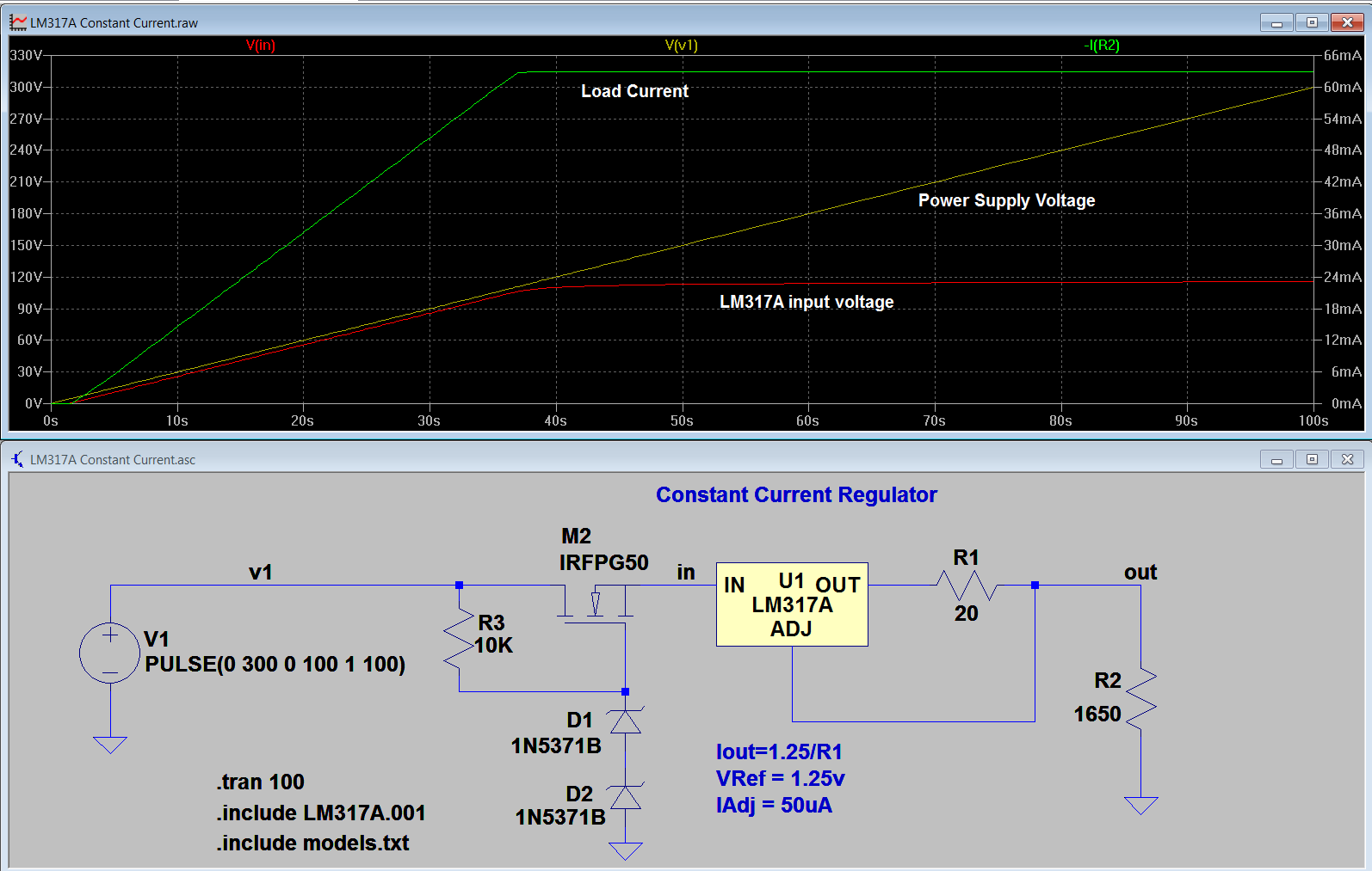

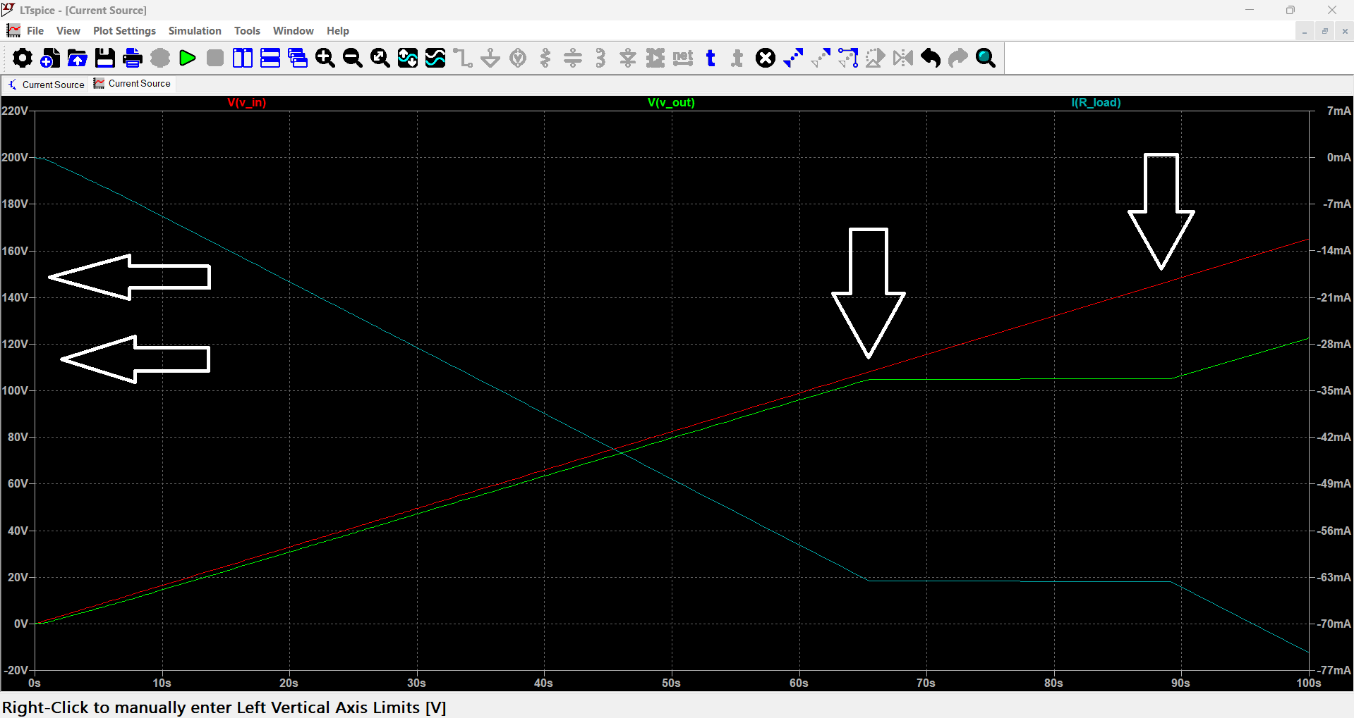

I was looking for a current limiter (say 100 mA), regardless of the applied voltage (above a certain value of course). The intended range would be from 150 to 400 Volt.

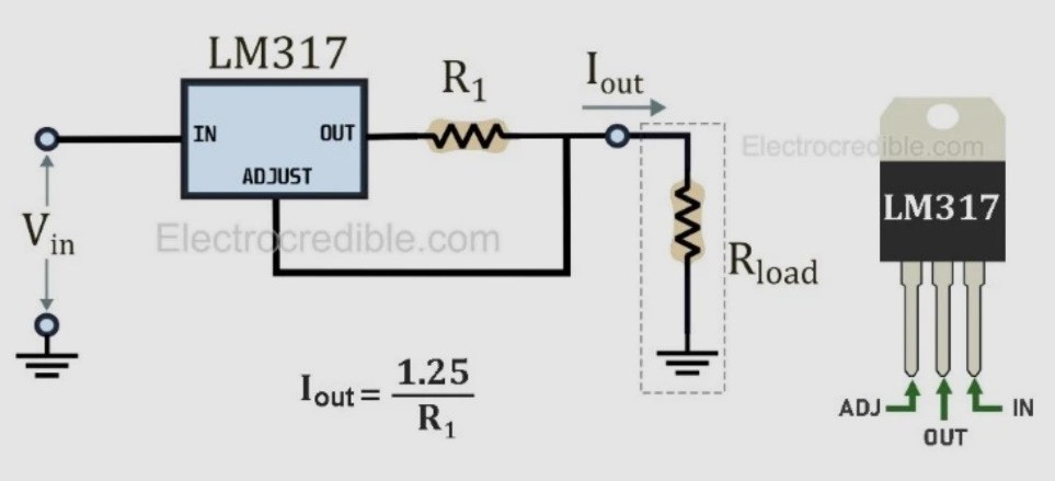

It isn’t a current limiter. It is a current regulator, or constant-current source. Not the same thing.It would be to limit the max. current, be it 10, 50 or 100 mA, regardless of the voltage.

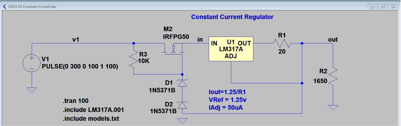

This will work, provided the MOS has a decent linear SOA:
You can always reverse the polarity of the semi's, or rearrange the elements like this for example:
To remain on the safe side, the usual additional protection zener is advisable:
