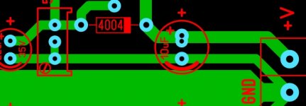

Why don't you ELABORATE MORE as to what I'm supposed to with the ground of the trimmer, instead of asking me if I can do the same with it as I did the output terminal?
I routed it's ground to the ground pad of the output cap as someone suggested. What's wrong with it now?
That looks good. Better than any I have seen anywhere on any previous PCB.
Can you be as thorough with the other sense tapping?

The Fig 3 is nice and clear. It also identifies that any preceeding CLCL filter components can do what they want, but the final C3 negative terminal should be the connection point going to the regulator section output negative point.
The regulator output negative point is typically best made at an output bypass filter cap (eg. the 10uF filter cap). The aim is then to connect the amplifier load also to that output bypass filter cap negative terminal (for 317 circuit). If that bypass cap was ideal then load current would only flow in to and out of that cap, and similarly power supply current would also only flow in to and out of that cap. The post #67 layout generally does that appropriately.
My earlier comment on connecting the reg adj circuit 'out the back' of the 317 pads was to make the 317 output pad a kelvin connection point. As such, the 240 ohm resistor would connect to the 4004 trace on the other side of the 317, rather than connect to the trace going to the output cap and load.
Yes it does. Thanks for the link.
From what I interpret in fig. 3, the ground from the trimmer should connect to the center plane as close to the load(or terminal block in this case?) as possible.
Someone in an earlier post suggested moving the 10uF caps close to the heatsinks.
If the trimmer's ground connects to the output caps' ground pad, moving the caps back toward the heatsinks seems counterintuitive to what the L.T. datasheet suggests.
So where is the best location for the 10uF caps?
Is it any better to connect the -sense point and output cap's gnd. to the terminal block's ground like shown below?

True, but it's worthwhile appreciating what is at the best end of the scale, and what is practically done, and why there is likely no difference for your application.
For example, a designer could want seperate PT winding, rectifier, filter, regulator for each supply rail for each amp section. Practical decisions are made normally, sometimes by bean counters in a company, sometimes by the designer appreciating that any benefit is negligible for that application.
Trobbins, you're right. Just another example of "potentially there's always room for improvement" with almost anything.
Thank you and the others here for their contribution fine tuning my layout.
Think I'm going to get some Gerbers off to one of the Chinese board houses when they're done celebrating their Chinese New Year.

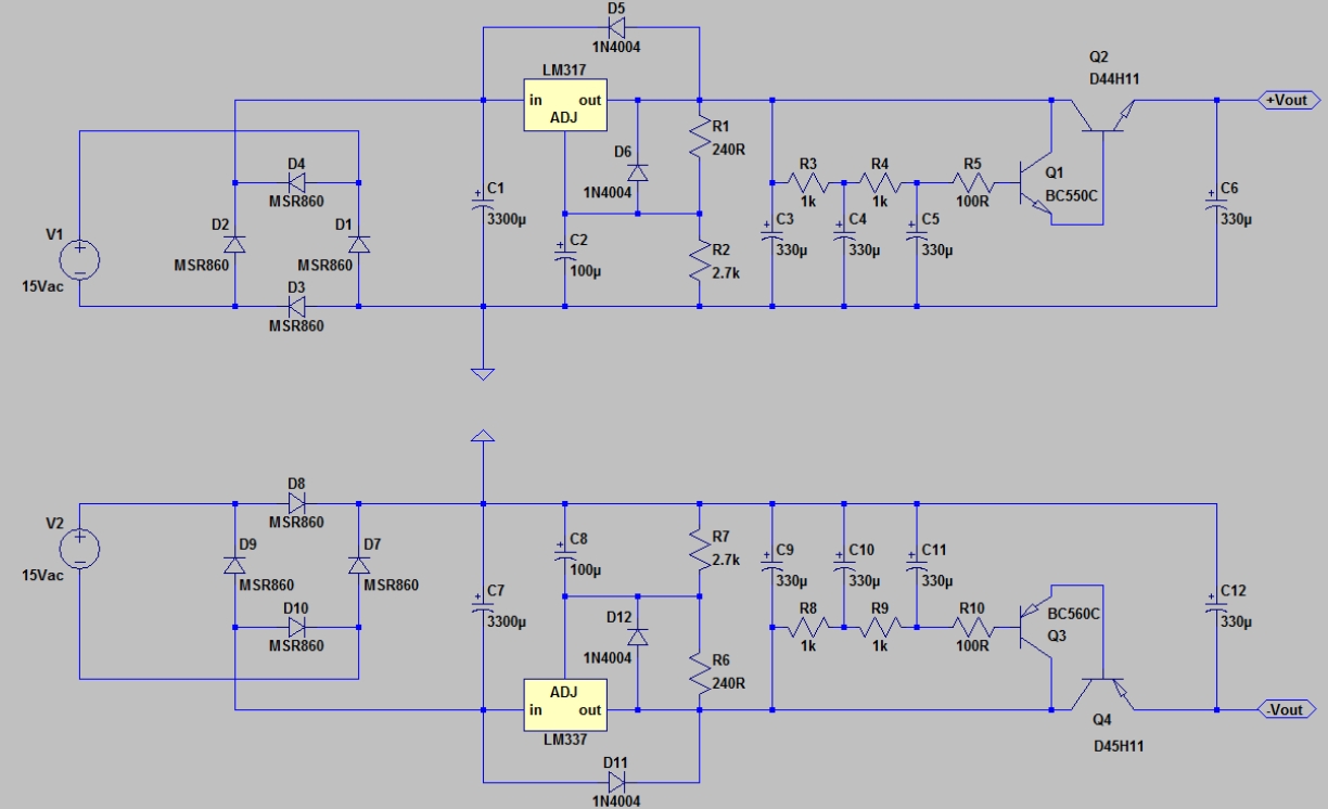

I found the circuit over in one of the headphone forums. The F5 headphone amp thread I believe.
Rumor was it's a circuit John Curl design and used in a Parasound product. I asked him about it and he stated he had never seen the circuit before.
So output impedance is going to be too high?
At very low frequencies approximately 2 kT/(q Iout) + 2100 ohm/(hfe1 hfe2) ~= 52 mV/Iout + 2100 ohm/(hfe1 hfe2) for each output rail. At higher frequencies, first the 2100 ohm/(hfe1 hfe2) term disappears and then the output capacitors kick in.
Whether this is too high or perfectly acceptable depends on the application.
I guess the circuit is meant to filter off the noise of the LM317/LM337. Depending on load current, it could help to add extra resistors to bias the BC550C and BC560C at more predictable currents.
