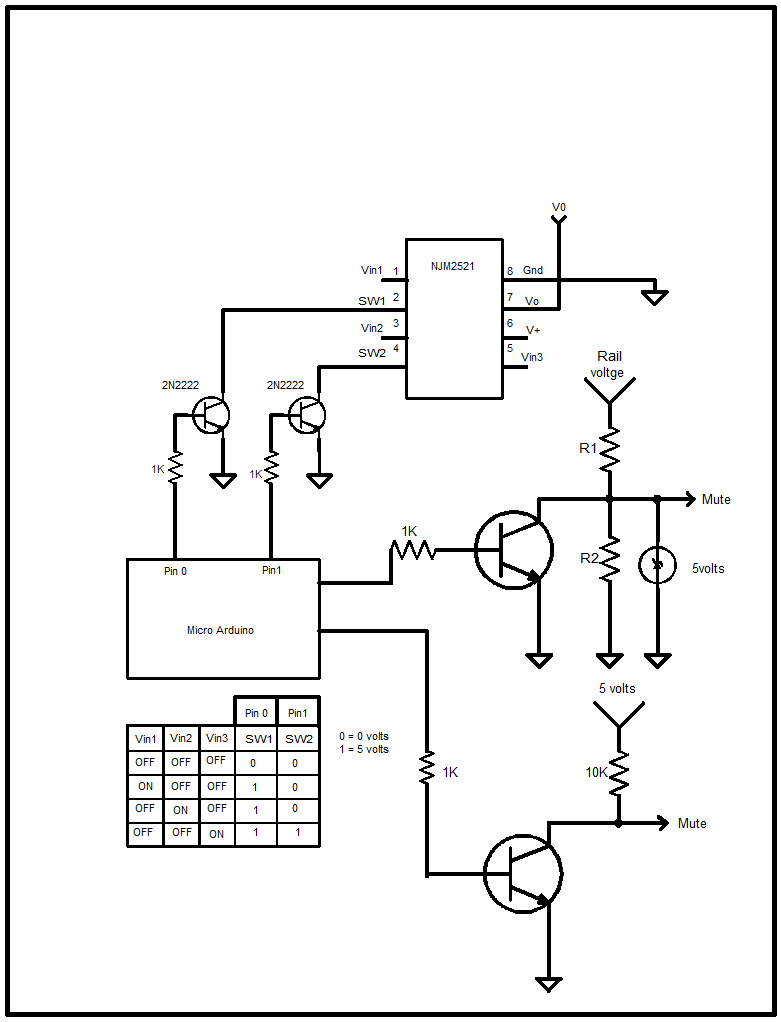

i was thinking that leaving the other inputs of the NJM2521 empty, i could switch between my input signal and "nothing" - thus muting the channel. does that make sense?
i might need to clarify the project a little further.
this PCB is a part of a musical instrument, where each channel is one note, controlled by a keyboard. there will be 12 stereo amp chips, giving me 24 notes to play with.
thats why i need to be able to turn the channels on/off very rapidly, through a digital interface (the arduino)!

I added 2 way to enable/disable the mute depending what voltage you use. One it is doing it using a voltage divider from the rail voltage to provide 5 volts or the second if you provide only the 5volts.

do you think i will need the mute function of the LM1876 if the input is already silent? im not worried about power consumption...

I do not think so because the "thump" come from the rails voltage coming down. If one dropped faster than the other this will unbalance the output drivers and consequently generating the "thump". This is my opinion that cause the "thump". Still you can ground the input too you do not loose anything. The mute in my LM3886 worked perfectly. You do not heard anything in the speaker.

As far as the PCB is concerned, I think that leaving some of the inputs of the NJM2521 'empty' will work, but I would put a small value resistor (100R) to ground, rather than leaving them 'floating' as this might result in unwanted noise. I also think that the NJM2521 is probably not the best way to spend your money. I found some on ebay, but they cost ~U$5. I think we could find a better, smaller, cheaper solution.

hmmm.... wondering if i wanted the arduino pin HIGH signal to unmute the audio, wouldn't it make sense to connect the audio input signal to pin 3 of the NJM2521, rather than pin1?
that way an arduino LOW signal would mute the inpute, HIGH would let it flow through... amirite?
I think your concern it is valid but remember the first thing you should do when you initialize the micro it is immediately set the I/O pins outputs to their start up conditions.
i got the chips from fedex today - for some reason this setup is NOT WORKING
any thoughts on what i might be doing wrong?
I didn't read back through the thread, so sorry if I missed something. But looking at your drawing, I see you are using input #2. And the logic for selecting input 2 involves SW1 being logic HI and SW2 being logic LOW. Your drawing shows no connection at all to SW2. Connect SW2 to ground, and then bringing SW1 hi with your module ought to select input 2 to the output.
