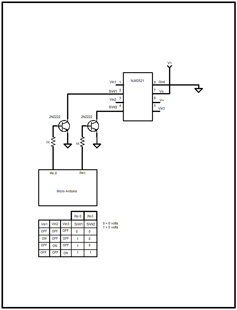

i was thinking that leaving the other inputs of the NJM2521 empty, i could switch between my input signal and "nothing" - thus muting the channel. does that make sense?

As far as the PCB is concerned, I think that leaving some of the inputs of the NJM2521 'empty' will work, but I would put a small value resistor (100R) to ground, rather than leaving them 'floating' as this might result in unwanted noise. I also think that the NJM2521 is probably not the best way to spend your money. I found some on ebay, but they cost ~U$5. I think we could find a better, smaller, cheaper solution.

good call on adding resistors to the empty inputs of the NJM2521. i will definitely add them to the PCB.

hmmm.... wondering if i wanted the arduino pin HIGH signal to unmute the audio, wouldn't it make sense to connect the audio input signal to pin 3 of the NJM2521, rather than pin1?
that way an arduino LOW signal would mute the inpute, HIGH would let it flow through... amirite?
I didn't read back through the thread, so sorry if I missed something. But looking at your drawing, I see you are using input #2. And the logic for selecting input 2 involves SW1 being logic HI and SW2 being logic LOW. Your drawing shows no connection at all to SW2. Connect SW2 to ground, and then bringing SW1 hi with your module ought to select input 2 to the output.
