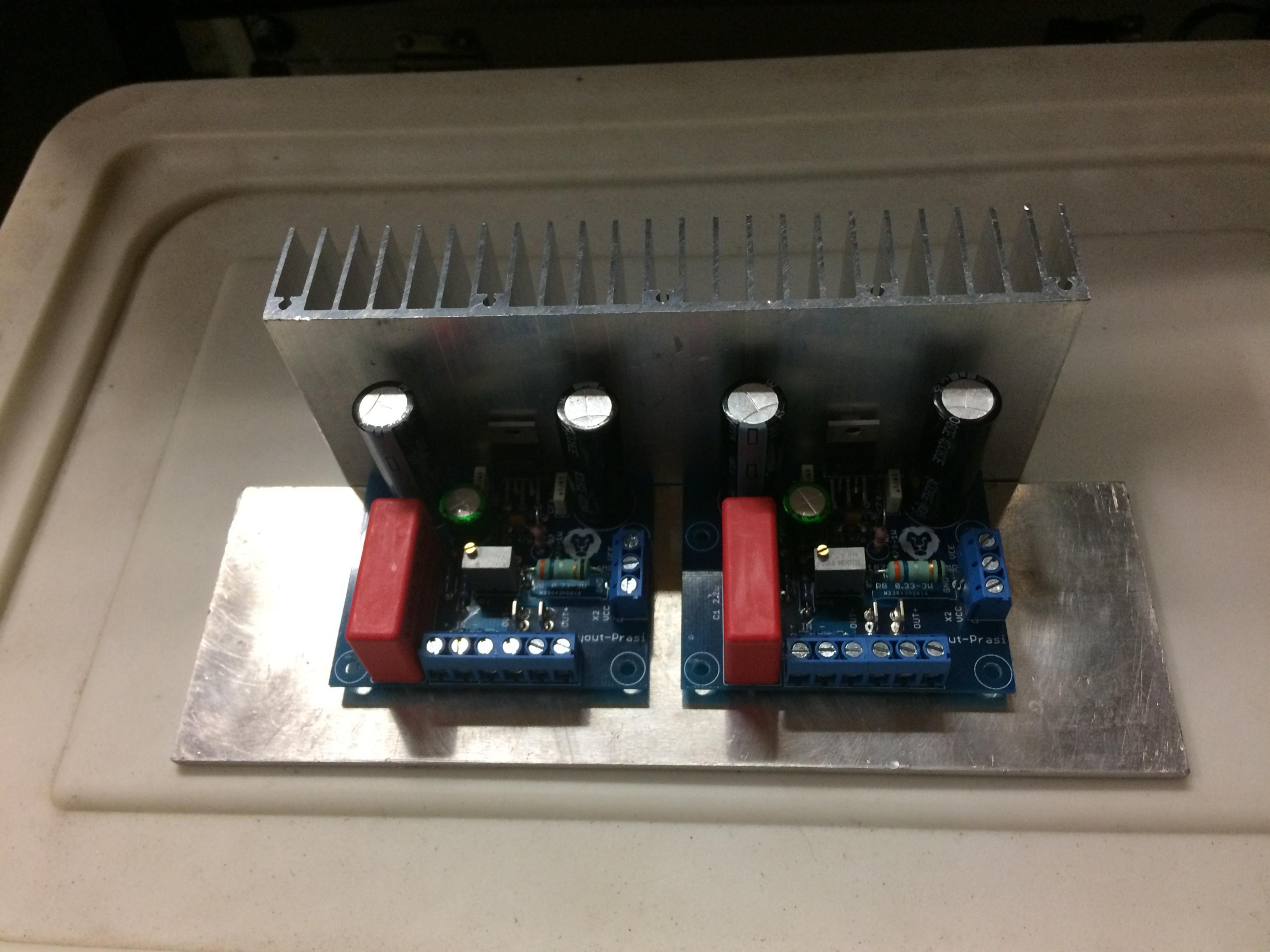

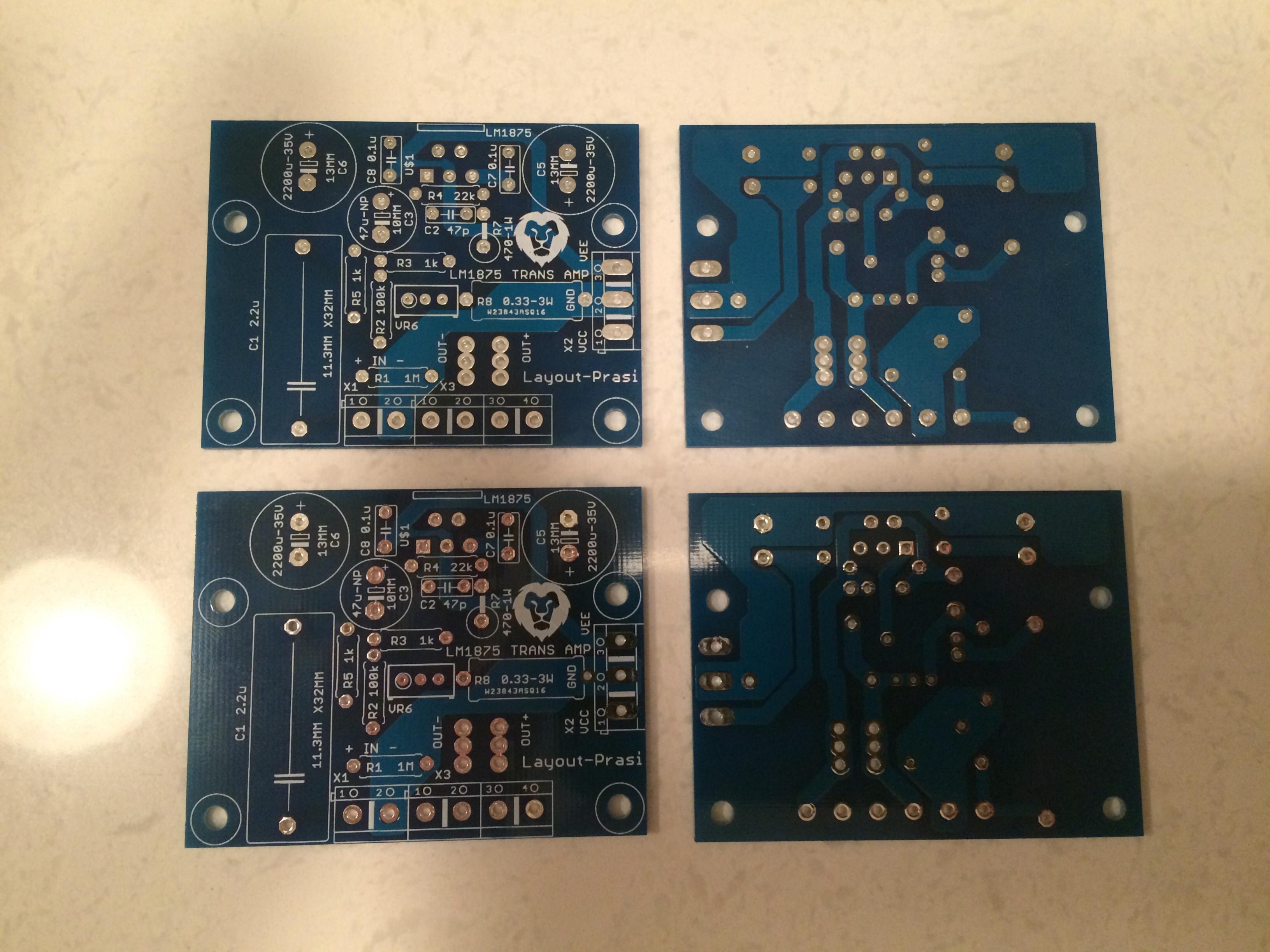

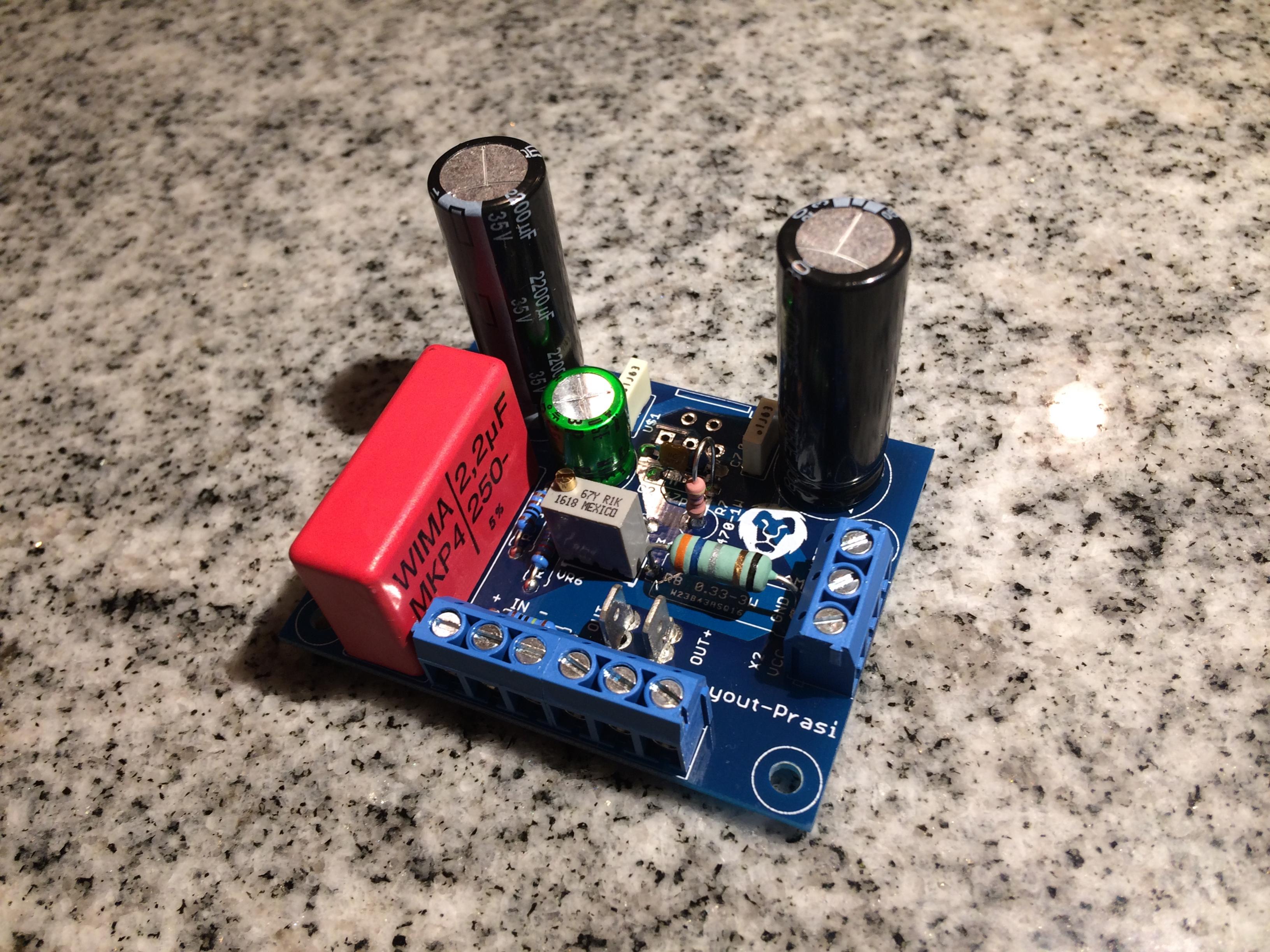

Revisiting an old thread since I always wanted to try a transconductance amp. since I have full range speakers and the article from NP convinced me to one day give it a try.
Thanks to the good as built schematic of Bimbla and the great help from Prasi a PCB layout has been created. I will try to fire it up very soon and will keep you posted.
I attached some pics of the empty and stuffed PCB (need to find my LM1875
Once tested I'll have some PCB to sell at cost + shipping (cheap)
BR
Eric

Hi guys
The PCB is working but I've got a noisy smps powering the amp. Let me try with a linear supply. I then have to build a sealed enclosure for the full range speakers. Lots on my plate lately. If really interested, I can send some pcb (free), just pay shipping.
Eric
