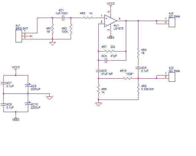

Simple V-I Amp
can you share your schematic ?
Sorry kp93300 as I was away from the forums.
Try the circuit below, It is tested by me and is the simple version of what I had originally built. A non-polar 47uF cap replaces the DC Servo to make things simple.
1. Adjust 4R15 per your personal taste.
2. 4R9 controls the gain of the circuit
3. 4C5 controls the bass response with 4R6 and needs to be bi-polar.
All the best!

kp,
I acknowledge that I was inspired by Esa and padamiecki to jump into current amplifiers. I also acknowledge that the topology of the above circuit is from Introduction: Greetings and introduction and is not my original work. Do visit the website and enjoy a big sea full of wonderful information which is present there.
So with the credits taken care of, the 4R15 can be looked upon as a control that let's you change from voltage amplifier to a current amplifier. The value can be anything from 0E (short) to 1K. 0E makes it a 'pure' current amplifier.
Give LM1876 a try. It has better protection and has Mute and Stand-by pins to take care of turn-on/off noises.

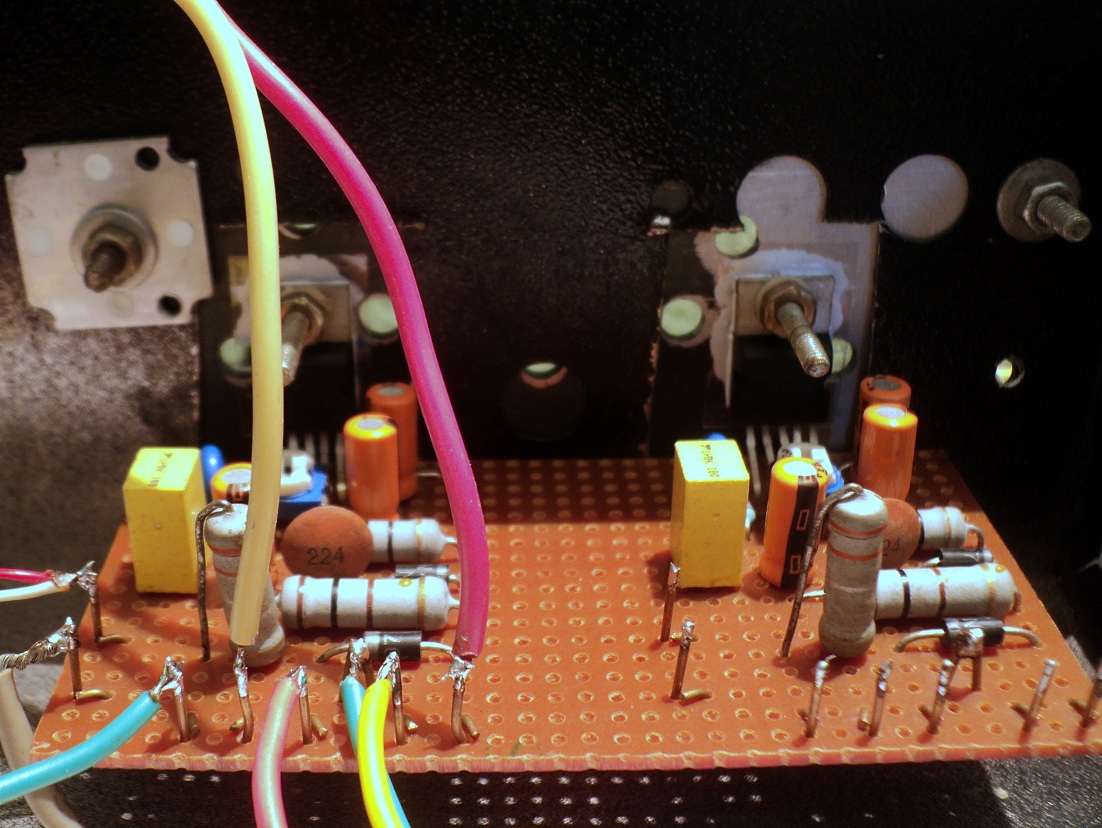

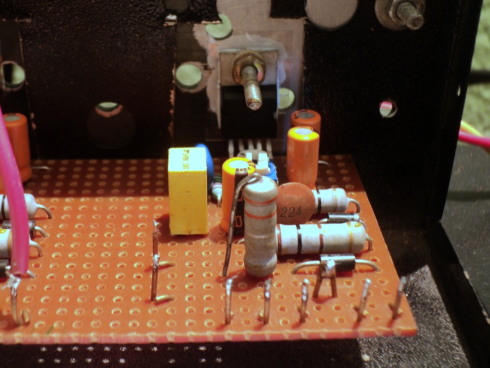

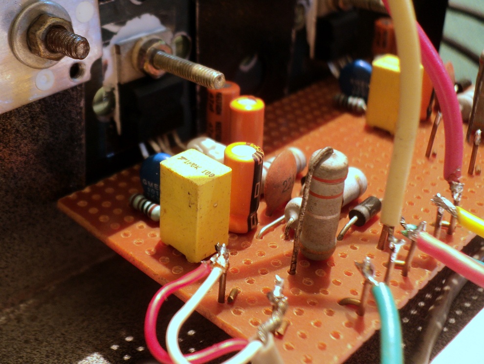

Hi guys!
I got too excited and ended up in a mess. It's your fault that my speaker is now having a multiple personality disorder (or maybe just showed its real self, dunno). 😀
I used the TDA2030 puny opamp and built the thing with parts right from junkbox and now vocals are throwing bolts at me!!! I mean, I am shocked. My cheap-a$$ fullranges seem like having a full-body mutation. I'm not sure whether I like or hate the sound but clearly it's wayyyyyy different from that with my other amps! Naturally my drivers are not built for current drive and probably have poor efficiency, but the vocals... the vocals seem wow! That said, there are obvious peaks and dips here and there. Looks like an 8 or 10 band eq is on its way.
Anyways, I think I will give the two channels a good long listen for the next few days, need to get over the confusion.
And thanks everyone here, I love surprises. ^^

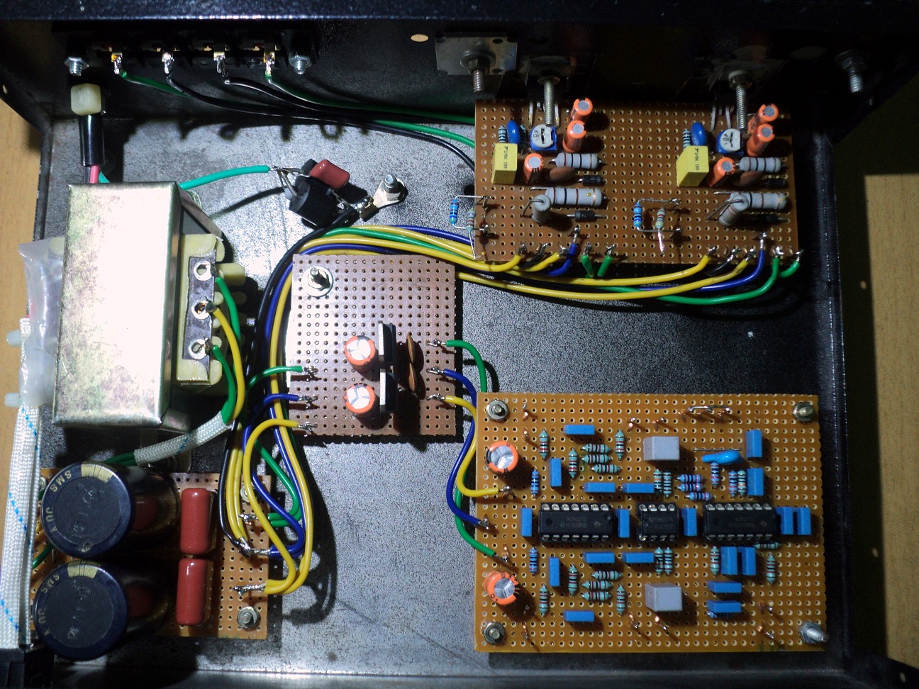

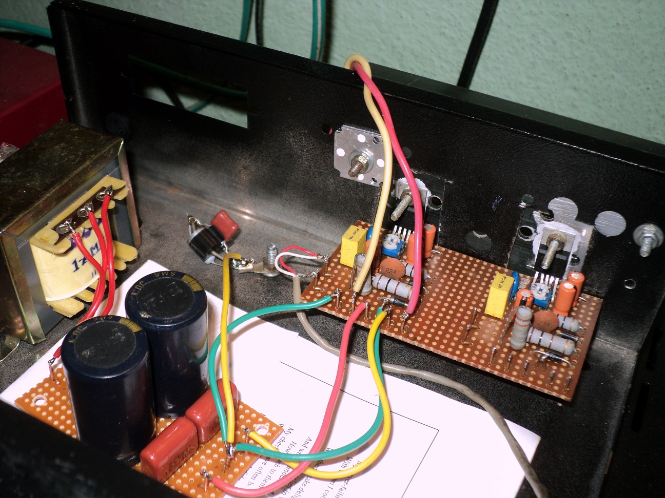

In post # 46, is it enough to build the circuit as it is? or should there be a decoupling caps on board for the LM 1875s. Alternatively, if the power supply section is built on the same board, can we completely eliminate the decoupling caps?

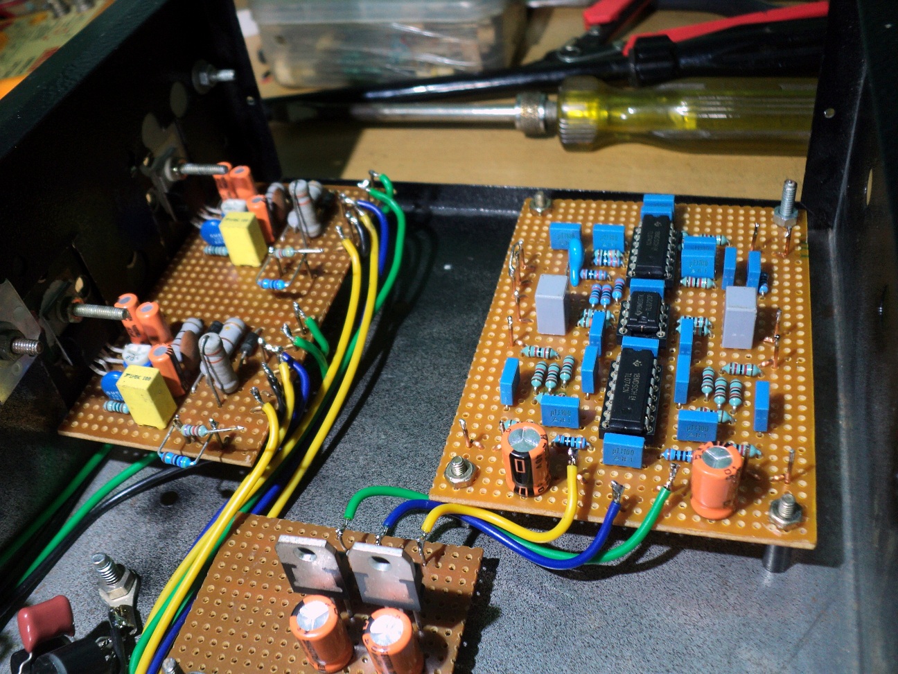

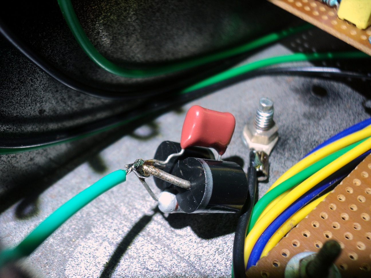

trying to integrate the amps with my 2.1 x-over. the filter will have dedicated in/out sockets. the high pass out will be connected to the chipamp via a dpdt switch. offset at the speaker terminals is -1.8V when floating, and -80mV when speakers are connected.
