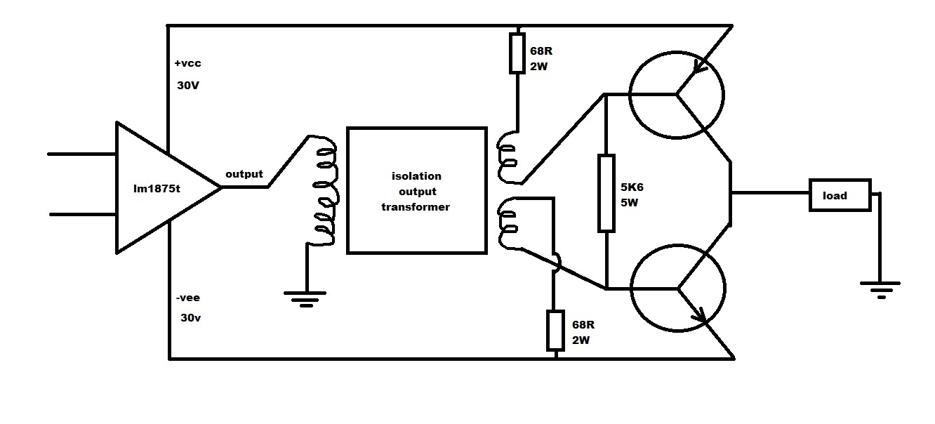

Okay, I have it working fairly well now, used 68R2W resistors from the rails to the leading ends of the 2 secondaries on my output transformer, and a 5.6k 5W resistor between the 2 base pin connections at the other ends of those secondaries. There is a bit of overlap and perhaps the quiescent current is still a bit high but the sound is full and good all the way to zero volume, which at that point there is a very slight hum. I can still play with the circuit a bit but at this point I will say I am quite satisfied with the outcome thus far. Just a couple tweaks away from the build I have been striving for with the parts I have up to my ears. Output at speaker is 102 watts RMS (clipping) using a single pair of output transistors.

Paint a picture , how your transistors and transformers are connected. Biasing methods are diferent if using common emitter and emiter follower configuration. I measure power the same way, but need to look with oscilloscope,to ensure no clipping occurs yet, and then measure ac voltage at output. Better use lower frequency , not all voltmetters and dmm measures ac voltage accurately ,if frequency is more than 1khz. Clipped power output has no practical reason, you will not like that distorted output and not listed at that level.

Why would the impedance on the primary side get below 4ohms? You are just driving a pair of emitter followers, right? It is perhaps closer to 4k than to 4R.
Ok, i see now you are using common emitter configuration.You can add small resistance to emitters, like 0.1 or 0.33 Ohms, they will stabilyze bias current a little ,also providing some local feedback, increasing linearity. Also what i see ,is high resistance 68ohms with transformer windings, you should add capacitor 1000uf in parallel each 68ohms. This would pass all output from transformer to transistors bases.

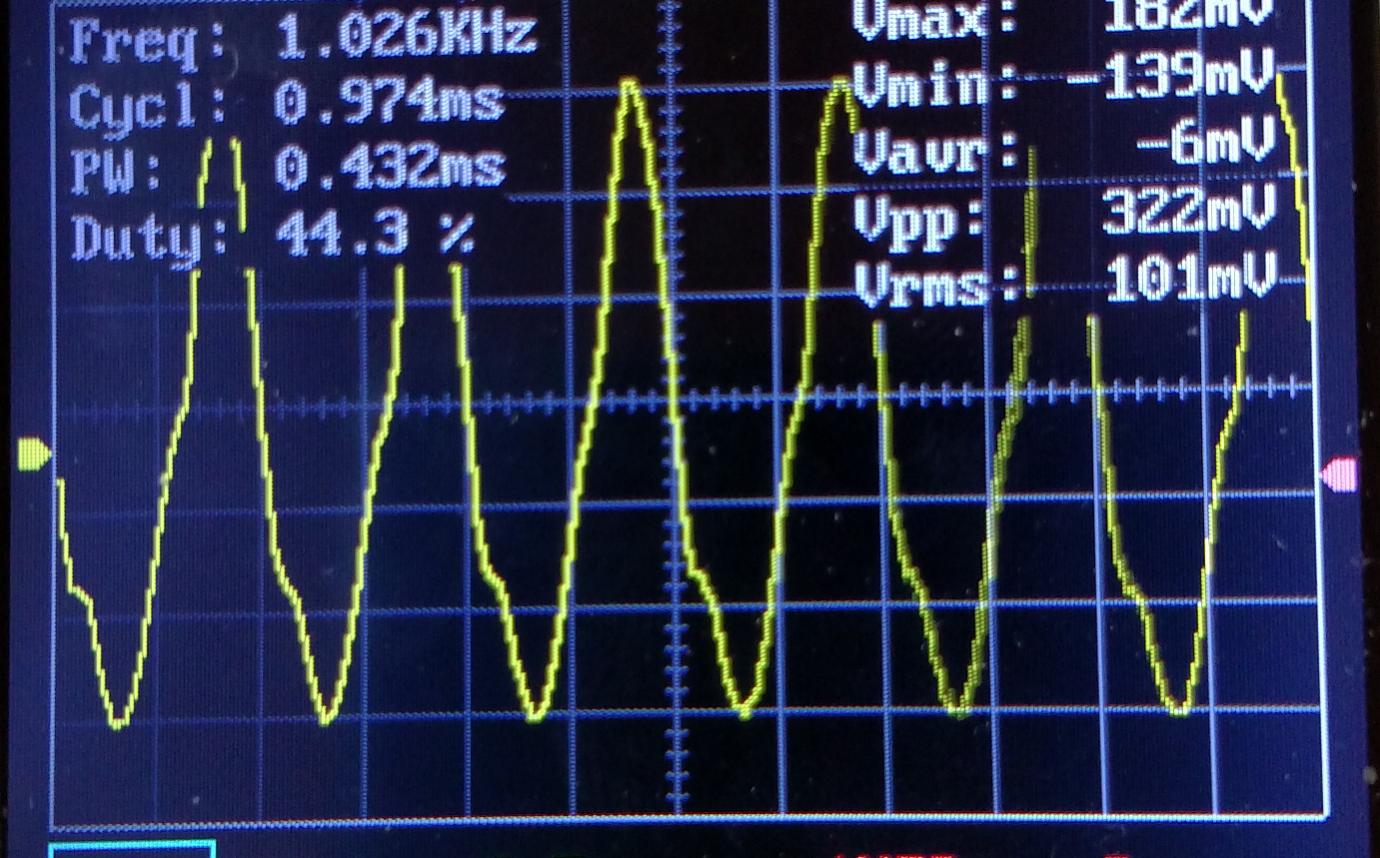

One sided crossover distortion
After mounting up all my parts and soldering everything up how I like it, I got my scope and started doing some checking and noticed crossover distortion on only one side of the sine wave. The 82 ohm resistors ( I changed from 68 to 82) are .2 ohms difference and the coil windings themselves slightly differ in impedance. The resistor between the two base pins is now at 9.1K instead of 5.6K and the slight buzz at zero volume is gone.
I started trying different low value resistors on the low side with the scope connected until the sine was pure. The overall impedance from one side to the other is different but the sine is clean, and the amp sounds good. The transformer is a 2:1 ratio step down but there are 2 output windings drawing signal from the single input so the power should be about the same, just lower voltage applied to the base of the power transistors. Now that the circuit is complete and I am satisfied, I will add a fan as the heatsinks do get fairly warm. I will post schematics of my exact circuit when I get a chance.

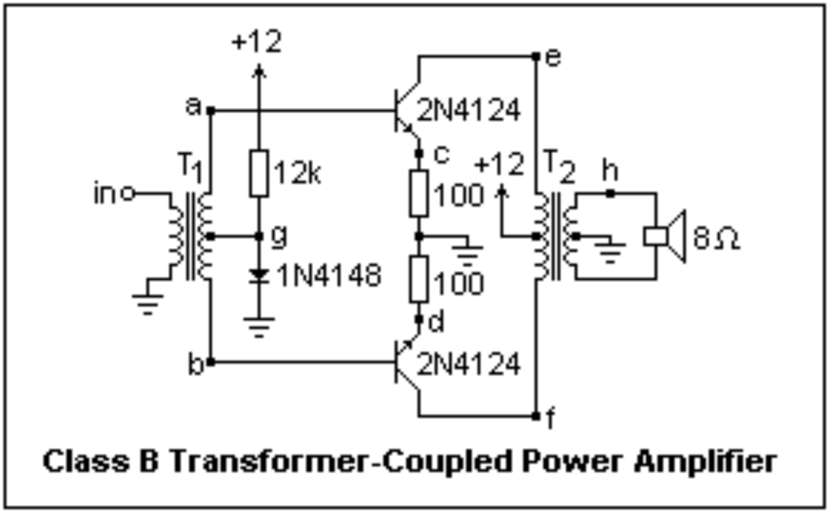

Also found another schematic using a transformer for the input, slightly different topology but interesting nonetheless.

another poster in the forum used a decent coupling transformer and PNP outputs (grounded transformer CT) so that 50w could be had from 12v. A 5w head unit amplifier was the input. 12v 3A torroid speaker across the collectors. Seemed to work rather well.
Once you start throwing driver transformers into the mix - it changes the whole ballgame because now you can get both voltage and current gain out of the added transistor stage. This was very common back in the 70’s, but has fallen out of favor because transformers are expensive compared to chips. A transformer designed for this service cost $20 at Digikey. Making your own certainly saves some bucks - and now you’ve sort of got a vintage design. Emitter degeneration and bias tracking diodes can (and should) be added but you’ll figure that out after it sits there and runs away 🙂. The old vintage designs used same sex transistors but the general principle is exactly the same.

I used resistors for biasing to cancel the crossover distortion as diodes had no effect. I am guessing that since there is 60 volts across the diode being fully blocked there is no voltage at all allowed to flow in either direction.

As drawn you can’t just stick diodes in the base circuit, no. Because of the reverse bias issue. But if you arrange the bias network as a voltage divider from rail to rail you can. Diode, resistor, diode. Then connect the transformer secondaries between the bias tap points and the base. This is the more traditional arrangement from the old 1970’s circuits. You may need to adjust the turns ratio or add a few ohms in series with each diode but that’s easy.
You will never completely get rid of crossover distortion with this circuit. When you get rid of the crossover artifacts with sufficient bias, you will get gm doubling through the region where both transistors are active. So you’re back to having a form of crossover distortion. It is a non issue with emitter followers, but with common emitter it is real. If the entire stage is inside the global feedback loop it becomes negligible. Any time you add gain inside an amp’s feedback loop, the minimum gain for stability goes up so you have to watch that.

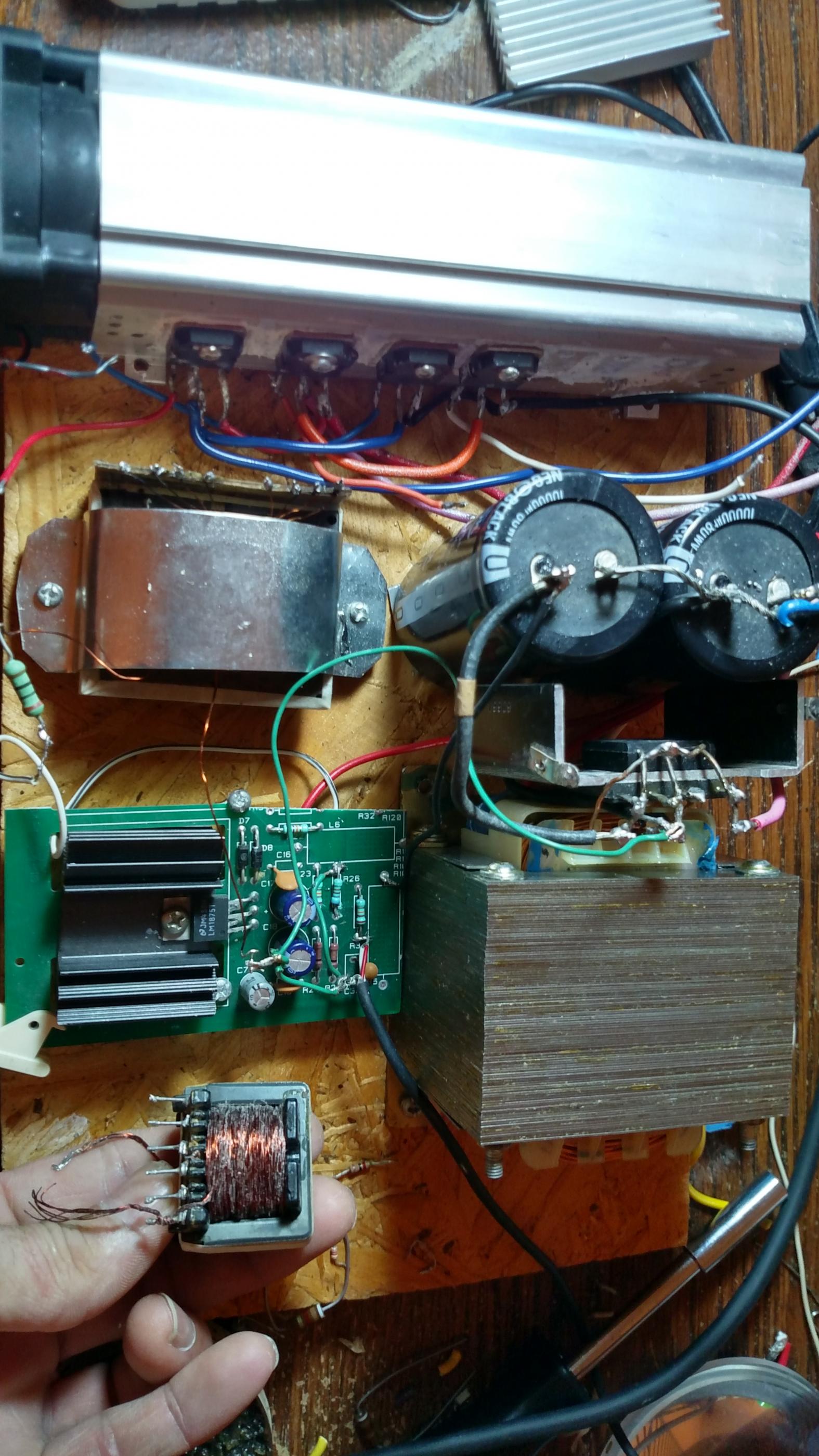

Really like the amp I got out of this venture but had to reach for more with a bridge mode using 4 output transistors from a single lm1875 and output transformer. As the other stage on the BJT's is wired with opposing polarity, I noticed that the sine on the input was becoming extremely distorted with artifacts when the second stage was connected. (From output windings to the opposing BJT's.) Someone mentioned crosstalk and it seems that some opposing signal is being imposed on each of the opposing output stages through the audio transformer. I decided to use separate transformers for the 2 opposing stages of BJT pairs to see if the issue would be resolved. Originally thought my transformer was too big so I wound up a smaller ferrite cored transformer and the sine was perfect until power was applied to the output BJT's.
I have attatched a pic of the test board with the smaller audio transformer in my hand that I was hoping would resolve the issue, but did not. I now have 2 identical audio transformers ready to drive the 2 opposing stages to see if this does the trick.
