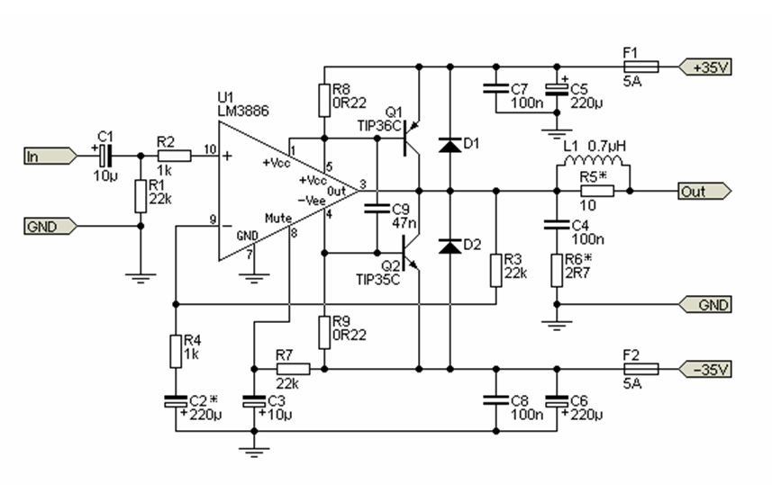

I have found many circuits using power transistors to boost the output of a chipamp, and have noted some impressive results here using the TDA7294 and lm3886, but there are many schematics with quite different layouts for the TDA20xx and LM1875T. I have quite a few of these chips and several types of power transistors on hand but have yet to successfully build a circuit that truly raises the output power to any remarkable level. I have
18-0-18 125VA on my psu netting 22-0-22, the load is 8 ohms speaker.
I have assembled the attached schematic and several other similar circuits using 0R33 5 watt resistors instead of the 0R22. and LM1875 instead of LM3886. The transistors do not boost at all even with full volume at the input. I will try other resistors, and have had thoughts on using 2 separate tfo's to alter the setup a bit and utilize the higher voltage of the output stage while keeping the op-amp at whatever voltage it is happiest.

R8 and R9 need to have a higher value as they decide when Q1 and Q2 become active. Try with 1R. With 1R, Q1 and Q2 are activated around 650mA.

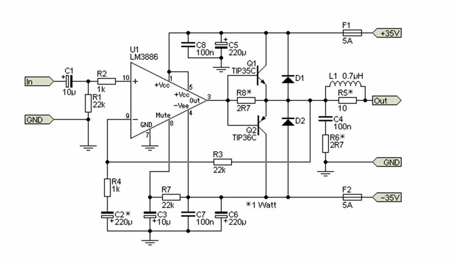

I tried the bridge configuration with 4 transistors, nothing but loud buzz through the speaker. op-amp alone sounds clean, and have seen up to 8 volts ac at the speaker with my multimeter. I swapped in some 3ohm resistors for R8 and R9 with no improvement, chip started getting warm. I am thinking this circuit may be a better approach...
This version with emitter outputs is easier to control than the first version with collector outputs. You may add some 0R22-0R33 emitter resistors if you want less cross-over distortion. For R8, I would use 1R in order to move the activation points further away and let the LM3886 handle delicate passages with low sound level on its own.
Was it Q1 and Q2 that became hot in the first configuration or was it the LM3886? 3R probably resulted in too high idle current through Q1 and Q2.

No it would not the distortion would be awful no bias in the outputs. The overall gain doesn’t change and you gain nothing. Bridge two chips is much better. If you are using external transistors just build a transistor amp.

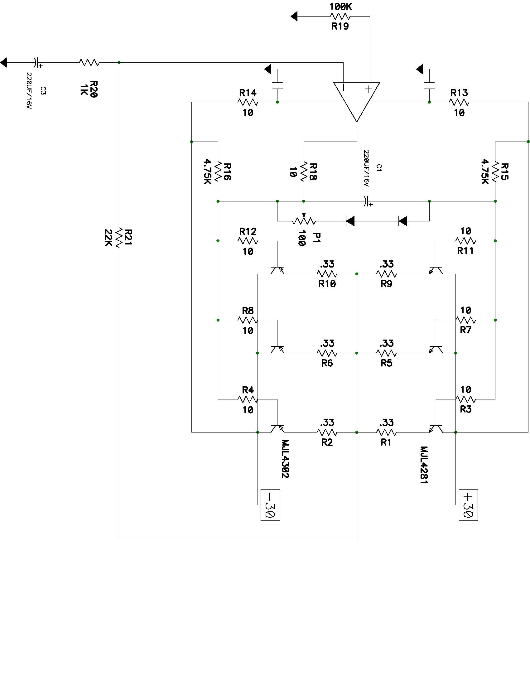

LM1875 Based Simple Amplifier | Full Project Available
Just tried recent schematic with a few variations of R8, but performed best with that resistor omitted, though I could hear white noise that stopped as I unplugged transformer and circuit ran for a second from the voltage remaining in capacitors.
Voltage at output of IC was 3-4 volts AC, voltage at speaker was 4-5 volts AC. Minimal gain. Going to try stepping up the gain and more capacitors on the voltage rails close to LM1875 (Not using LM3886 as specified in schematic!)

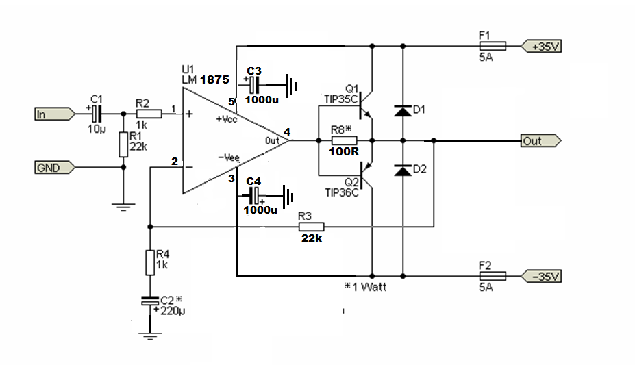

If it is the chip that gets warm it is likely that your chip is oscillating. Neither LM1875 nor LM3886 are very generous with stability. In both your circuits, you can easily disable the power transistors by shorting base to emitter. Then, only the LM1875/LM3886 is active. If the circuit doesn't work well like that there is a general circuit problem and no need to involve the power transistors yet.

So here is what I have so far, white noise eliminated, sounds pretty decent and fairly loud, have not increased gain as of yet.
Q1 and Q2 have no bias on them with the bases shorted together. It will pass signal but is not a good circuit. Look at putting a Vbe multiplier and some emitter resistors if you want external transistors. This circuit also has increased losses so you actually get less ultimate power.
Ok, now I see that contrary to schematic which he should have corrected, he´s actually using +/-22V.
Back to the original problem, he says he´s using an 8 ohm speaker and "adding transistors does not increase power".
Of course, he still has the exact same peak to peak swing as dictated by power supply rails, he has a higher current *capability* which will turn into higher power only if using lower load impedance.

Thanks wayne for your help. I thought there was a notable improvement in the output with the added output stage as shown, but with further checks today it appears that there is no conduction from the output stage. I am new to circuit design and have limited knowledge and experience with circuits and components but I suppose I was hoping to set up this output stage with a common emitter configuration for both voltage and current amplification. Now I am starting to wonder again if the best approach would be to feed higher voltage to the output transistors while limiting the voltage fed to the LM1875. Maybe a voltage regulator IC? or set up a transformer with separate dual rail outputs?
I really thought I had a successful amp running last night, no clue why the output seemed to be increased versus the chip alone. Crazy thing is I even measured the voltages and saw more at the output stage vs the output at #4 pin. No clue what that was all about. Now I am back in the boat just paddling...
