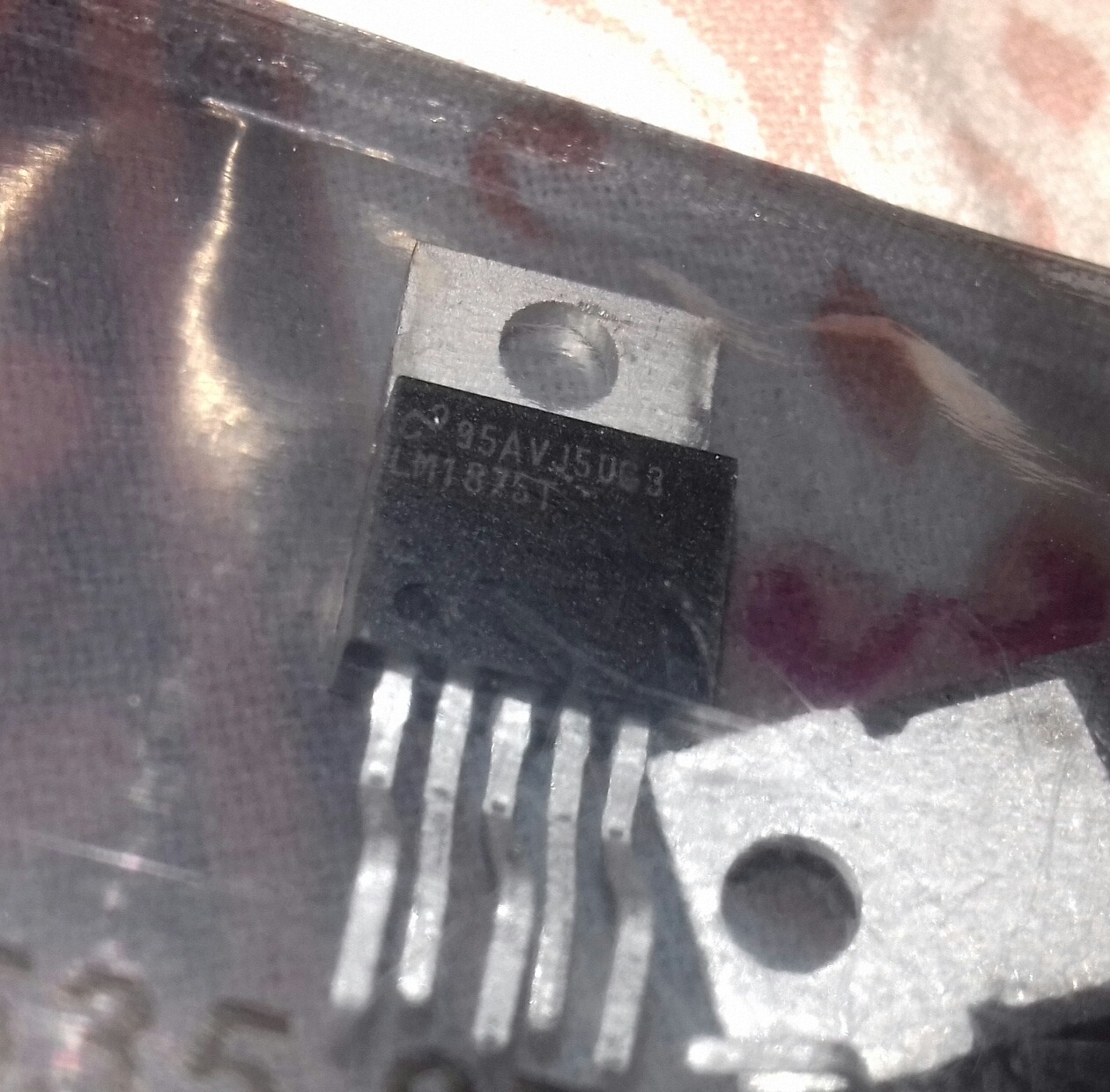

the foot is shiny or not?Original LM1875 looks like this. Nothing changed except printing style(laser engraved).
Best Regards

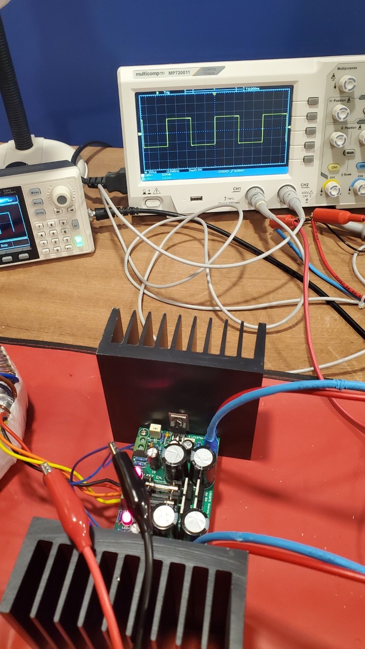

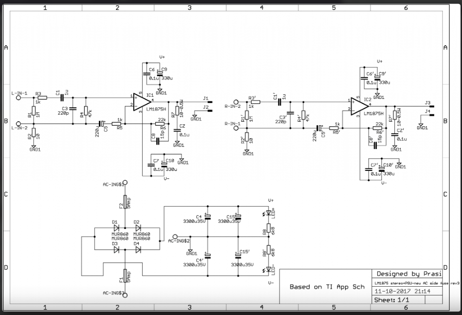

FWIW, I built this one. Power supply is on board. Gerbers are available.
2X18V transformer. 21W per channel.
Approx $150 without a case. Chips form Mouser!
It's going to look nice in the case that I'm planning. Much better than that insanely priced PTP unit.
