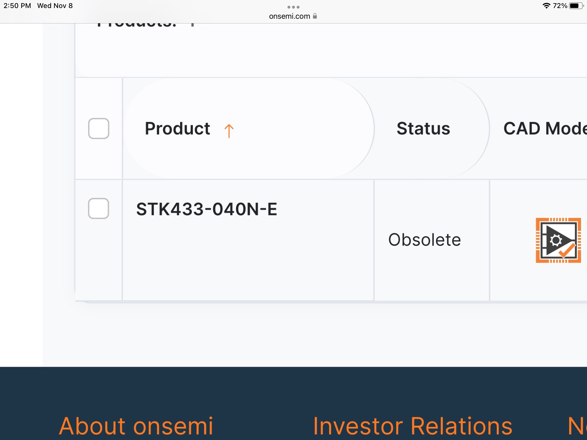

https://www.onsemi.com/products/sig...parators/audio-power-amplifiers/stk404-070n-e
https://www.onsemi.com/products/sig...parators/audio-power-amplifiers/STK433-040N-E
Yes, they are detailed, so must be available.
And other versions for brake control and IGBT control are also listed.
They say original thick film technology is used.
Bear in mind that the same technology was used for SMPS controllers, electrical brakes, audio power and differential amplifiers, and other applications.
All were called STKxxxx, so STK was actually a description of the technology rather than a family of chips with similar applications.
Riiiiight.

So they stopped selling STK audio amps, for whatever reason....

“For whatever reason” is because nobody uses them anymore (for new design). Same reason they change Mosfet offerings every 6 months. If they don’t get a major design win right away with a new product it goes EOL. Thats life today.
