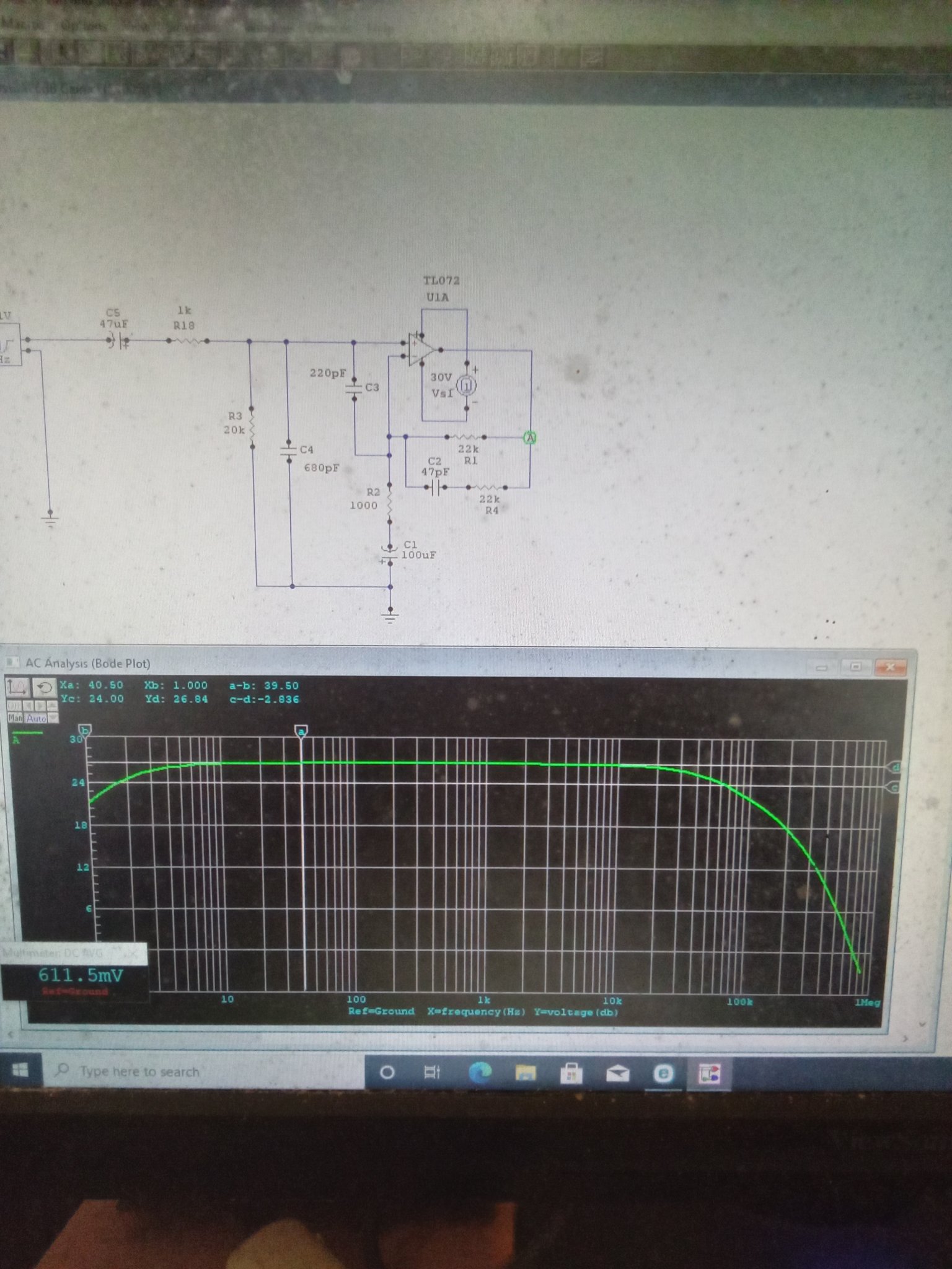

LM, TDA Chip Amps is **** Comparing with STK
how bass lost

But here one thing i should mention that, power amplifiers are not the same. Final outcome depends on the total system & it's execution. When i compared 3886 & 7294 using same speaker, TDA sounded soft(thin) at the low end compared to LM but that doesn't mean TDA is weak at BASS. With proper, dedicated spkrs 7294 is able to produce excellent bass. Many subwoofer system using 7294 at their power amplifier section.
The 10 Ohm output resistor is irrelevant at bass if the 0.7 uH inductor has a low dc resistance.
My suspicion is that the chip amplifiers are flat and low distortion. The STK is generating low frequency distortion that is heard as "more bass". Our ears are a bit insensitive down there and a bit of 2nd and 3rd harmonic is a common trick in bookshelf speakers.

If you pass a generator, you will see that there is nothing wrong with low frequencies using chip amps. The problem is in music that goes wrong. I have experience with LM3886, and TDA7293-4, as well as Chinese lm1875/TDA2050.
The problem is the PCB that is wrong. If you look the output and supply pins you see that the output is in sandwich with the supplies for the good reason that the thin leads of the chip cannot pass individualy high ac currents but they can If the magnetic fields are canceled. Those who design the PCB neglect to apply this fact.
A second reason is the positive feedback that the input applies to the ground. This you can suppress by using a virtual ground made of 2 resistors 2.2k from the supplies and use it as input ground. The input signal then enters the amp with a DC blocking capacitor.

The plot shows the response is flat to 10 Hz.
How it that a loss of bass?
Did you compare all the chips at the same gain settings?
As you may know, volume or loudness greatly affects our perception of bass frequencies, as in the Fletcher-Munson curves.
https://en.wikipedia.org/wiki/Equal-loudness_contour
tested input cap value and bs cap value
input 47uf
bs 100uf
simulator showing 10hz range, but lm3886 and tda7294 not produce bass frequency
