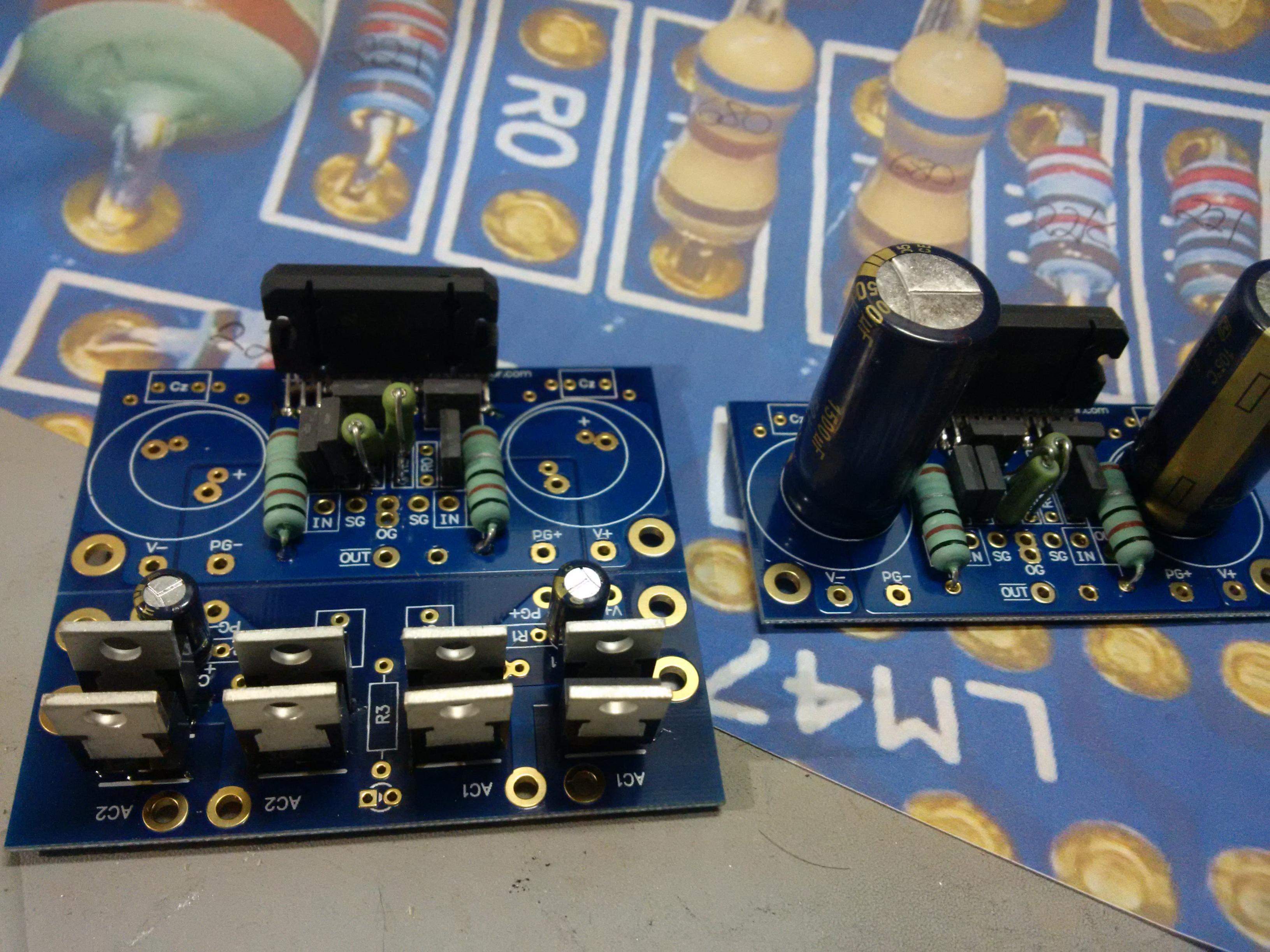

Hi there, I finally got my amplifier all put together and everything ready to go using the parallel config (audio sector kit with r0 omitted, inputs sharing r4). I checked the DC offset with no load or input connected and got 182 mv on the right channel and 162 mv on the left. I then connected a source (focusrite ls56 interface) a rechecked, since the offset should go down due to low impedance of the input. Still very high, 143mv and 110mv.
Can anyone offer advice or an explain it like I'm 5 diagnosis of this? From everything I have read, the DC offset should be under 50mv

I would check again, and very thoroughly. That level of offset seems extremely high. Can you show how you have wired up the power supply?
And some pictures are always helpful. Cameras can pick up stuff your eyes will miss.
This is the only current picture I have of the power supply board, you can see everything that is on it, just 8 diodes, 2 47uf caps. I am using a dual 24v transformer into the 4 ac ins. The amp boards resistors are Caddock mk132 22k and 220r, kiwame 680r and the .1% big guys supplied with the kit.
I talked to Peter Daniels, he said to try and lower the value of the shunt resistor on the input from 22k down to 10/11k. Maybe because it is direct coupled, the impedance of my signal from the interface is still a bit high
Oops see attached

The way I built the kit:
1. 4700uF caps on the PS boards
2. Zobels on all LM chip outputs
3. 22k Rin, but one for each input - not shared.
I get excellent offset values in every possible mode. I do remember having issues with it initially but after giving each chip its own grounding resistor it was A-OK.
Try Peter's solution, it certainly can't hurt...
