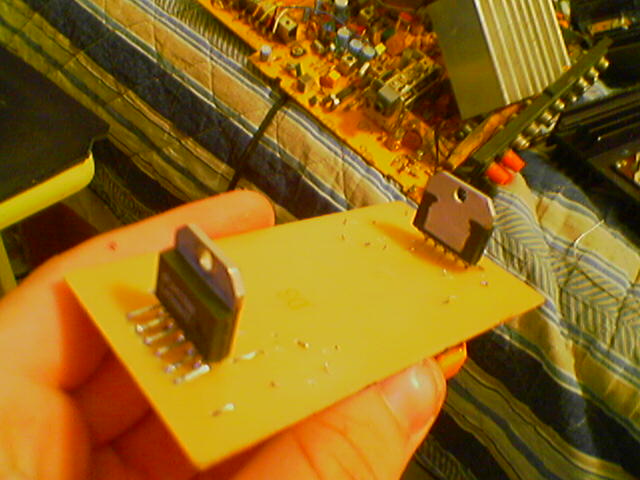

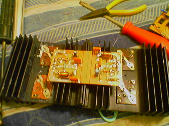

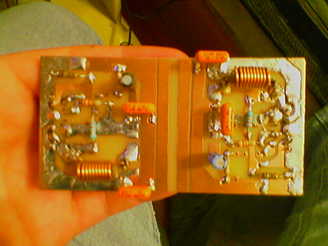

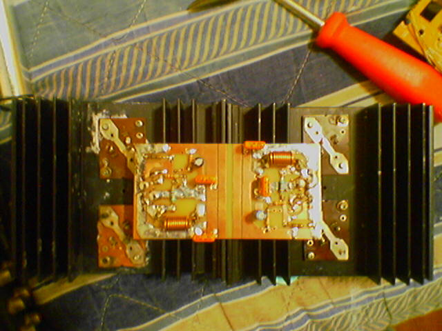

FINISHIED the 3886's PCB ! 😀 😀 😀
I soldered the parts at the back, because of the heatsink !
As everybody says that it's a huge 10A device, I made large connections on the board !

I tested it today, and all old problems were solved, no more RF interference and heat. I think it was heating because of oscilation, as the Nordic said ! Now it's much more cold.
Two 0,1uF 250V polyester caps were added between supply rails and the ground. And in the imput I added one 100pF to the ground, and finaly at the output, I added the 0,7uH with 10R resistor, to prevent oscilation 🙂
Everything is fine and cold now ! 😀
