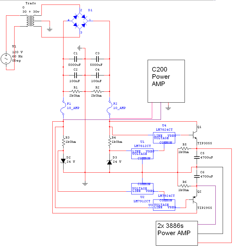

I bought two 3886 to drive four 20W 4Ohms speakers, two for each channel, so, 8Ohms, 40W.
Each 3886 will work with 84 V, and they will be fixed in a BIG heatsink. I'll use HIGH PASS filter to this ! :angel:
Now, I want to know, before build this, if anyone have some tips and tricks about this 3886 ! 😉

84v total, it's 42+42v.
I don't have other transformer, and I'll cut the low frequency, so I don't think the 3886 will stress so much heh ! :clown:
If your transformer is 42 + 42 V, after unregulated PS (diodes and caps) you will have roughly 58 V +58 V. Please read National spec sheet because you will burn your chip. Your Voltage is exceding maximum allowed for the chip. You will have 116 - 119 V between rails.
http://www.national.com/pf/LM/LM3886.html

Hello nando,
If you already have a centre tap transformer. Better option i think will be to use the normal 78xx and 79xx with a power transistor 3055, 2955. To achieve the required voltage eg 30v (assuming you have only 7824) you can lift the groung of 7824 to +6v by a 7806. Likewise for the negative voltage. The output of the regulator is connected to the base of transistor, collector to unregulated supply(42v) and emitter as output. Not sure if there is some other problem in using this. But i have being using this circuit for quiet some time.

GREAT ideia ! :bigeyes:
But power transistors have a little loss, like ~0,6v... If I play music loud, will the transistor have more loss?
Mick_F said:
Consult the datasheet! If you want to drive 4 Ohm speakers, your rail voltage should not exceed 30 V
Mick
So ! I'll drive an 8 Ohm 40W speaker !
In the datasheet says that the MAX voltage is 94v (47+47), when there's NO SIGNAL in... So, this is the peak voltage when the PSU is not heavy loaded, like when we play music loud. My PSU give 84v (42+42) when it's not loaded ! So, playing music this voltage will fall down. The same PSU is shared with an c200 driving a 4 Ohm 125W subwoofer, so when I push it to LOUD the voltage of supply will realy fall, then the 3886 will not suffer so much. The heatsink is big too !
With all this, still dangerous use 3886's this way ? Will be two 3886's and a c200 in the same supply... It will be used every day, but not too loud 🙄

About the SUPPLY, I think I found the solution, designing the attached supply.
The logical is the following:
+- 30VAC -> Retification -> +- 42VDC --> Fuse* --> Zenner 24v Regulator** -- LM7812 and LM7912 regulators*** --> 7824 and 7924 regulators **** --> TIP3055 and 2955 power transistors
* After the fuse, the C200 Amplifier will be connected.
** I'll use zener 24v regulator, because 78/9XX only suports max 35v
*** It's to lift the ground of the 7924 and 7824 regulators, because they only suports 40v. So they will work with + - 30V
**** They will drive the power transistors, because of the current that the system will drain
The output voltage to LM3886s will be +-35v, not 36, because the power transistors are not 100% efficient.
35v is a very good voltage, they will drive 8 Ohms speakers.
What you think?
FEEDBACK WELCOME ! 😀
