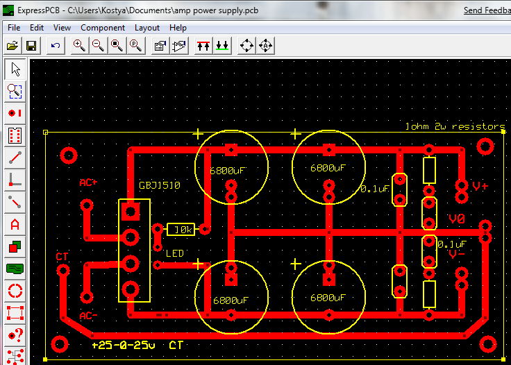

Did I connected the diode right way? I'm not really sure, looks ok to me.
The 2 centre pins are AC, the outer are + and -. Also, the pin spacing is 10mm - 7.5mm - 7.5mm with the 10mm space between the + pin and AC1.

250mW resistor would do.
Some 600mW resistors are the same length as 250mW ones. Use 0.3inch pin pitch for all your resistors.
Check the pin pitch of the rectifier.
What setting have you got for the grid dots in the PCB software?
What setting have you got for the snap to grid?
Have you got snap set to off?
