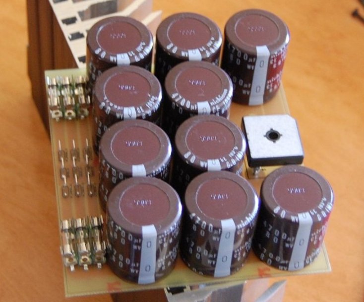

Sorry for double post. I forgot to mention that I'm building this for 8ohm speakers and I might use 30v transformer, I haven't decided which one to use.
Bring the two groups of three input/output connections to 0.2inch pitch. It allows use of three way terminal blocks or soldered joints.
Leave lots of space around the 4 caps just in case you want to use 40mm diameter.
Squeeze everything else closer to reduce the size of the PCB.
Increase the width of the high current traces by a factor of 4.
Add an optional snubber R + C across each diode.
Add a snubber R + C across the output.
Add a cap from AC to AC to absorb glitches/pulses coming from the transformer.
Think about adding pads for a resistor in each feed line both before and after the first capacitor. That's 4pair of pads. These pads can be for thermistors and/or inductors and/or resistors. This makes for a very multi-purpose PCB.

30Vac sounds a bit (lot?) high for an 8ohm load.fr1s said:I'm building this for 8ohm speakers and I might use 30v transformer.
30Vac can give >48Vdc if mains is running at +6% and the regulation is 10%.
Or, do you mean 30Vac centre tapped which is equivalent to 15-0-15Vac?

You get, what your amps ask. If the sum is more than 3 A for more than a few ms those diodes will blow.fr1s said:Also I found out that they are 3A, does that mean that on out put each of my amp's gonna get 3 A or just 1.5?
Did you read the datasheet? Max rail voltage is 60 V or ±30 V. How much is 25 V times 1,41 plus regulation plus mains fluctutation?fr1s said:So if I'm gonna use these diodes does, do I have to get

So you do expect more than 3 A?
Start with reading the datasheet.
To make a nominal 20 W amplifier you need ~±22 V loaded with 8 Ohm speakers or ~±18 V loaded with 4 Ohm speakers.
That is ±25-26 V unloaded -> a 2*18 V transformer 1,6 A per channel for 8 Ohm or ±21-22 V unloaded -> a 2*15 V transformer 2,25 A per channel for 4 Ohm.
Use a transformer with 80-120 VA for a stereo amplifier. 40 VA would be enough, but has too high regulation.
Check: 2*18 V +25% safety margin for regulation and mains fluctuation times 1,41 minus 1,4 V diode drop = 30,3 V. One percent overvoltage at no load should be acceptable for a worst case assumption.
The 1N5401 will be okay, because a normal music signal will not lead to peaks that surpass 3 A for long enough to destroy them. Use them, if you already have them.
A good alternative would be a bridge rectifier. It is easier to connect compared to single diodes, thus avoids wrong connections. E. g. something like this.

I had two of the four 5406's short on power up in this power supply board. I switched to a 35 amp bridge.
post25.
why have you deleted half the capacitance?
As it was is far superior and particularly, more flexible if you add the extra resistors/inductors as suggested.
is that 47mF charged to <80Vdc from one 1n5406 bridge?MJL21193 said:I had two of the four 5406's short on power up in this power supply board. I switched to a 35 amp bridge.
Maybe this would have benefited from a slow charge circuit.
