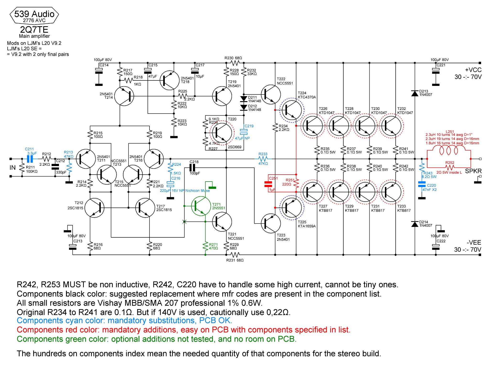

Pandinus is right, try to check the resistor with a magnet! It seems to be not negligible at all.

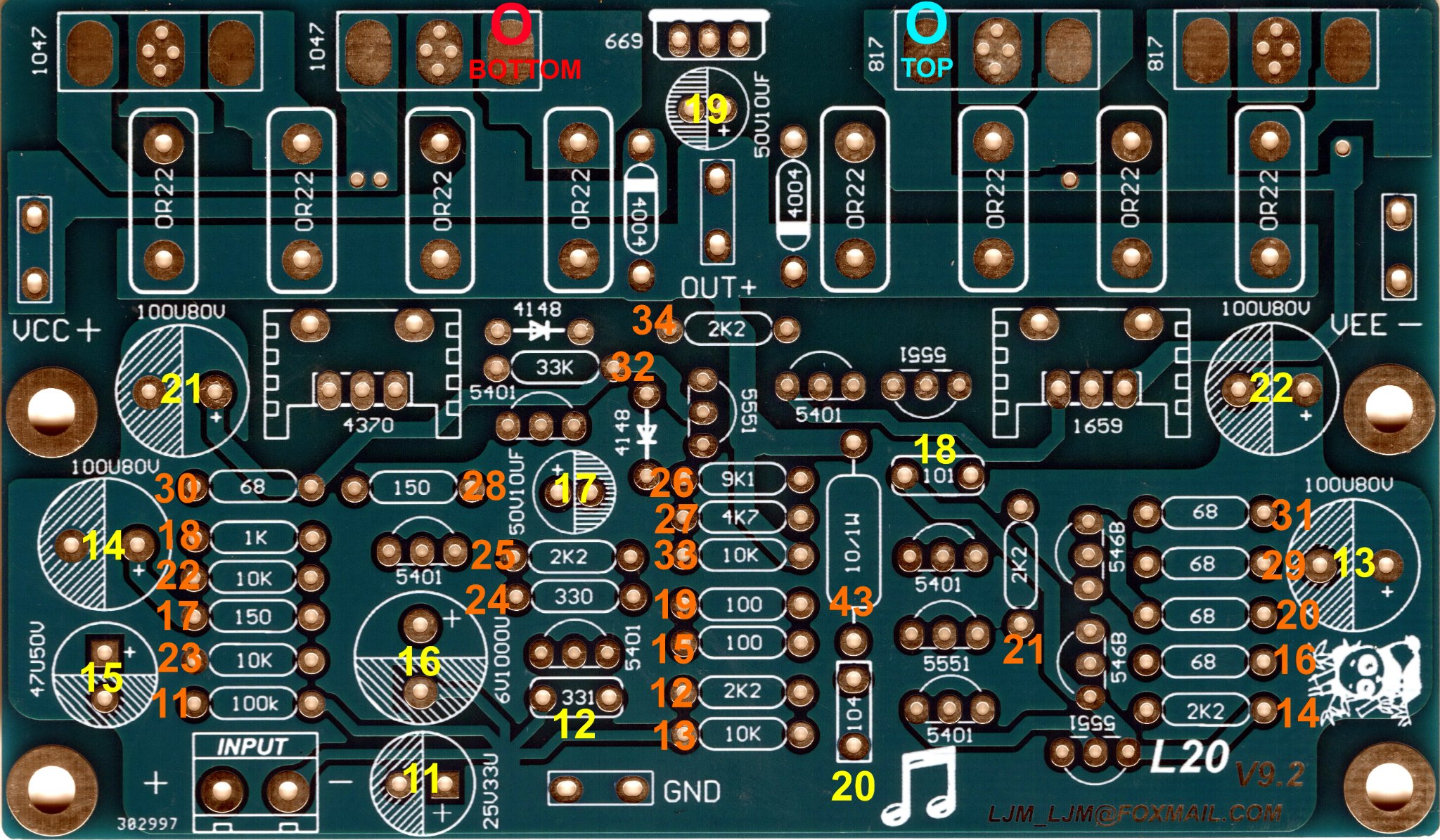

When I got the schematic from the PCB, I forgot to consider a 2.2KΩ resistor, the one around the center/top of the PCB. This resistor I named R234 now, is one of the two I added in red on the last schematic.
So here is the schematic updated, and the PCB with component numbers.
Please FORGET the old schematic and take this one as a reference.
R251 and C151 must be soldered between the bases of the final pairs, the closest points are referred to with the letter "O", one bottom side (left of the board - red), and the other on the top side (right - cyan).
Caution when using a voltage close to 140V: one of the small transistors (I don't remember which one), becomes too hot, check it out. I will discover and report it when I build this amp with 140V, perhaps next fall.
To answer Radian's question: Yes, you could mount only one final pair to drive a 5W compression driver and use 50V/60V total voltage.

Measure the inductance with and without the resistor. Then for the real test, measure distortion with and without. Whatever you come up with it the truth.
The first inductor that came in handy is 14.5µH; with the resistors, the value barely moves to 14.6. So you're right! But I'm surprised how strongly a magnet attracts the resistor, not on only the caps, which would be normal, but the center. It has to be considered the mass of the magnetic parts of the resistor is very negligible. Thank you!
Distance is one factor. But the magnet works on the entire length and has a much higher field intensity. And then again, the amount of hysteresis is small as well. In other words, doesn't amount to anything in the real world.

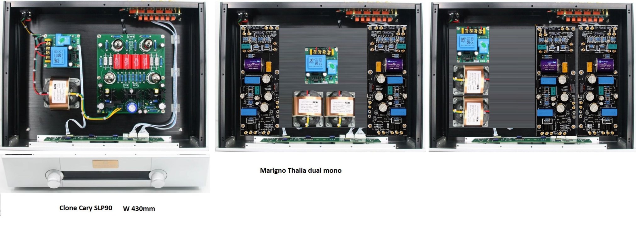

Ok guys did all the mods according to the last schematic.
Associated equipment as follows:
Wiim Ultra USB out into China Fifo DDC into
Chinese R2R DAC. On the DAC all opamps are removed going straight from the resistor ladder into the discreete part( opamp removed) of the Chinese Accuphase clone preamp, from there into modded Cary SLP 90 clone tube buffer into Marigno modded LJM 10. No coupling caps on amp as tube pre got those on the output. Speakers at the moment are Quad 21L.
After about 30 hours I can already attest it's a step up from the stock unit. I'm not very good at describing sound impressions but I try to communicate what I hear:
Bass definition and precision is top notch.
All instruments of an orchestra have a realism that is rarely heard even on expensive gear. Pinpoint imaging and soundscape is phantastic although that is mainly due to the excellent Tube pre.
My search for a good amp has certainly ended right here. D-Amps have reached an amazing quality especially when you get rid of their opamp based pre stage. I enjoyed fiddling with them but this modded LJM 10 9.2 board is a good step up in sonics.
I'm curious now how marignos preamps would stack up to my Cary SLP 90 tube pre clone?

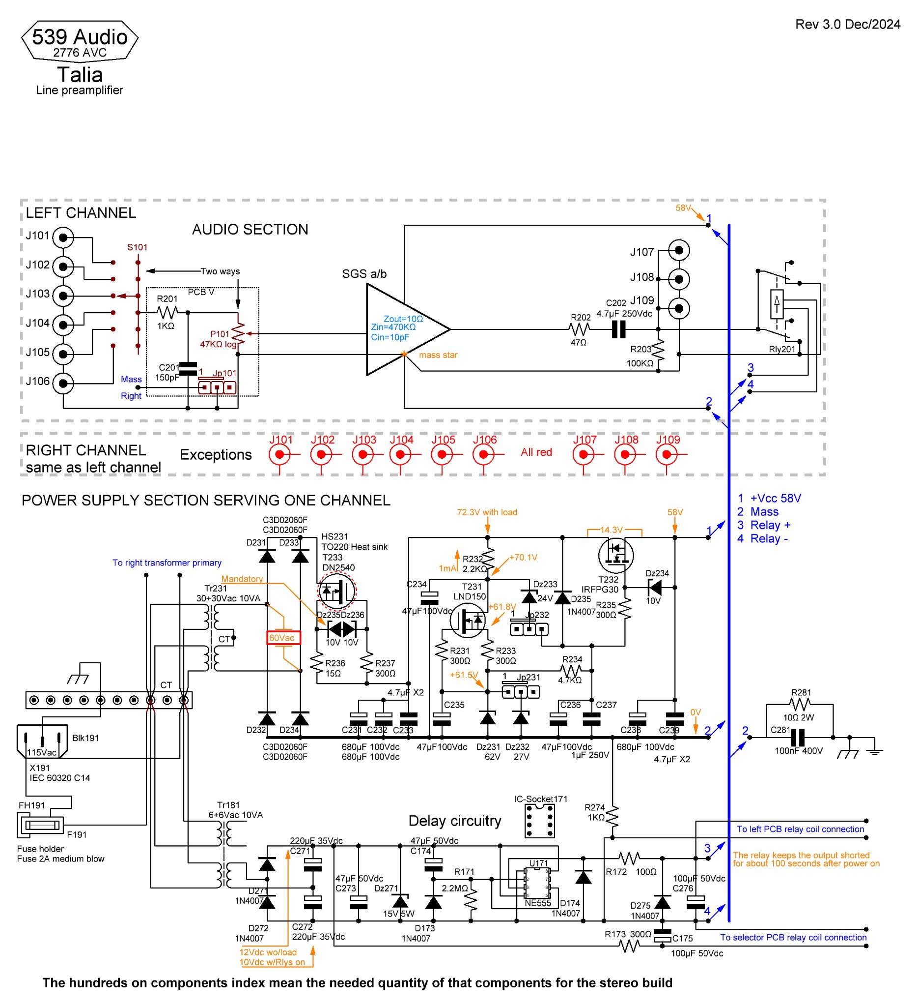

Hi Klaus, I'm glad you like this power amp!
The preamplifier I'm using currently, named Talia, is here:
from post #57.
I haven't posted any updates yet because the final thing needs a new thread to avoid confusion, like I did for this L20 9.2 project.
I made some other hybrid preamplifiers with a triode (I used the VT37 and VT76 too) as a gain stage, and a mosfet as a follower.
Among tube and mosfet as followers, I prefer mosfet, far better than tube IMHO. I also prefer SiC diodes to tube diodes as rectifiers because to me they are identical, and SiCs do not have any heater to feed!
As a power supply for preamps, I always use the "Virtual Battery" topology in my interpretation. You can see it in the thread I mentioned above, but now it is greatly improved; take a look at its schematic here.
Be aware that all preamplifiers of mine, like your Cary SLP 90 (and Conrad Johnson GAT too), are inverting, so to restore the original phase (if you are sensitive to this), you have to swap the speaker connections.
