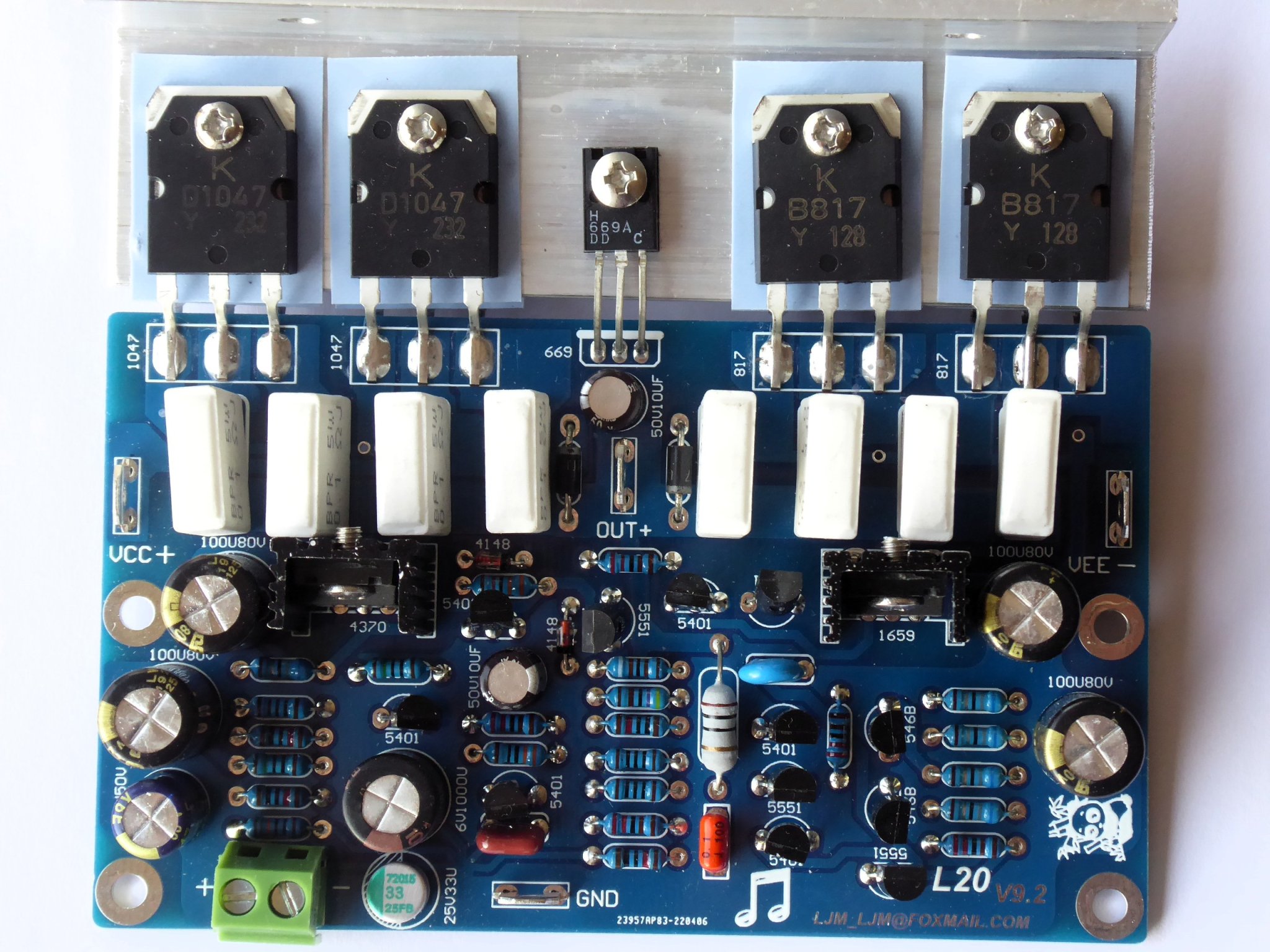

LJM L20 V9.2 main amp
Transistors seem to be good ones. The link I bought the kit is this: https://www.aliexpress.us/item/3256...t_main.17.709b1802eDrr7d&gatewayAdapt=glo2usa and choose "Type 1", you have to buy everything, but at least you get 2 bare PCVs. The price is good if you consider you get all transistors. Be aware the 2N5551s included in the kit have a pinout different from the one we all know, the base is not at the center, it is BCE. The PCB is made to fit this different pinout. Usually, when you buy a board the transistors are good ones. But if you buy transistors on eBay, you probably get fakes, almost sure!

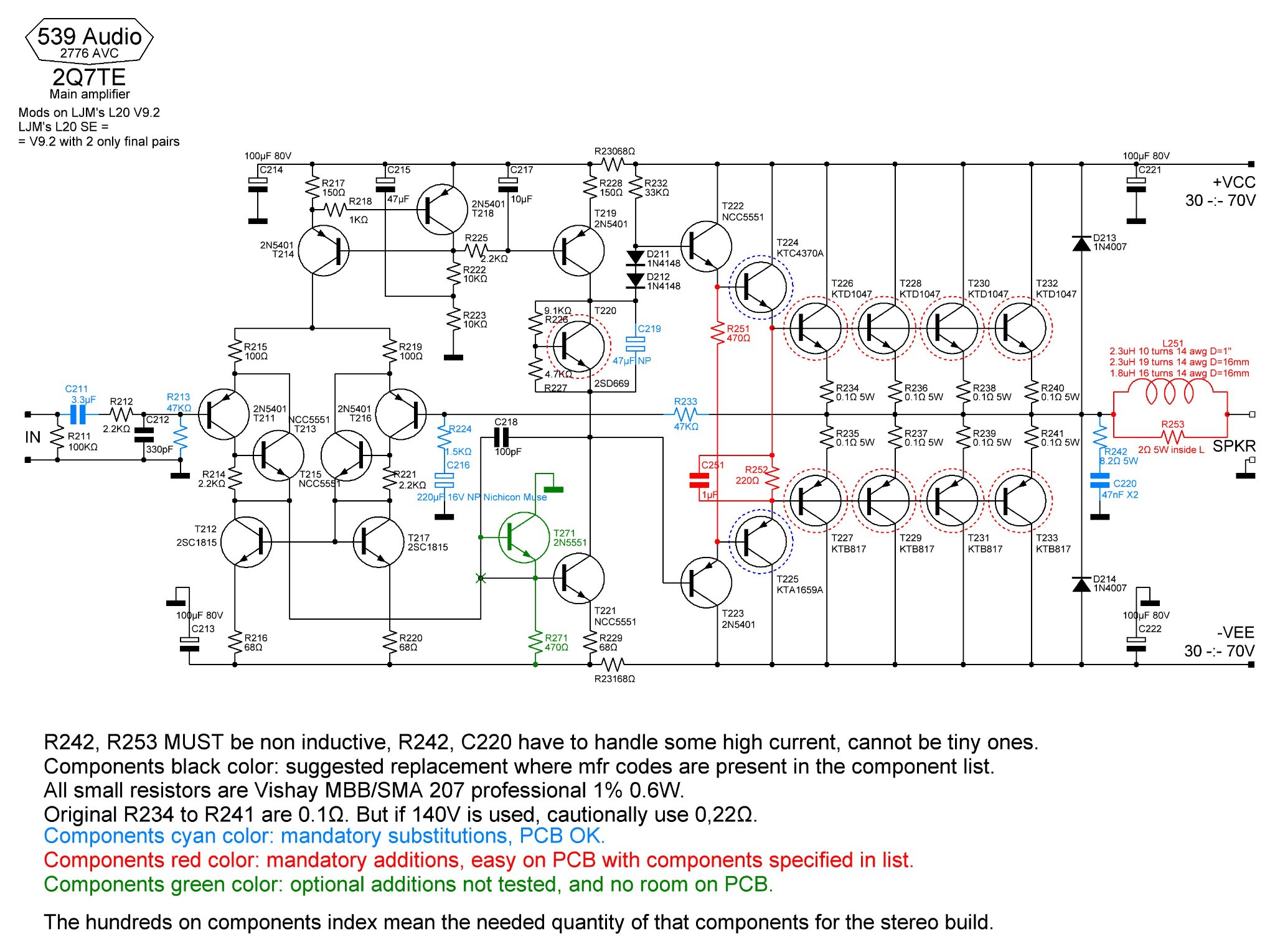

Here is the updated schematic (mainly for R213 and Res), and the component list.
The 5551 are from CDIL, their name is NCC551, and are identical to the 2N5551, but BCE pinout.

This is a new un-touched board. I have another pair made up into a stereo amp, and all I did was to remove and replace C1 the input cap for a 10uF MKP type. I note these new latest boards use a 33uF solid electrolytic type (I think?) so I would perhaps not even change this. I did not add an output coil either. However when I get round to using these new boards, I might add one, but not likely to change anything else...... PS: I am currently builing an L12-2 V4.2 amp for comparisons

I will build the real thing using a 140V total PSU, expecting an output power of about 200W/8Ohms. I know this way there is a transistor becoming hot, but I don't remember which one, perhaps T219, I'll find out.

Marigno suggested some nice modifications. I would just like to note that the added output choke should not have a parallel resistor placed inside the coil. The resistor acts like an iron core and this can cause increased distortion in the coil.
I'm sorry, that simply is not true. The core of most resistors is ceramic. If you are concerned about the resistor leads, not enough material to be concerned about. The resistor damps the coil, which is why it is used in the first place.
