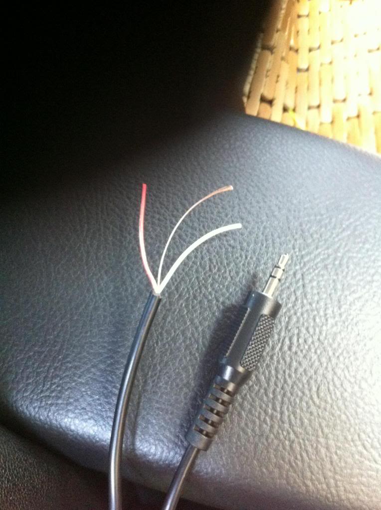

One more question about cables. I have used the following type of cable for interconnections.
Is it sufficient?

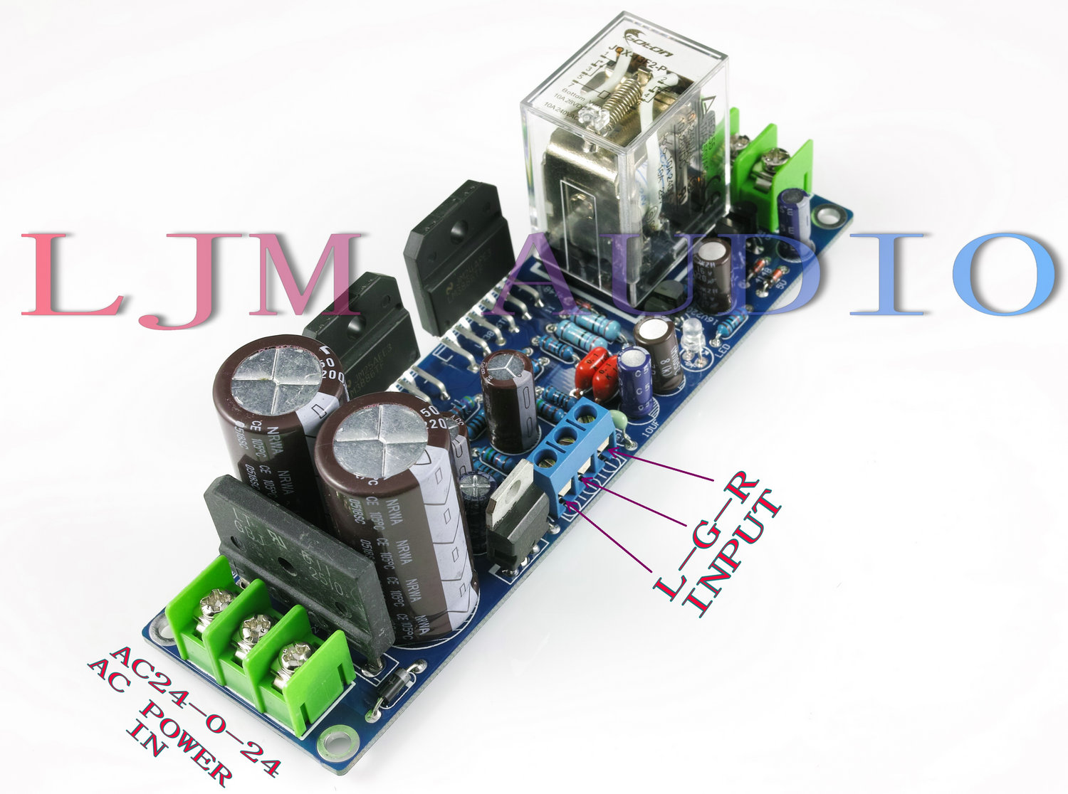

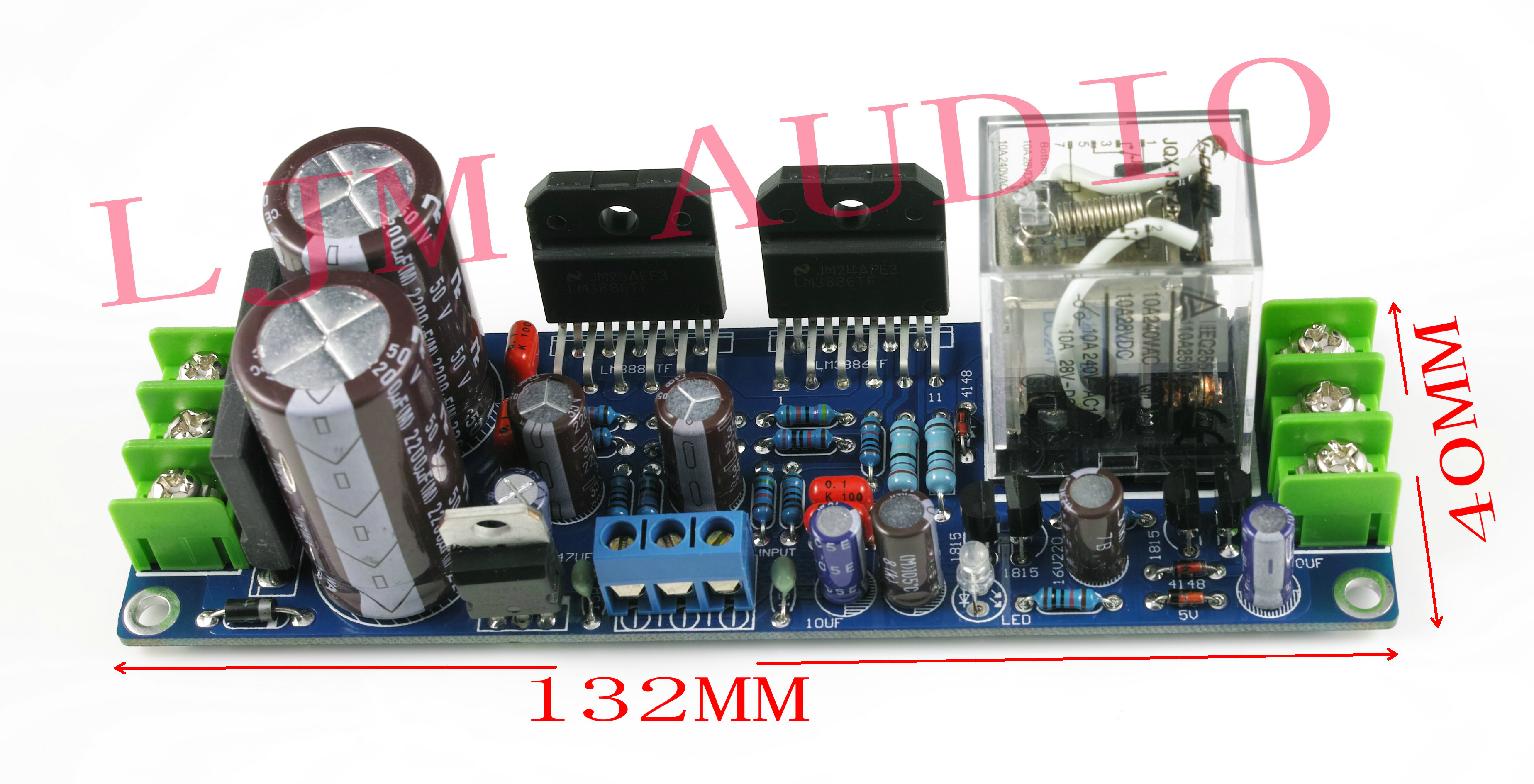

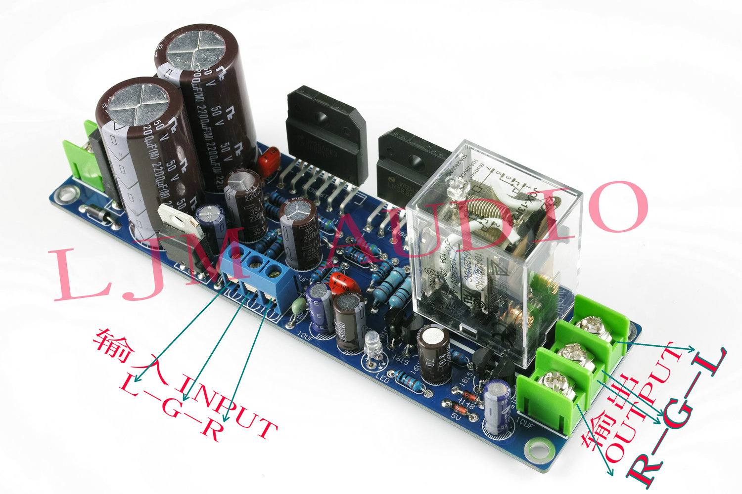

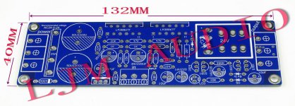

LJM New Small toys GC LM3886
Small toys
Take a look at first.
Pictures than text easier to understand.
Small toys

What difference with your LM3875 ?
I build :
Please note that it's works with 28 volts, cause relay are 24 vdc.
It does the job for the cheaper price !

LM3886 LM3875 they are fine.
Relay is through the half-wave rectifier, plus LM7824 for use in relay power supply.
So no problem.
LM3875 now, here I seldom buy chips.
LM3886 more. As for the voice. I think they are close to.
Maybe LM3886 speed faster.

In my introduction illustrates it USES LM3886 PDF circuit in detail.
It is very simple. I want to discuss this circuit. Rather than sell it at the BBS.
I don't have international account. If someone buy it from China. I would be happy to explain some problems for others.
As long as someone ask. All can get the exact answer.
Thank you very much for your help I placed it in the right place.
Because I really don't know where it should be given.

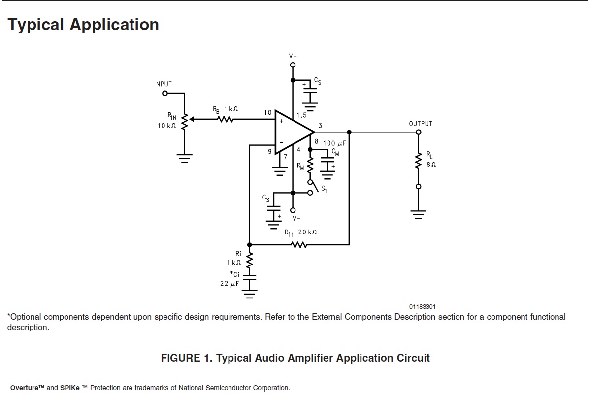

Can refer to the official information about circuit. The following diagram is introduced.
I appropriately increased input LPF, as well as Zobel network.
Few questions from newbie :
1 can remove Rb 1 Ko (input resistor) ?
2 gain is 21 ?
3 is that "speaker protection" works when a DC signal is at input ?
4 where buy it to China from Europe ?
5 relay is 24 vdc ?
Thank's.
Phil.

1 don't delete R1, in fact, behind the product R1 and a capacitance. 15 pf.Hi,
2 gain is 21 ?
5 relay is 24 vdc ?
Thank's.
Phil.
It with R1 LPF filter.
2 gain = 21 voltage amplification.
3 have a dc voltage output. Will cut off the output.
4, can use the TAOBAO net. I can only use it. Can I email to ljm_ljm@foxmail.com
5. Relay use 24 v dc voltage. But it passes through a LM7824 voltage regulator IC. The half-wave rectifier.
Suggested that the transformer use AC24-0 to 24
