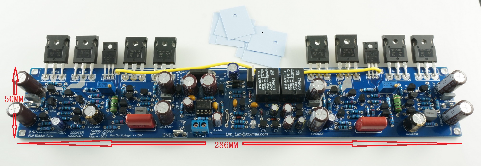

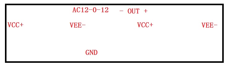

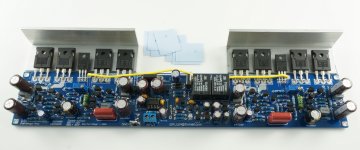

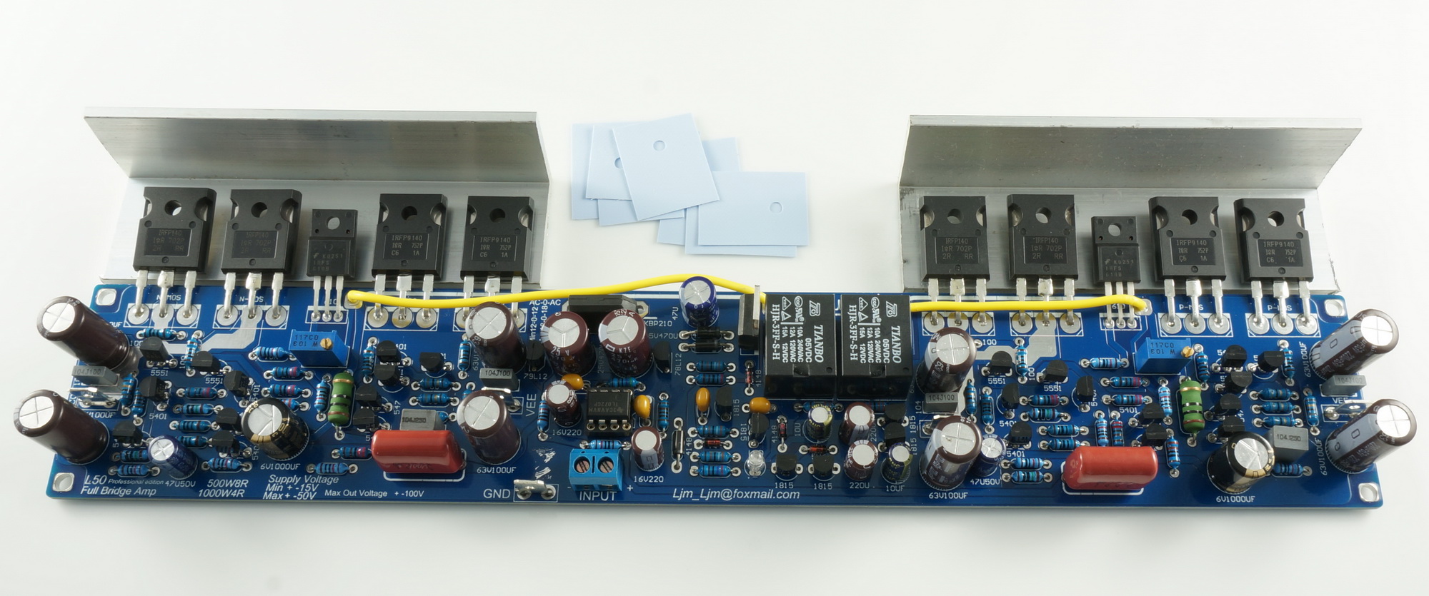

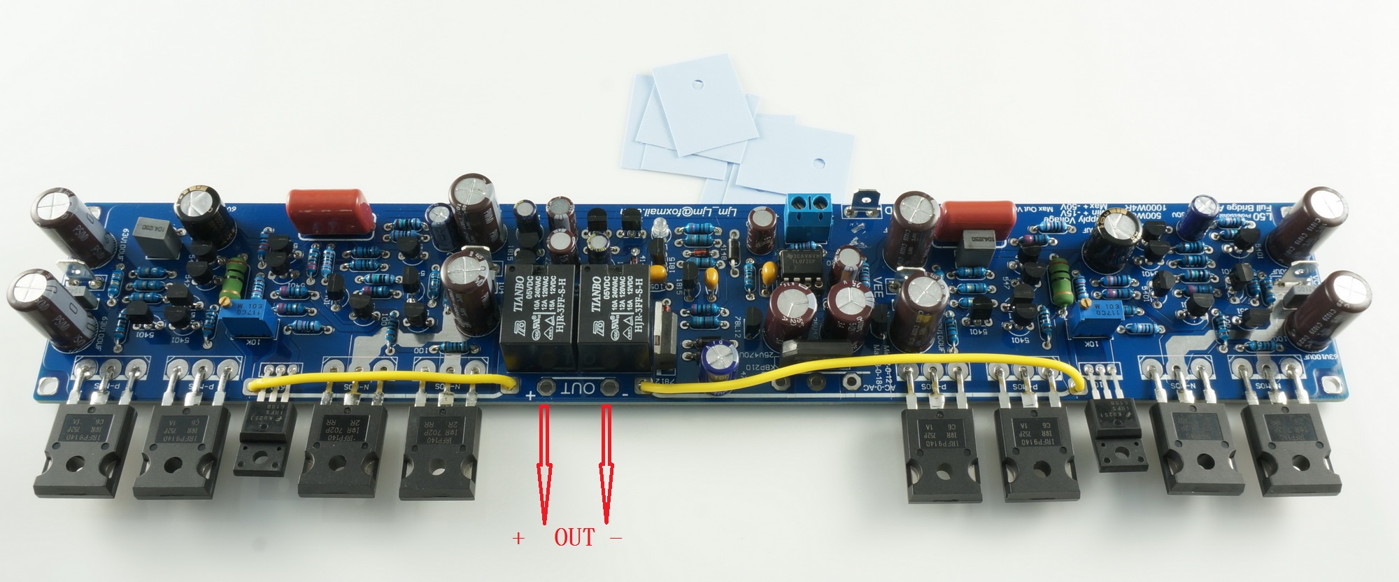

Update a few pictures about the appearance of connection diagram.
