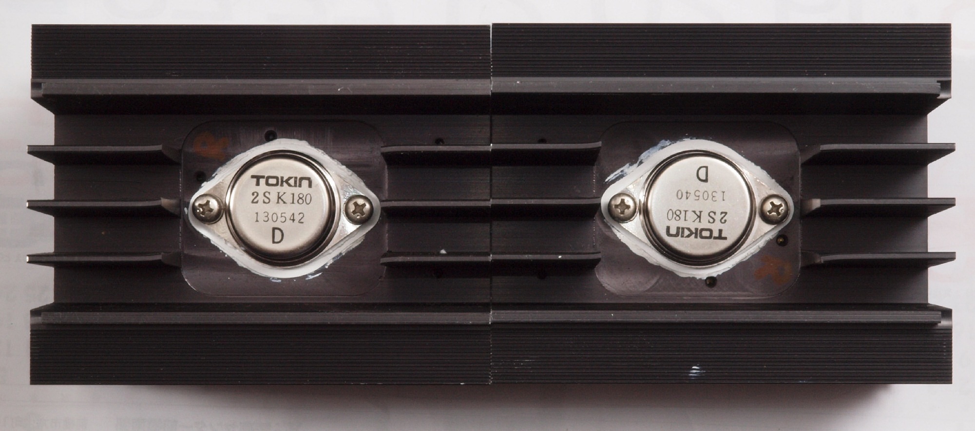

I can see a full box of brand new 182ES beside the heat sink :🙂
Could you share the source, I am still looking for 2SK180s, but unable to find them even in the second hand market of China.

2SK180/ 182ES are from Eyelabo so big chance is not good ones
Probably all was radiated by Fukushima accident
and transformed on Frankenvfets....

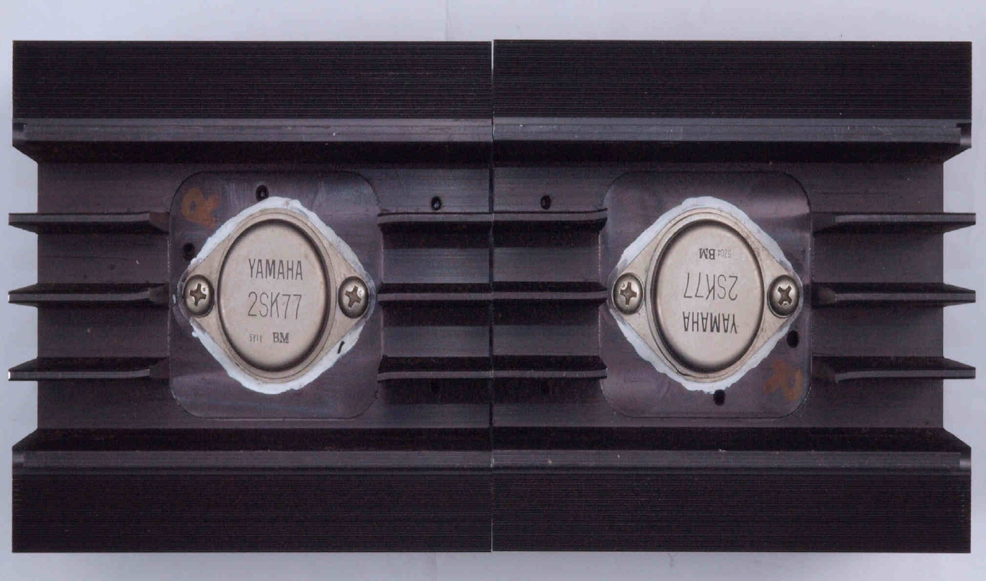

But from other peoples i see folks rebuilds B1 Yamaha with Tokin 2SK180 grade D
B-1�@SIT ‚Q‚r‚j‚P‚W‚O
Please scroll down page to see all informations. Cheers

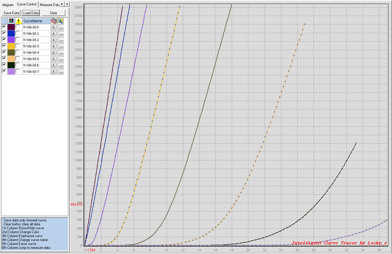

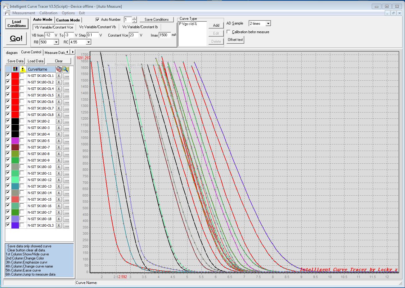

Bought a couple of 2SK182ES from Eyelabo too. Is there any other way to test the device if it's faulty without a curve tracer? The serial number on the devices are 1Z2631, 1Z2632, 1Z2633 & 1Z2634
Is there any other way to test the device if it's faulty without a curve tracer ?
Yes diy quick L'Amp prototype adapted to 2SK182ES and make sound

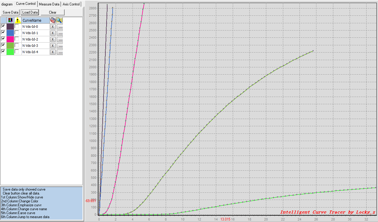

May be a problem of Lockys tracer
the voltage for the biasing of the gate is subtracted from the available source drain voltage….
so the ones needing greater Vgs starve on Vds…
But I am not really good in calculations like this ….
only a hint….. Locky himself told us that measuring SITs with the tracer is not really effective.
to be sure I would build Mikes Frankenstein machine……..
Hi generg,
Thanks for your remark and I'll try some other means to double check. Locky's tracer can give all sort of funny behaviors, especially when the DUT oscillates with it, but I'm not quite sure on this case, as the tracer board was able to trace correctly 10+ 182ES and 20+ THF-51S (an example attached), but I'll check again.

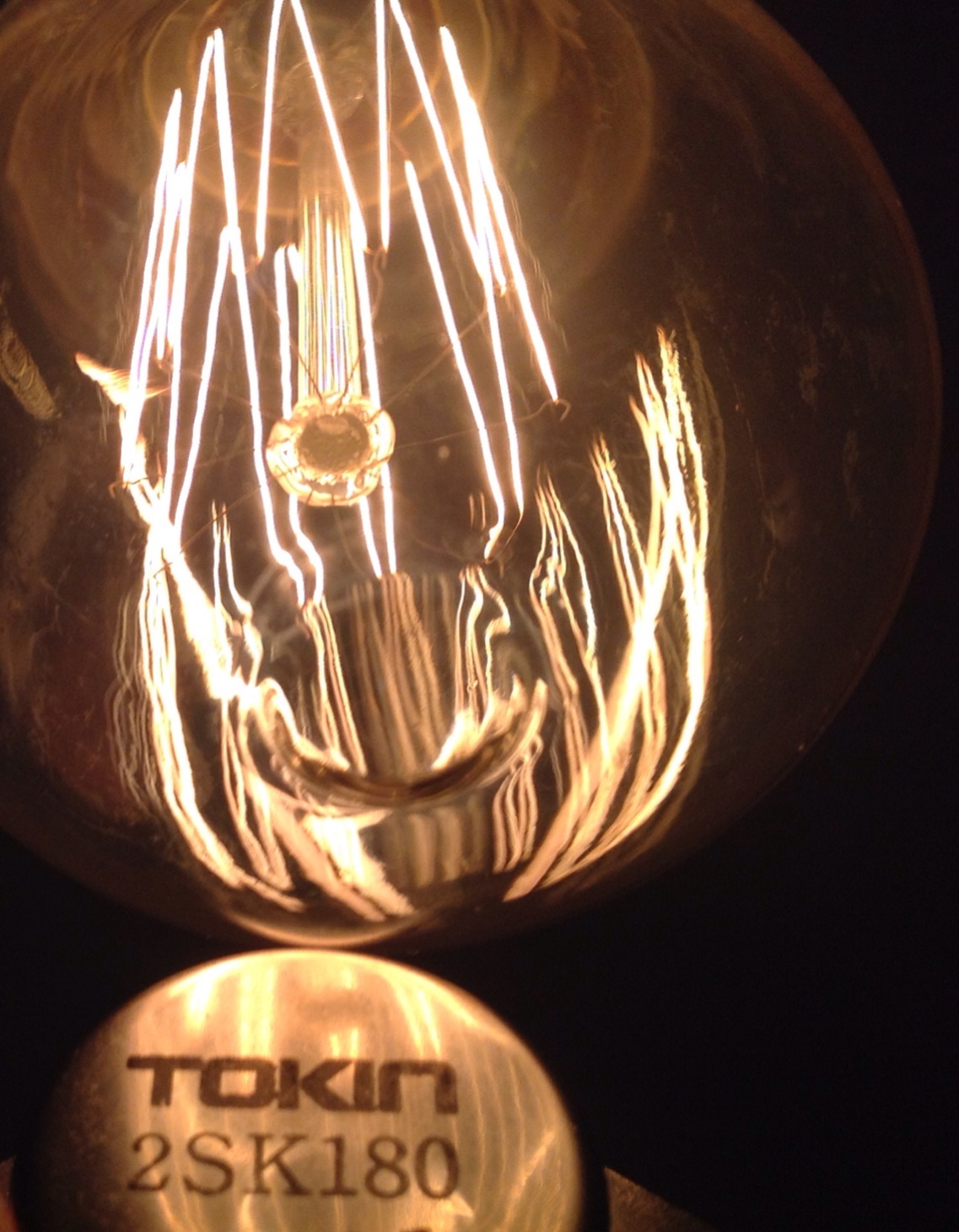

I also plan to build Mikes' Frankenstein machine, but the biggest headache is to get the 300W/120V bulb, I find it harder to get than the SITs (Amazon refuses to ship 120V bulbs to where I live, where the mains is 220V 😱).

I asked a Canadian diyaudio friend, dantwomey for the bulbs and he was so kind to send me six some time ago….
Maybe you find a guy here as well….. 🙂

I think we're showing different curves - the curves I showed are Id vs Vds @ varying level of Vgs bias, of a single SIT.
I guess the curves you showed are Id vs Vgs @ constant Vds, but for many different SITs.
A 25 Ohm, 100W or higher resistor will do a decent job in place of the light bulb, though the curves will be slightly more truncated at higher voltage and it's not as fun to look at 🙂
Thanks Michael, a power resistor will be my last resort, I like the cool looking feel of the glowing filament 😛.
