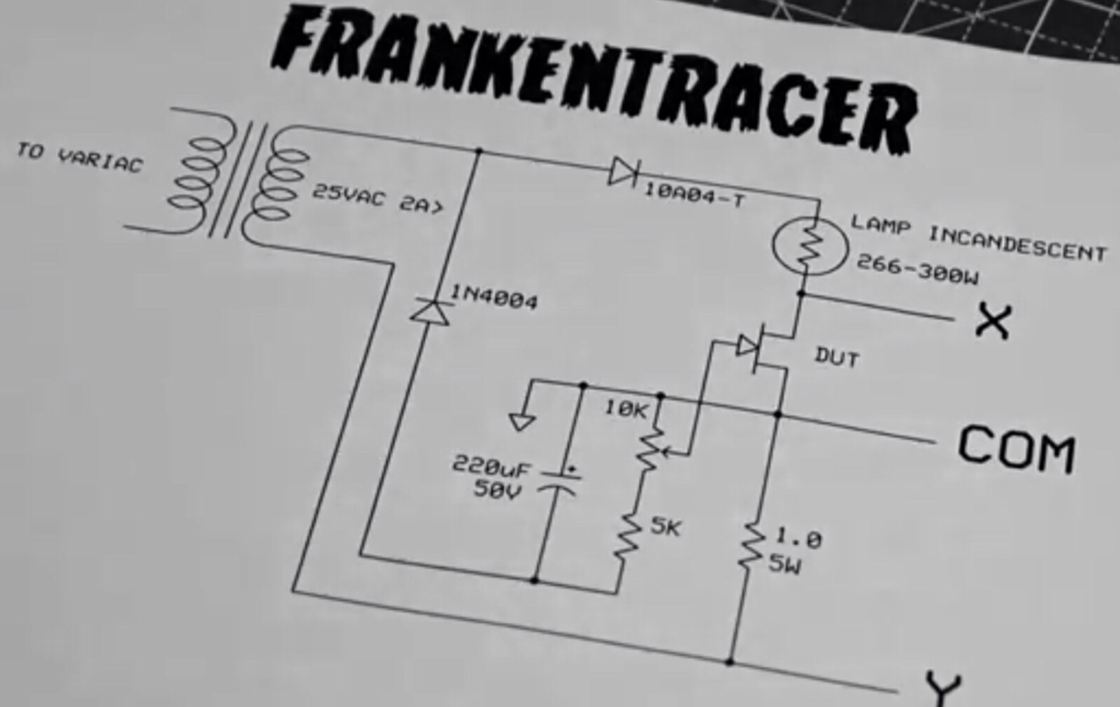

It's alive!
Just quick screen capture of Frankentracer schematic.
Thanks again Michael
Best regards 🙂

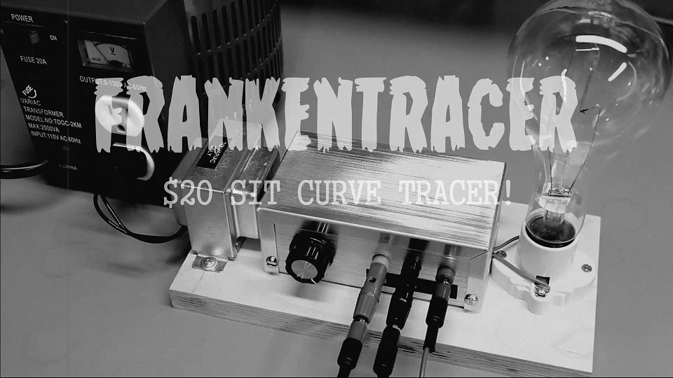

Excel capture is ready. I wish I'd had that when I wrote the original article in 2011. It would have been a nice time saver. 🙂
I'll work on the tutorial video this weekend most likely.
I figured what the world needs is more over-produced videos of obscure do-it-yourself test equipment. 🙂
