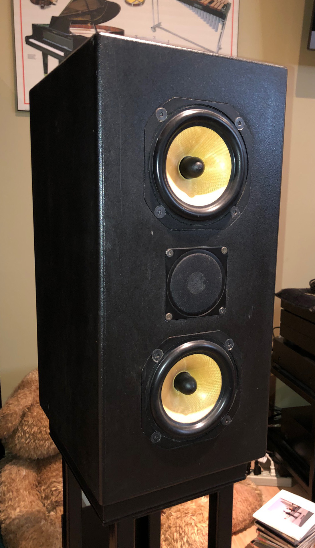

Looking for feedback on if switching Solen 0.91 mH 18G solid core inductors on a pair of paralleled Focal 5K013L mid/woofers (speakers use an Accuton [Ceratech] C22-11 Tweeter) to respective 0.91 mH 16G {16G to achieve same DCR as solid core coils of 0.45 ohm} Solen Heptalitz coils would make any sonic difference in the midrange clarity? I had switched from standard Solen fast caps for the tweeters to Clarity CSA series and was a very nice upgrade in sound for tweeter! Speakers are in MTM -D'Appolito layout by the way. I understand Litz coils might only make a difference for very high frequency but might be a waste of time (and money) compared to standard solid core inductors for mid/woofer only used up to @2.5kHz. FYI using transmission line subwoofers on these these satellite speakers crossed over at 80 Hz.
Should I spend the $50 to get the Solen Heptalitz coils in replacement for standard solid core types as a final upgrade touch for the speakers...or not...?
Crossover diagram and snapshot of speakers attached for reference:
Thanks in advance for any feedback,
Gordon

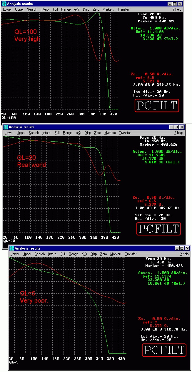

The technical spec at high audio frequencies (1KHz and above) that litz brings to the table is a higher “Q” than that of a solid core wire or foil inductors of the same gauge. Above audio frequencies, foil inductors have the better Q. Below about 1KHz the DCR of the coil is the primary Q determinant.I know some people like them, but I've never understood Litz for inductors. If you are using an inductor in a crossover, you are trying to dump or impede high frequencies. Why use a wire that is better at HF if you don't want the HF?
Q is the ratio of inductive reactance to resistance at a given frequency.
A higher Q means a less lossy filter response at the crossover frequency.

Q is most important in tuned circuits, greatly influencing selectivity, notch/peak depth at resonant frequencies.The technical spec at high audio frequencies (1KHz and above) that litz brings to the table is a higher “Q” than that of a solid core wire or foil inductors of the same gauge. Above audio frequencies, foil inductors have the better Q. Below about 1KHz the DCR of the coil is the primary Q determinant.
Not much useful, if at all, in non resonant circuits such as highpass or lowpass crossover filters.
If used as tuned bandpass filter in series with a midrange, higher Q is WORSE: midrange will receive a narrow peak: artificial and annoying (being polite).
That crude approach has been used before, but best way to make it at least bearable is to LOWER Q so we get a flatter passband..
Pano, please skim the first three pages of this thread for Al Klappenberger’s relevant posts regarding Q and crossover filter response. At your leisure of course.OK, I can understand that. But with a filter, I want loss. I want to prevent certain signals from going certain places.
@Brinkman , it is mentioned on the page you linked..
However we're not talking about the filter Q in this thread, which that effect should be applied to. The main effect of inductor Q in these conditions is to affect the lower frequencies.Low Q inductors will show up most dramatically right at the cutoff in a filter.
