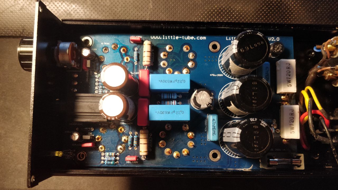

UPDATE: I re-soldered the capacitors, and well, either I'm very bad at soldering, or I broke something. Basically it's like the audio is muffled and extremely low quality (like a radio when the radio signal is really bad, don't know how else to explain it). Could this be caused by bad solder joints?
It is not a good idea to change two things at a time. If I understand correctly, you removed and replaced the capacitors in order to test them, and cut the jumpers for setting the gain. I think you need to restore those jumpers so that you can be sure the capacitors are replaced correctly, then look at gain as a cure.
nono the jumpers are on, they have a little cap that can be put on or off I never removed them. I just removed the capacitors, tested them, and put them back on, evidently I also did something else not on purpose. I also noticed now that it won't turn off unless I pull the plug.

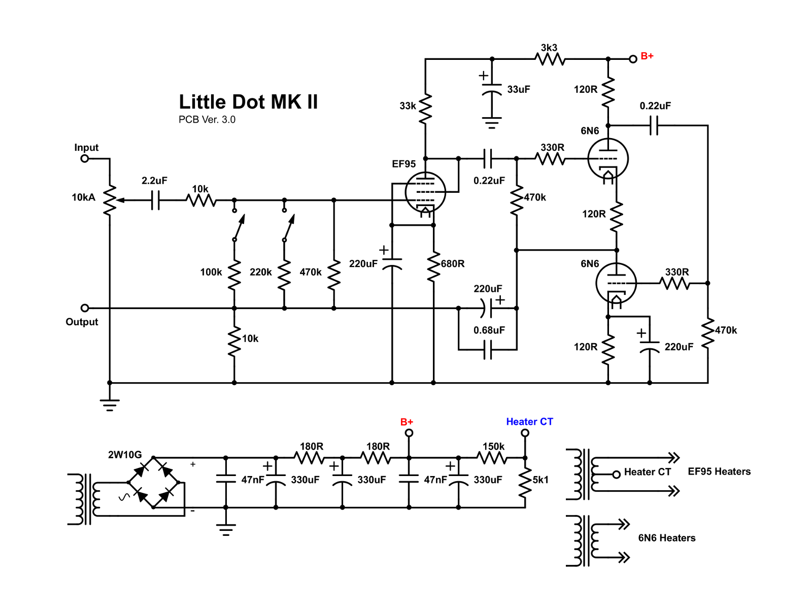

I also found that but unfortunately it's for the Little Dot MkII, mine is a Little Dot 2++ that's the older (and discontinued model). The lower part seems to be kinda similar tho, different values for the capacitors but the wiring looks like mostly the same.

Having given myself a very unpleasant shock off a capacitor, please be careful with them. I wonder if you have somehow disrupted the link to ground, so that the capacitors do not discharge when it is turned off, except through the circuit? If so, they can carry a surprising amount of energy for a surprising amount of time ;-/
Thank you again, I'm being careful with the capacitors. Btw my friend told me that the only way to be sure they are good is getting new ones, so I went ahead and bought the three big ones, we will try soldering them on when they come in.
Looking at them the solder joints seems fine, don't know how to know for sure tho, every capacitor shows 170V between poles like they did before I desoldered them so I really don't know what could cause the problem, I also tried the old tubes just to be sure I didn't damage them but there was no change.
Should I try testing the blue rectangular capacitors? Is it possible that I damaged the capacitors when desoldering them the first time? Even if they read fine with the lcr tester?
New capacitors came in, I soldered them aaaaaand now it's like I'm listening to unamplified signal, I can hear the signal I'm reproducing but it's very faint :S Tubes are getting hot but I don't know how to check if they are receiving a signal.
