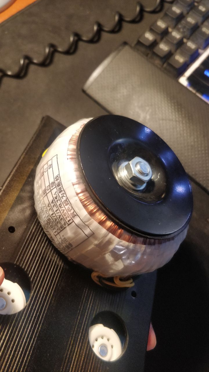

In your original post you said the vibrations came from the transformer ------ tighten up the nuts holding down the lamination's.
Its usually a case of inexpensive transformer design and "cures " include potting it with varnish.
Yes I have fixed this fault in cheaper mains transformers by tightening up the nuts holding the lamination's.
ok, I've thightened the bolt that keeps the transformer attached to the case of the amp. Today I'm getting a new 9V to power the LCR tester (the one I was using was reading as 7.12V and I don't think that's ideal), just to double check that the condensers are ok. I will then try to resolder them (friend that knows how to solder isn't available, aldready tried one time by myself, didn't go well) and see if the problem is solved.
In the meantime while looking at the board I found 2 jumpers, with a bit of googling I found out that those are a gain settings (a shame no one took the time to scan the manual of this amp back in 2006), right now they are shorted setting the amp to high gain, I'll try with them off and the amp set to low gain, I'm pretty sure that will help increasing the SNR.
While making the transformer more secure by tightening the bolt(s) attaching it to the case I was meaning the actual lamination's which make up the transformer they must be tight .
Is there no way of tightening them or did tightening the whole transformer to the case work ?
Ah, I dont know, the transformer is a toroid (photo attached) and I can't see any other screws/bolts, should I try detaching it?

Okay now I know its a toroid then Merlin is quite correct there should be a nylon/rubber composition circular insulated spacer between BOTH the top plate and the bottom plate .
This isn't just for reducing noise but an official approved engineering regulation to stop any chance of the steel plates shorting out the winding's in a case of overheating or damage to the insulation.
I have witnessed this before in a blown transformer --all black/burnt at the shorted point .
