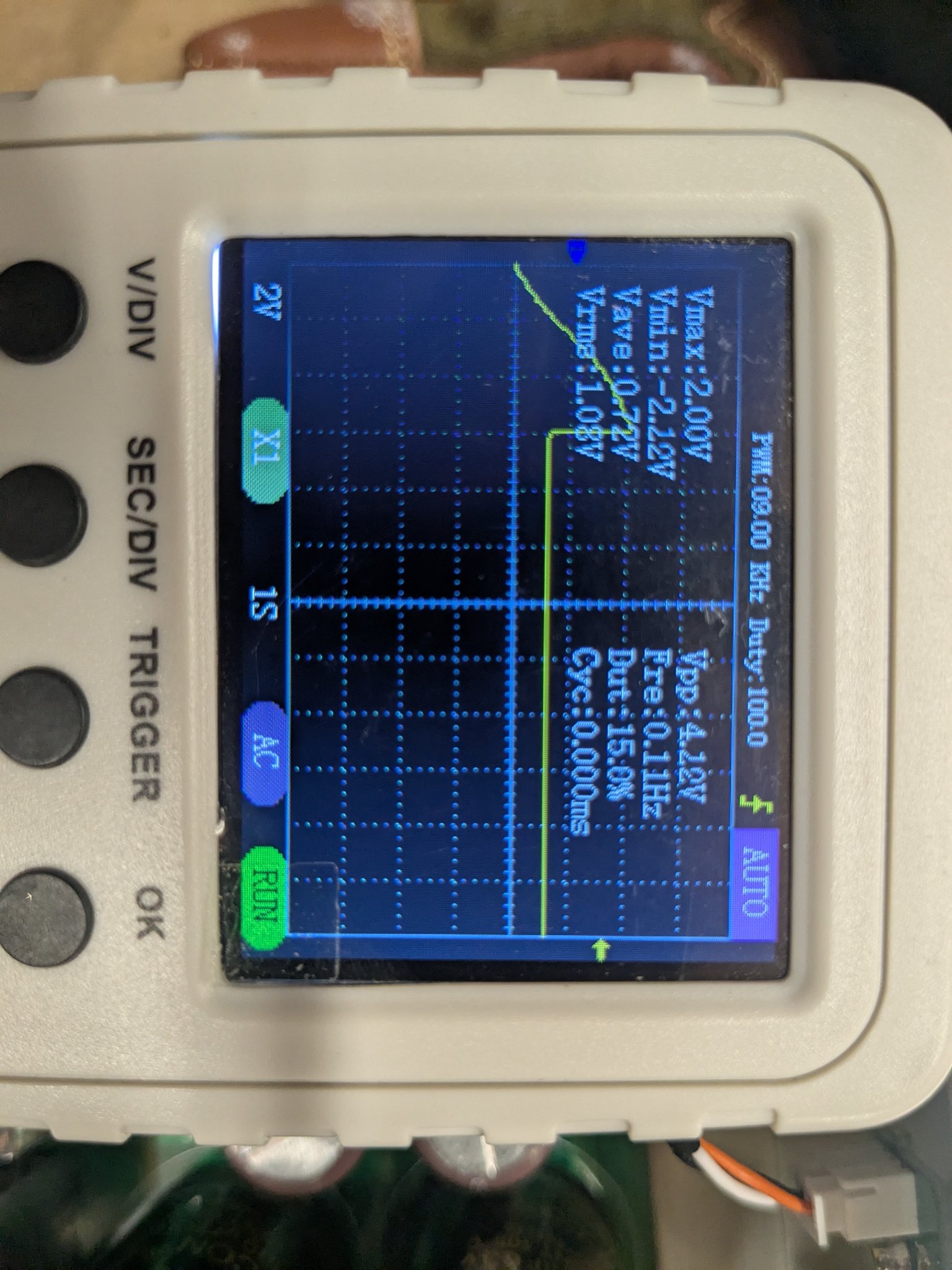

I did also run a 1000hz sine wave through the amplifier and hit it with the o scope. Results below. I cannot zoom in any further with thr cheap o scope. We have a good one in our lab but it's over at the office, not in the shop, so I can go check it with that on Monday.

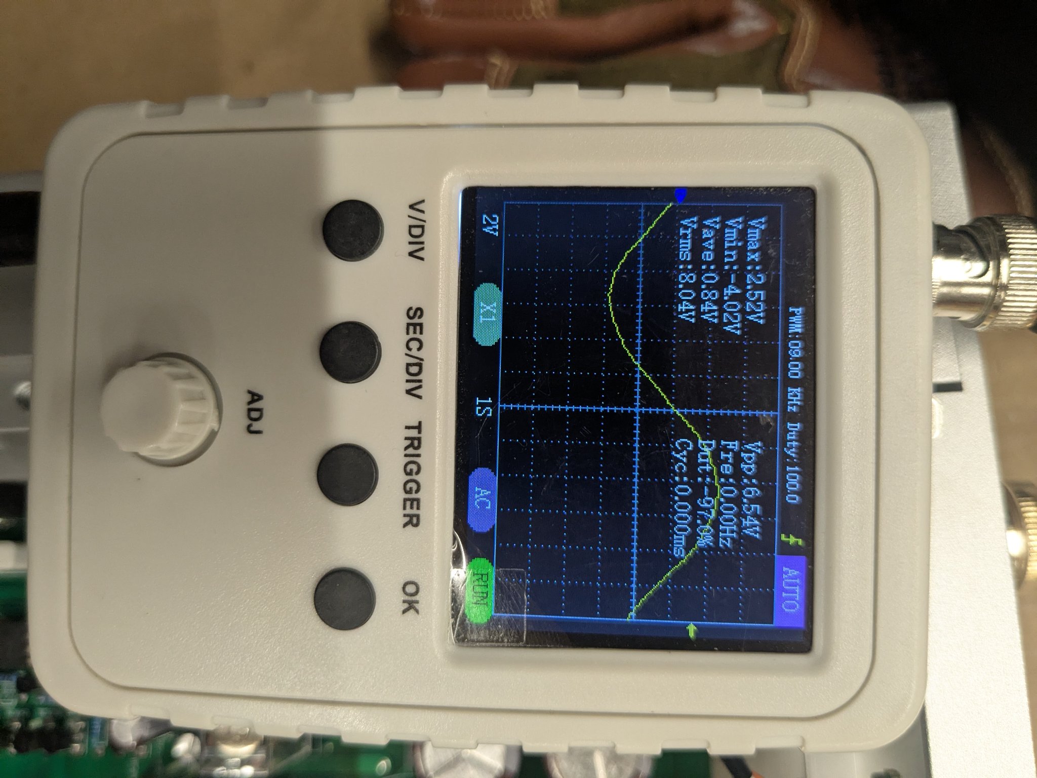

The second picture is right after the sine wave cut out.
A burned up zobel resistor suggests high frequency oscillation. Is the heatsink grounded to power supply ground? Grounding the heatsink sometimes corrects some oscillation issues.
At the time of of it burning up, no, the heat sink was not grounded the chassis. I was attempting to isolate various areas as I troubleshot the unit.A burned up zobel resistor suggests high frequency oscillation. Is the heatsink grounded to power supply ground? Grounding the heatsink sometimes corrects some oscillation issues.
