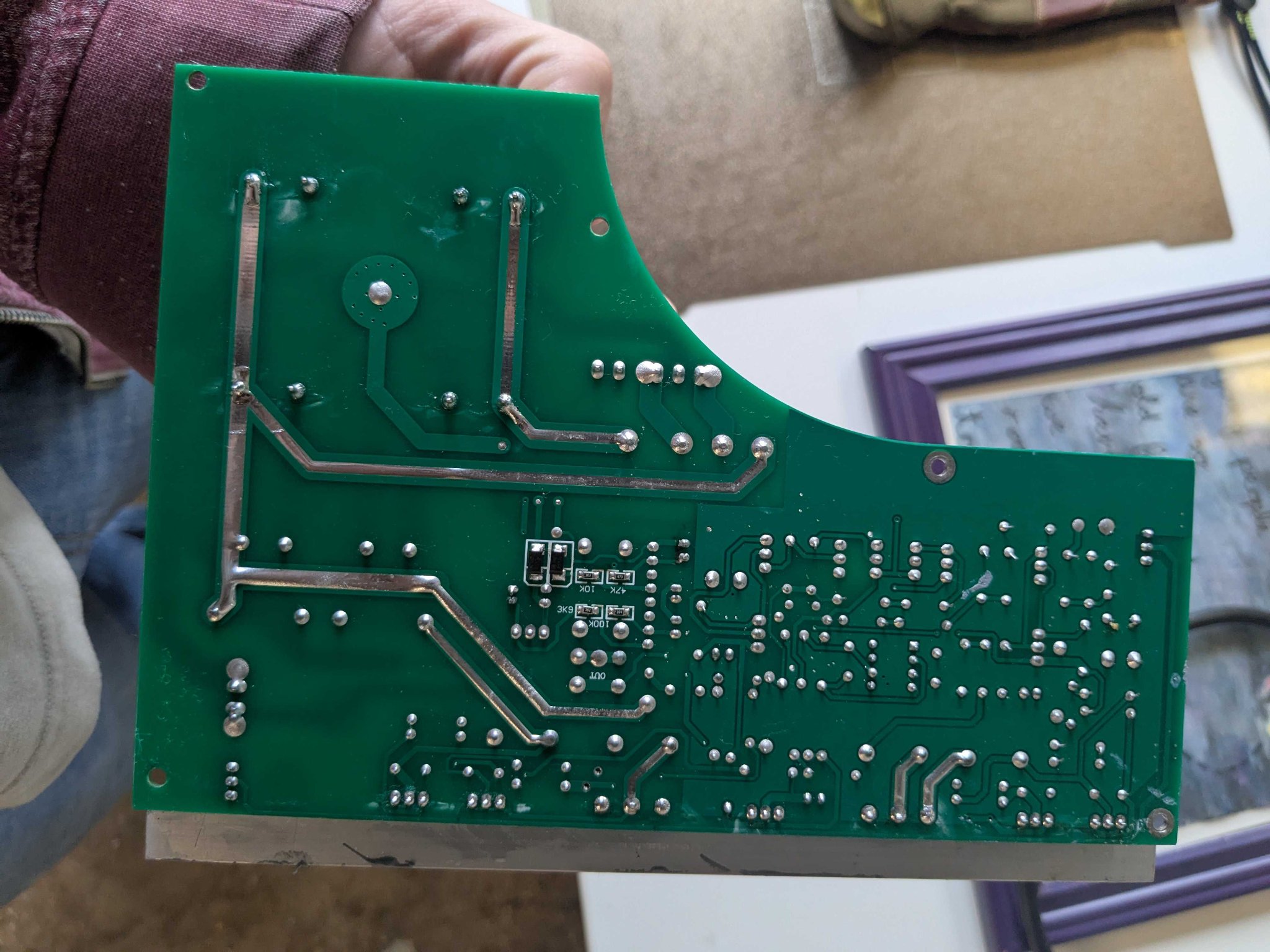

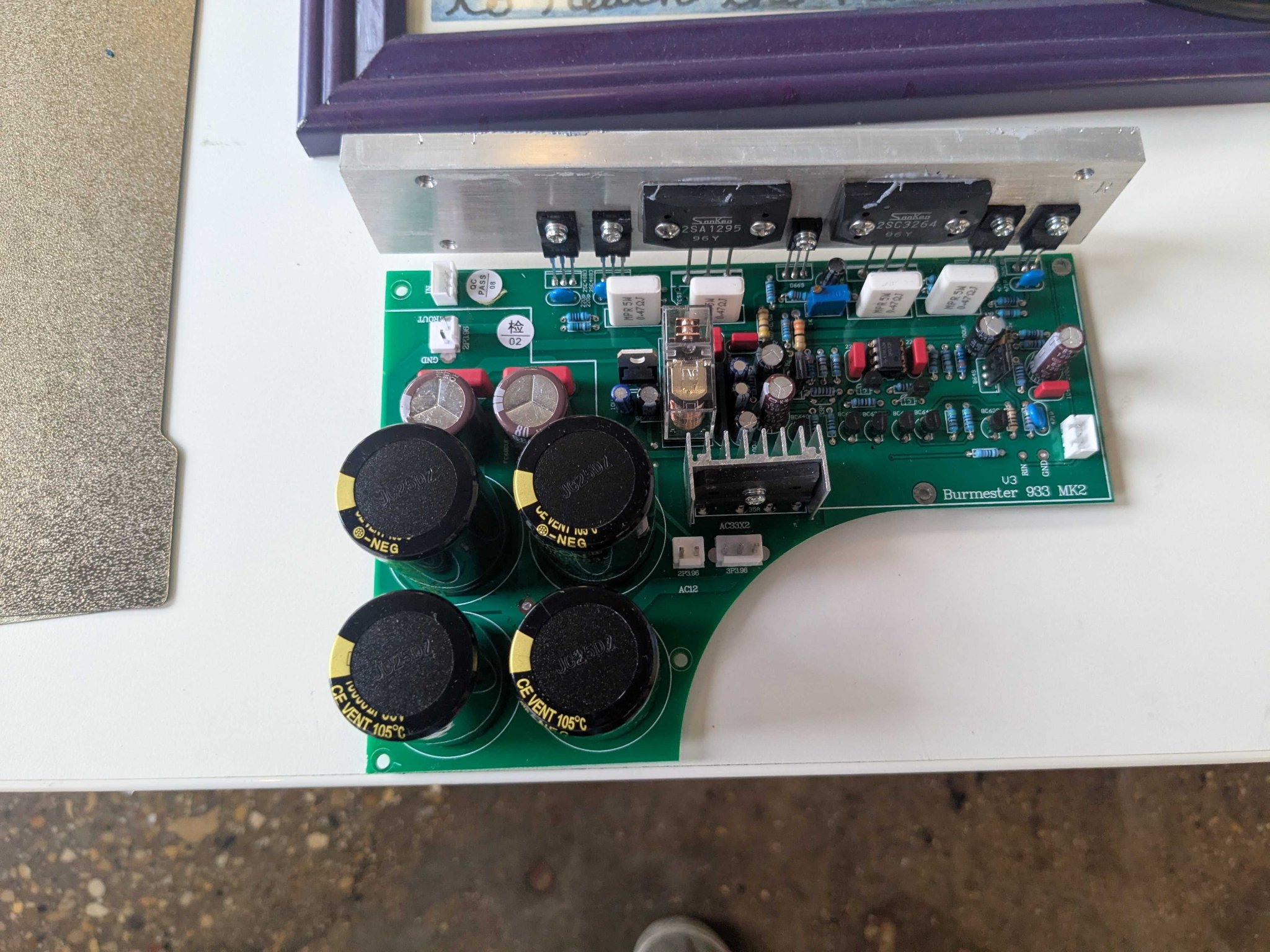

I have this cheap little class AB amplifier. I am getting a hiss through any speaker I connect it to. Both channels. I'm thinking bad transformer but I will run through my troubleshooting steps. It is HIGHLY likely it is a just a bad design and there is noise between signal and power on these boards, however, many have used this amplifier without this issue. BOTH channels hiss.
I do not have the schematic
Findings:
1. When it is whole and you power it up you can hear the power supply transformer hum. The soft start relays kick on once the caps are charged and then you start to hear the hiss. The sound from the transformer isn't that different from the sound through the speakers which is why this is suspect #1. The transformer makes no noise unless it is hooked up to one of the boards. I know class AB is always on and pulling some power even at rest so this makes sense.

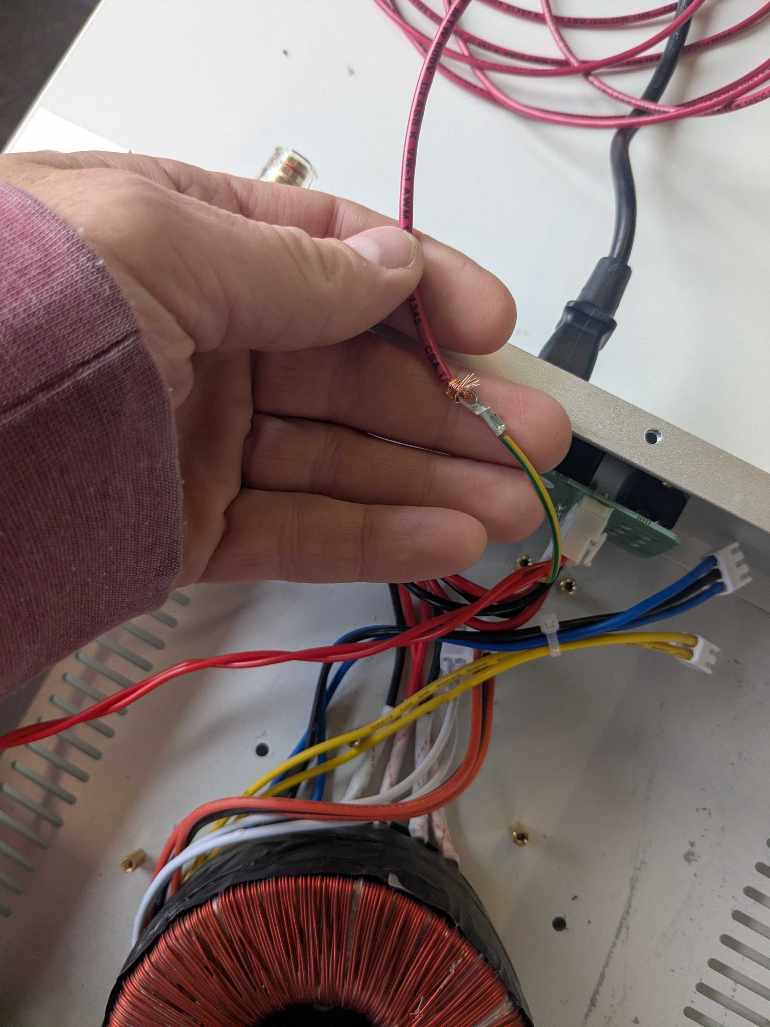

2. The hiss seems less noisy with the 120V input ground disconnected which is strange. If you scratch the 120V input ground on the chassis you can hear the scratching come through the speakers. This seems to point to a grounding issue in the design. This ground only goes to the chassis. This is suspect #2
3. There is a 3 pin volume pot for each channel. If I spin the volume pot with my head up to the speaker I can hear the sound of the pot turning coming through the speaker. I do not know how to bypass a 3 lead volume pot. I have disconnected the pot from the boards which seems to default it to the lowest volume level. The hiss is still present.
Things I have tried:
1. Disconnecting the volume pot - no difference
2. Separating the boards and moving them far from the transformer - no difference
3. Attaching the incoming 120V ground straight to the chassis and then to the building's conduit. I know the buildings conduit is a good ground as we have had to test this for other things we have built in the shop.
4. I soaked the transformer in polyurethane. I was hoping to quiet the actual mechanical noise of the transfomer. This also did not help.
5. I took a pencil and started tapping all of the components while it was powered and I could hear the hiss. Touching the components had zero effect on the hiss. I was hoping it might have been a badly seated/soldered component but that does not seem to be the case.
I open to try any suggestions at all. I have hooked this up in both my shop and my house and I get the same noise. I don't think its DC on the AC line since I have another class A amplifier that uses a toroidal transformer and I hear zero hiss coming out of that one. That one is about half the power but it has abosolutely no hiss at all.
The transformer is outputting 12v as well as two 35V leads to the board. Right now I am thinking its the transformer. Could be a bad batch of these cheap filter caps. I really do not have enough experience with class AB amplifiers to give any type of informed guess. Thoughts?

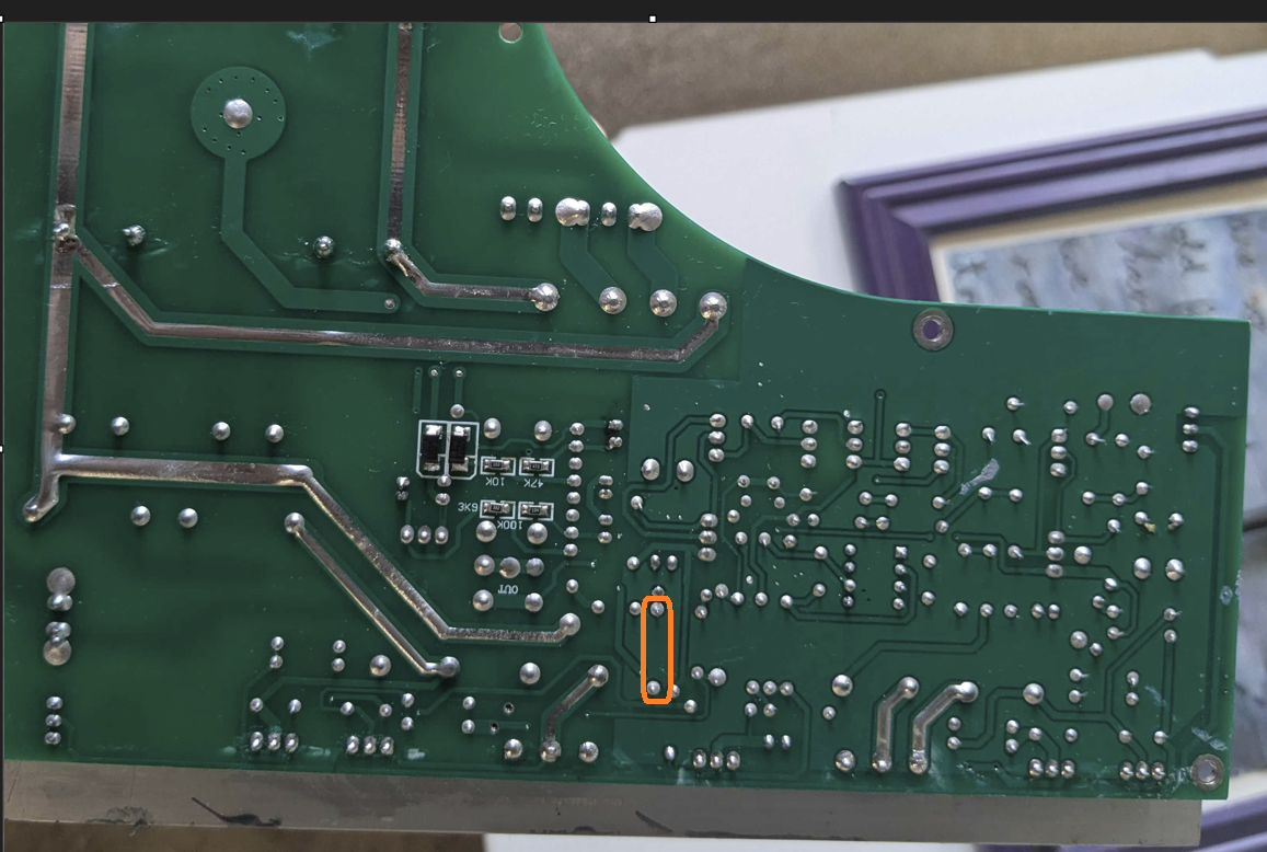

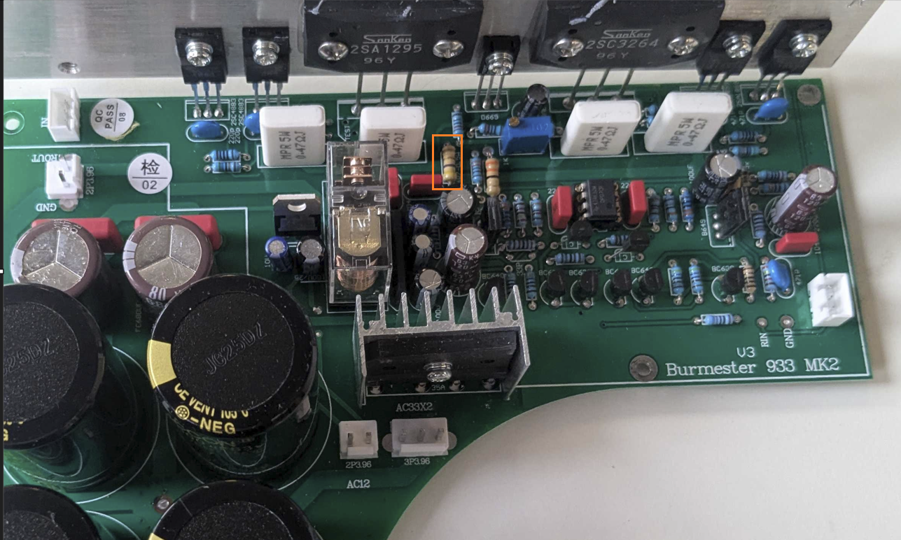

Sounds like you're dealing with a number of issues. I'd start by short circuiting the amp input. I.e., connect the RCA centre conductor to the RCA shell. Does the noise persist? If so, it's something in the amp.
Tom
Tom
I actually tried this. It burned up a resistor on the board. I replaced it with another 4.7 ohm 1/2w I had laying around so its fine. I have done this on other amplifiers before without that result but I think this is bad advice to give to people. I could see how this happening to someone else could be a big problem.I'd start by short circuiting the amp input. I.e., connect the RCA centre conductor to the RCA shell
If shorting the input causes damage to the amplifier - especially damage indicative of oscillation - there is something wrong with it. It’s not supposed to do that. Shorting the input as part of diagnostics is not bad advice. Doing so without monitoring or limiting current draw is. The oscillation that burnt up the resistor would have lit up a dim bulb.
I don't doubt there is something wrong with it. I just cannot figure out what that isthere is something wrong with it
Did you read correctly: short the input of the amp. That essentially means no input signal.I could see how this happening to someone else could be a big problem.
