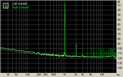

But they do, no way to cheat them, when we speak about correct replay. But you have to do it. Sometimes we say: "JUST DO IT"
The small problem is that the result with Realtek or similar onboard chip will be "not nice", if I stay on polite side 🙂
  • RightMark Audio Analyzer test _ [MME] Wave mapper Realtek.pdf

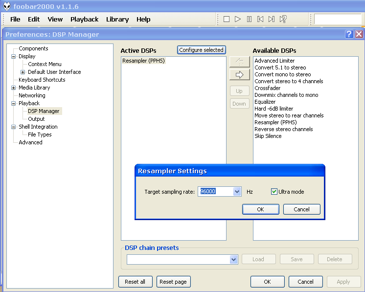

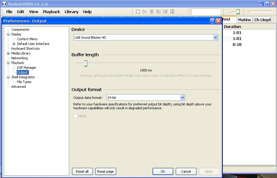

With my D/A system, only the attached setting gives spectrally pure results and also best sounding. Everything else adds unwanted digital artifacts.
