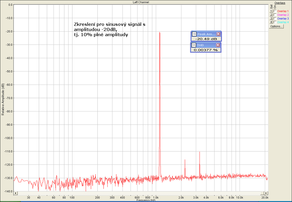

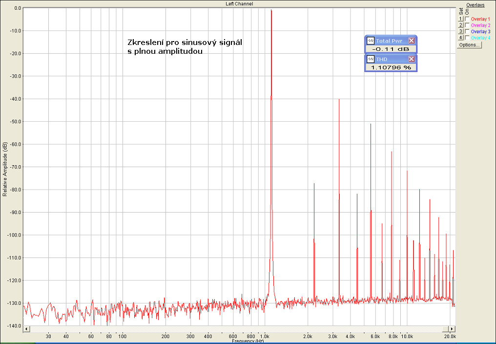

Frank, I already went through this path, on our local forum. With digitally added non-linear distortion only, almost no one was able to catch any difference, up to quite high distortion FS level of different patterns. You may see some distortion profiles attached, showing decreasing distortion with level. The distortion was added purely mathematically. I still have the files to test.

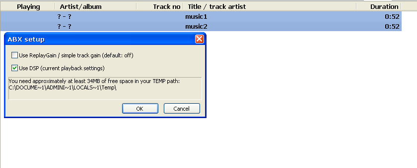

Step 2 of ABX workaround: Used orig.wav, and copy of that as ABX pair. Started ABX, and then used Audacity to resave one of the temp files as a 24 bit, compared to the other, 32 bit, otherwise identical file. Then kicked off ABX ...
Immediately, obvious difference, in foobar: the 24 bit played much closer to what the sound was in Nero, better treble, very distinct change in tone switching A->B and B->A mid-track. Confirmed that I was dealing with the right file by renaming the adjusted temp, which I guessed corresponded to B - B then wouldn't play.
So, should have a better chance now - simply redo the ABX temp files, to 24 bit tracks, before trying a run - will see how that works out ...
