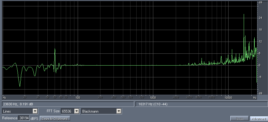

Pavel's use of difference file technique resolves temporal aberration. Under better controlled conditions it may reveal underlying transfer function characteristic. Here it primarily reveals only aberrations of original recording and the recording's rendering process. This is partially responsible for lumpy mess around 4kHz seen in his posted difference file spectrum. Lack of perfect temporal alignment is also big factor. This picture also shows lack of content below 60Hz returning what is effectively a noise result that precludes resolving the high pass aspect of the devices under test, and of the D/A and A/D units in the test chains.
Difference file technique is a direct form of correlation. Difference results need only be long enough for spectral analysis. Pavel's window is 65536 samples, quite adequate for audio spectrum of 48kHz sample rate. Movement of window across different regions of result file yields very stable result.
Nico mentions cross correlation. Here too complete files need not be analyzed, bringing solution easily within realm of PC. Division of spectra from same sample region returns flattened spectrum for the stimulated bandwidth. With B/A result look like this:

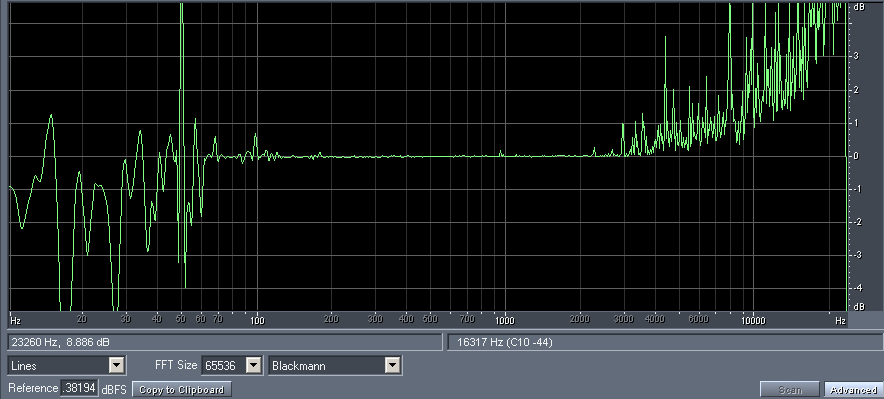

And zoomed in:
The above two pics tell essentially same story as Pavel's pic.

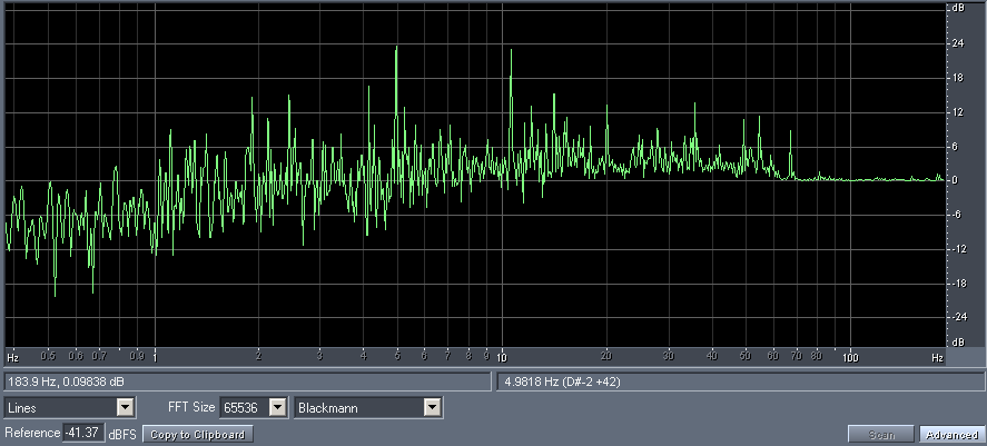

Sample rate conversion to fs 375Hz allows 65k spectrum to look at low frequencies:
Smoothing could be applied to the above and would reveal some manner of low frequency high pass filter, but it would not just be that of differences of devices under test. It would include convolved response of both D/A and A/D converters.
