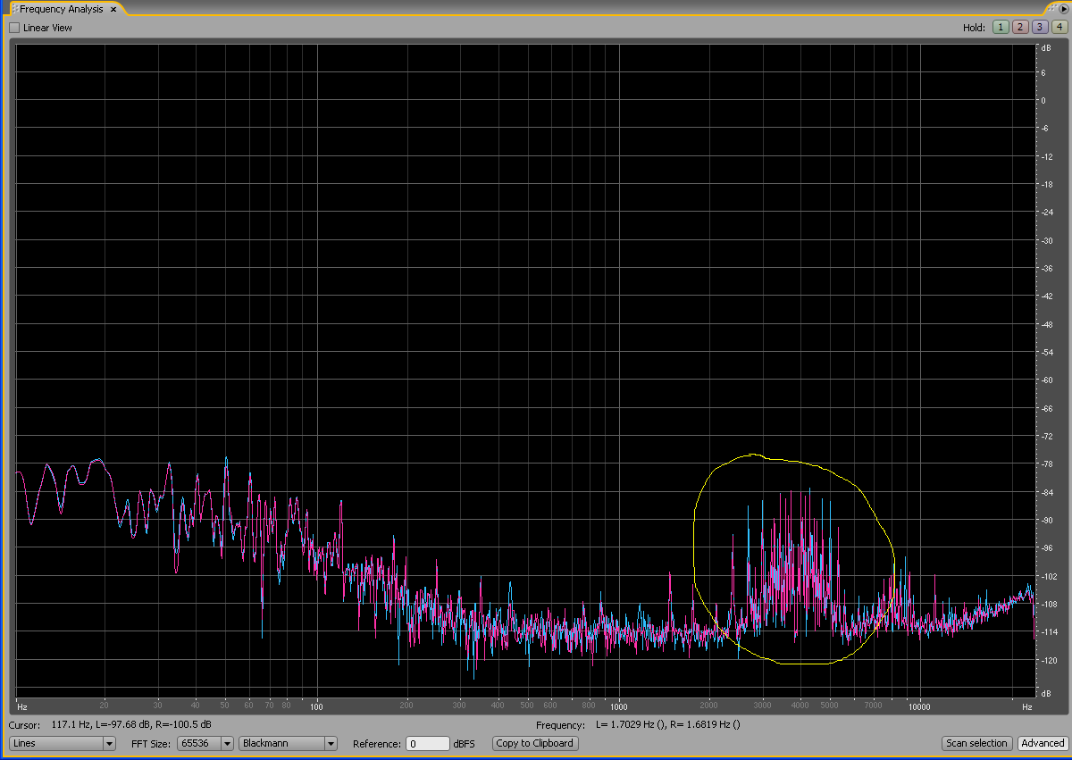

File alignments differ by 3-68 samples.
Not enough spectral energy below 70Hz to get good approximation of linear transfer function.
Noise modulation for D/A A/D and 16bit depth effectively masks potential differences.

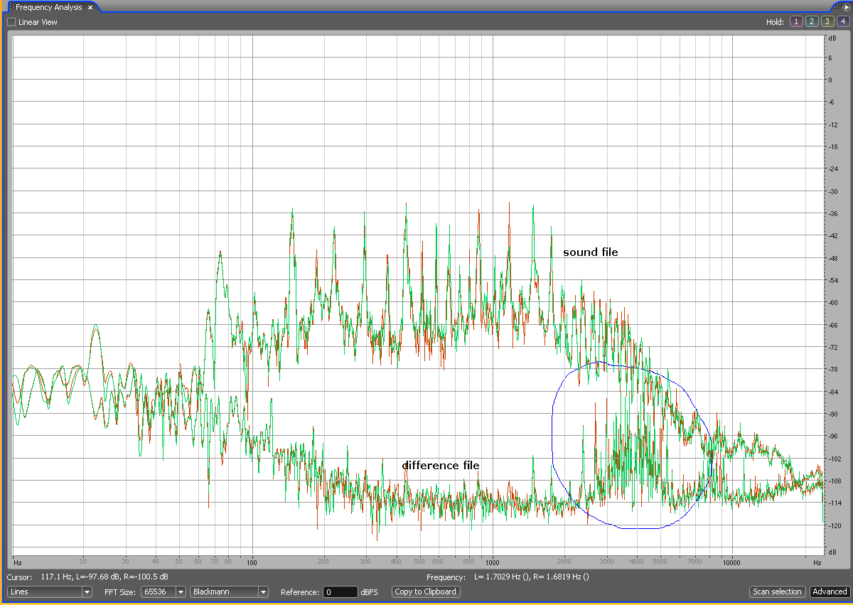

The difference is mostly in a very sensitive part of audio band. Do you have any idea what it could be?
A or B files are not same to any of the further 12 files. There are ALWAYS differences. The difference can be seen both in frequency domain and sample values. Attached is the difference in 1st 3 second between A and B in frequency domain. In time domain, "B" is a bit compressed compared to "A".
I can only say that the files sound same if they are same. I assume I have proven the difference by my ABX result. How can we 'pair' A or B to other files if any of them is different???

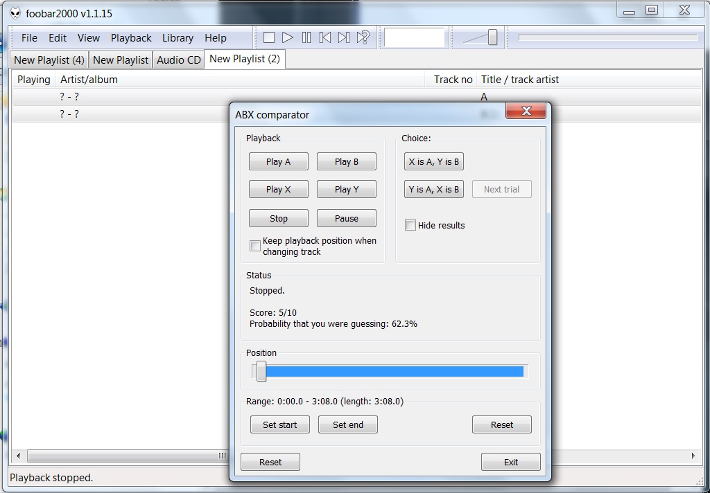

Tried with headphones, computer DAC and background noise:
PS Here's the Foobar ABX stuff if you want to try:
foobar2000: Components Repository - ABX Comparator
Double click to install, then highlight two clips and right click and utilities and 'abx'
You can play the two files (A and B) and then X and Y (randomized A or B) and then say A is X or A is Y. Wash and Repeat until you move from lucky/unlucky guessing to statistically significant preferences (~10-15 tries).
It can restart from the 'beginning' (good to target specific sounds) or switch between perfectly synchronized tracks (good for overall, "wholeistic' ).
Interesting result 😉
