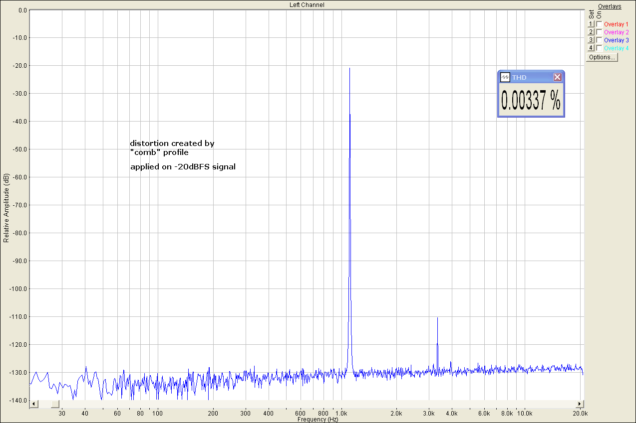

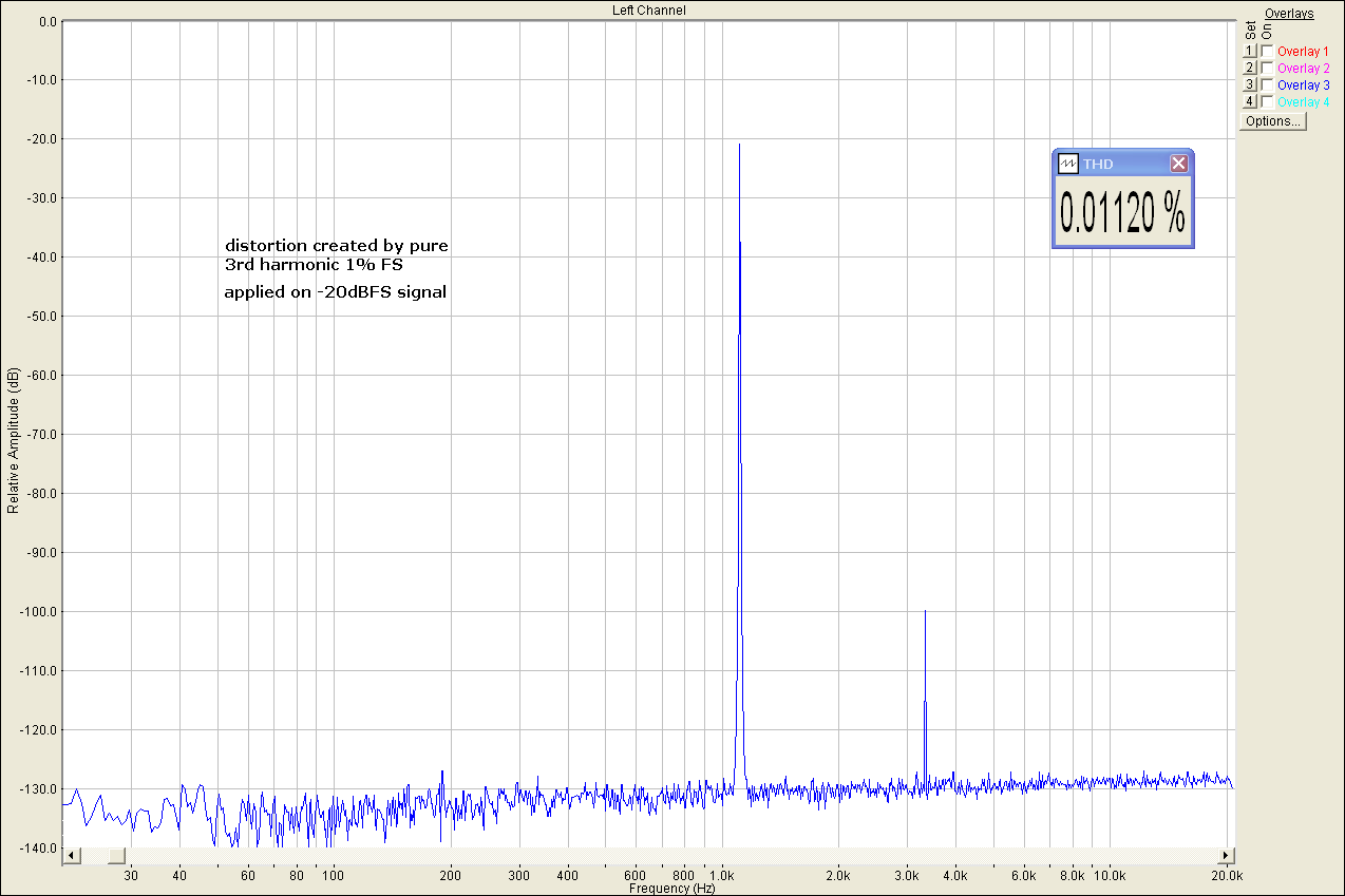

No, because at lower signal level the "comb" distortion profile creates only 3rd harmonic (with very very low amplitude), as you can see from my plots at -20dBFS signal posted earlier.
Yes I see, 90 db down compared to 80db for the pure 3rd. A very interesting test.
Thanks Pavel, Just looking at the graphs without analysing them properly the one with the comb of harmonics looks like it should be higher in overall distortion. But when you look at the db levels (and the fact that db's are logarithmic!) then the situation changes.
I wasn't previously aware that just a single harmonic could cause such a mish mash of additional intermodulations.
It is very interesting that in a situation with a predominat 3rd harmonic, with virtually no other harmonics it will sound worse (and as though there are many other harmonics added) than a distortion with many odd harmonics starting about 10db lower but at decreasing levels. This is not something I realized before.

I think there's a gocha, though : both wavs were generated with input signal at full scale... and the test music is pretty hot...
However, if the device under test was an amplifier (or anything after the volume control) and/or the music was quieter (ie, the quiet parts of a classical piece), then the signal amplitude would be much lower, and ...
- the pure H3 transfer function would produce a lot less of it
- however, the crossover-style transfer function would produce pretty much the same amount of distortion, which relative to a much smaller signal, would be a lot uglier.
A way to test this would be to add some attenuation before and some gain after your distortion generator (I suppose everything runs in double precision, so this shouldn't cause numeric problems)....
However, .... and/or the music was quieter (ie, the quiet parts of a classical piece), then the signal amplitude would be much lower, and ...
I am sorry, but this is not true, and I must repeat myself and attach again the distortion result for -20dB amplitude. You need to take into account absolute values of harmonics as well and not only the distortion profile. Popular magazines have done a lot of bad job in this respect, supported by some "gurus". I need for you to check my second post in this thread and also the fact that THD of 3H distortion is 1% and THD of comb distortion was 0.36%, both re full scale amplitude.

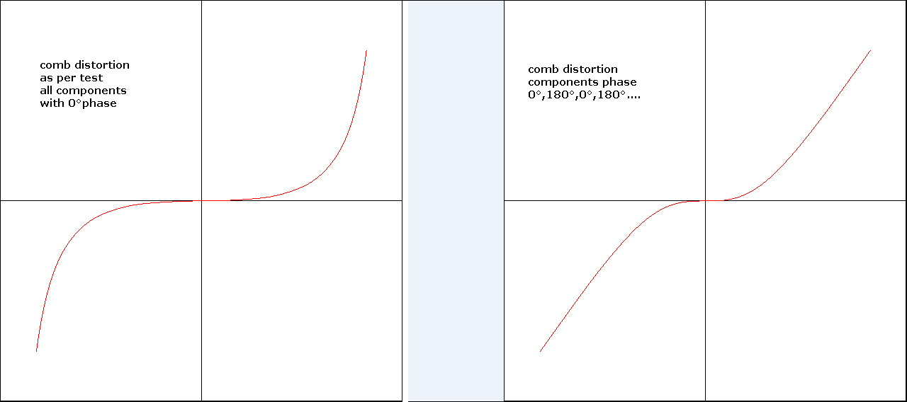

Phasing of harmonics has likely impact too.
Excellent comment. Under test, all comb components had 0° phase. When phase of components is flipped 0° and 180°, we get transfer function deviation from straight line as attached, with much higher impact at low levels.
