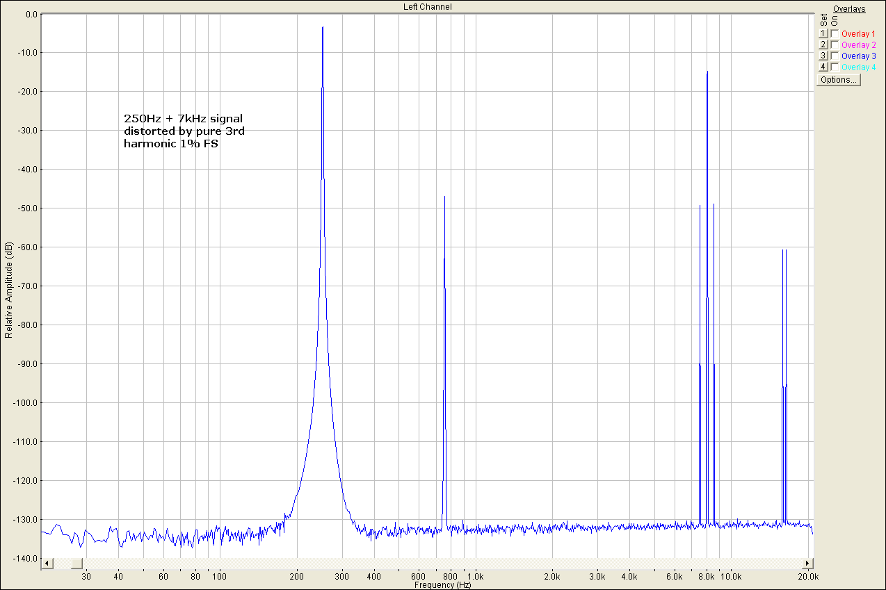

Here is the distortion of 250Hz + 7kHz signal distorted by pure 3rd harmonic 1% FS. Of course harmonic distortion creates intermodulation distortion as well, they both are only different visualization of the SAME non-linearity. The IMD here is 0.97%.
3rd harmonic at 1% FS and higher is definitely audible.

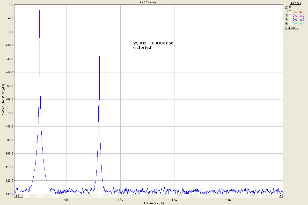

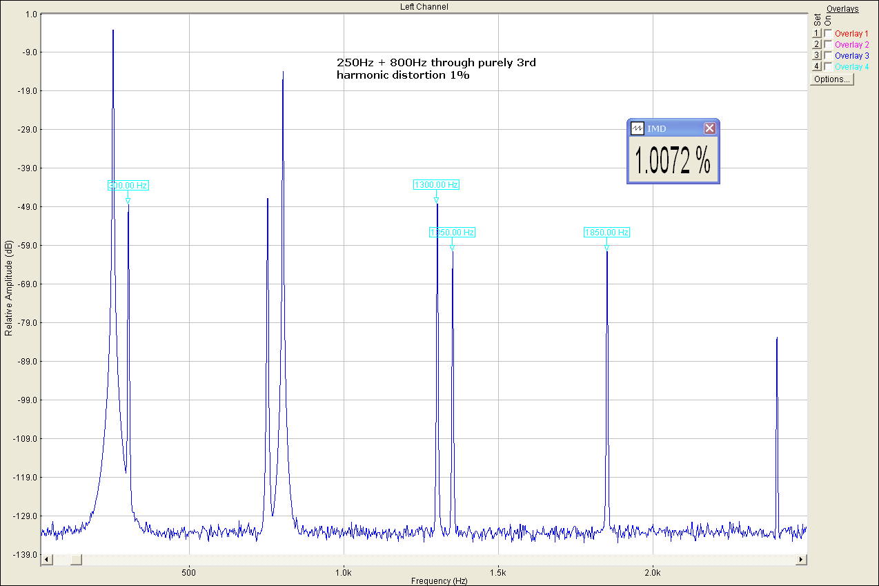

With same purely 3H distortion, we can see what happens with two originally 250Hz + 800Hz twintone. New, non-harmonic components can be seen quite distanced from original tones.
It is a general belief that 2nd and 3rd harmonic are audibly innocuous. I am sure, that above certain level it is not true. They create harmonic tones ("tuned") only in case of a single tone. When a simple single instrument like flute is reproduced, it probably only changes a tonality. But in case of more complex music + voices even 2nd and 3rd harmonic, above certain level, create audible mess and worsen the resulting sound.

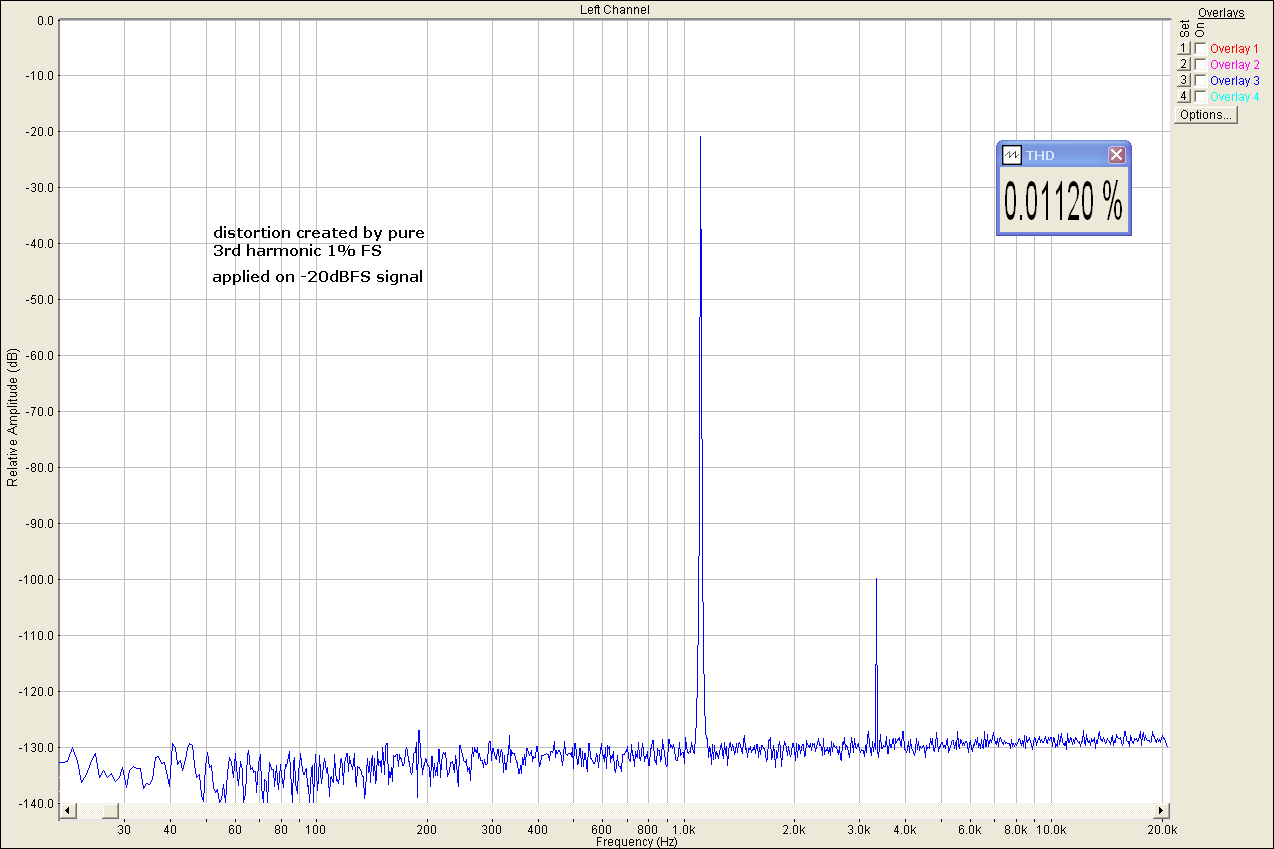

music1 ... added pure 3rd harmonic distortion of 1% (-40dB) at full scale amplitude. This makes the biggest audible difference when subtracted (after very careful alignment) from the music file. The distortion at high amplitudes becomes quite audible and creates audible intermodulations. Please check the difference file I posted yesterday, it is the music2 - music1. I would call this music2 file as "more distorted".

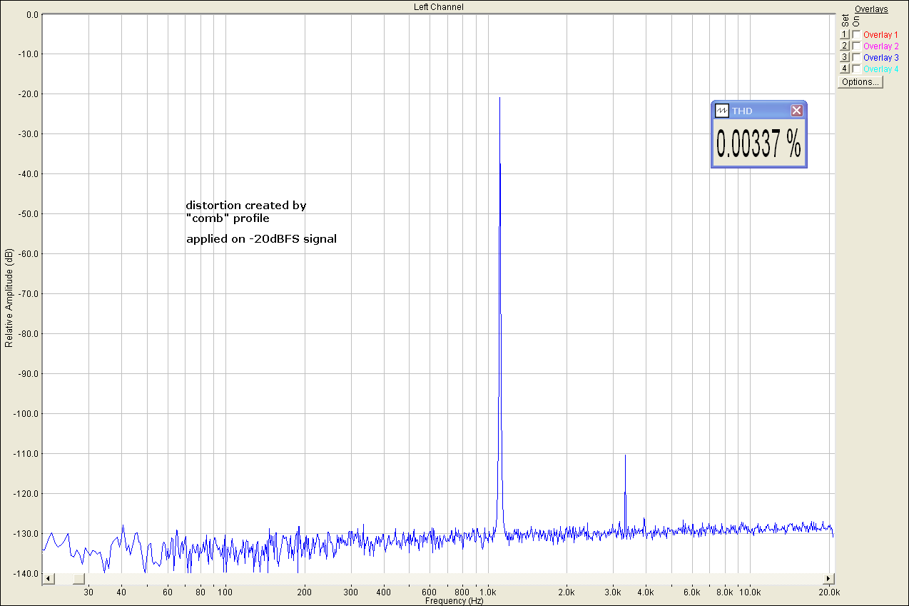

Remember this is all referred to full scale. I will show that at -20dB of signal amplitude only one component remains.
This distortion creates less audible artifacts that the pure 3H -40dB distortion, so I call it "less distorted".
I have realized to evaluate only your subjective impressions, expressed as "more" or "less" distorted.
In this post, you will see my "3H distortion" and "comb distortion" how it applies to -20dB signal. You can see, in both cases, there is only the 3rd harmonic component. Everything else is below 16-bit (dithered) resolution. The "comb" distortion 0.36% profile creates much lower 3rd component, than the 3H 1%. Subjectively, the "comb distortion 0.36% FS" is less audible than "pure 3H distortion 1% FS".

I would completely agree if the distortion amplitudes resulted in both files in 1% FS
As the 3H had -40dB at 3H distortion file,
and 3H had -50dB at comb file and higher were decreasing with rate -10dB
The comb distortion was less audible.
