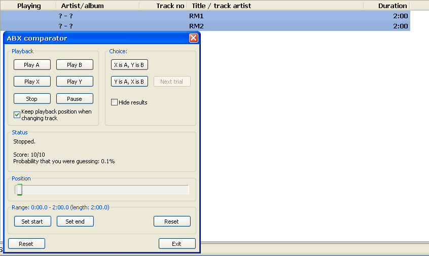

The difference is soo huuuuge in this test. I am posting a 10/10 ABX result, but would make 100/100 this time.
Briefly:totally different space. Voice is almost in the middle for RM1, but shifted right in RM2. Different tonality, different soundstage. What are those horrible power amps under test? 😀

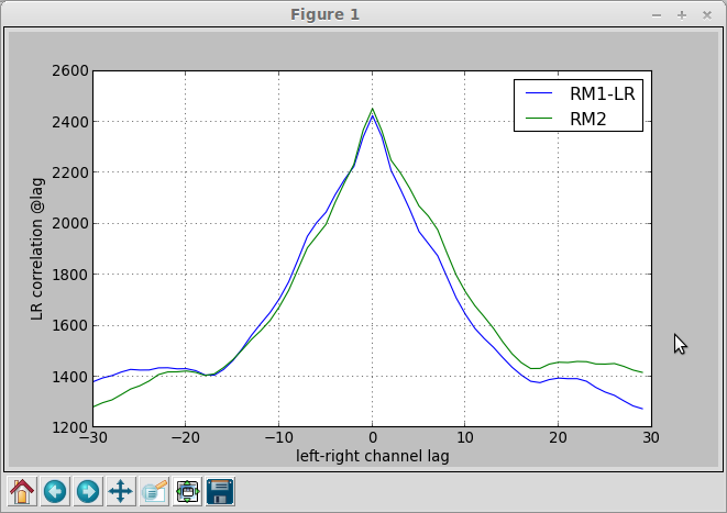

You are right spiri, channels are probably reversed in one of the files.
I just peeked at the waveforms in audacity and you are right.
I reversed the L/R channels of one WAV in audacity, ABX is still very easy, the voice moves in the other direction... but it still moves as much...
I have not got the point of this test. The files sound VERY different, they are easily distinguishable. Is it an intent, or amateurism (swapped channels).

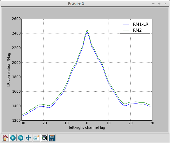

The ABX I did earlier after de-inverting the channels was wrong, I had actually not inverted the channels. Fixed.
Now, comparing the two files, the voice does not move left/right anymore. But the differences in imaging/ambience are enough to score 100%...
Here is the interchannel correlation for both files, with channels fixed, this time it looks really identical.
