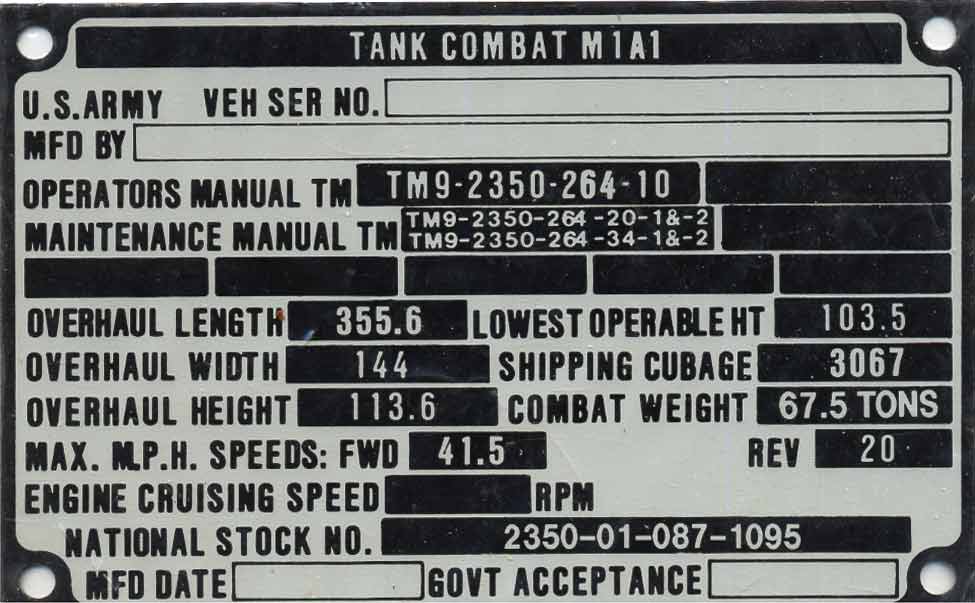

Uncle Jed -- I think that it goes on the side of this:

67.5 tons. That would have made a nice mobile base for my DIY VAWT project!!!!!

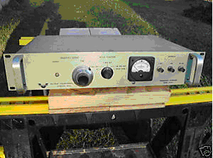

My humble bench just got another piece of equipment. It's amazing what I've acquired lately. The most interesting is also the best deal out of the bunch. Paid about 1/10 of top condition value.
A vintage
VECTRON FS-323 FREQUENCY STANDARD for $48.11
Its a once high-end quartz frequency standard with a crystal oven. The unit features front and rear panel BNC type outputs for three frequencies: 5 MHz, 1 MHz and 100 KHz. The front panel meter has a function switch allowing the meter to monitor the following; B+, 5 MHz, 1 MHz, 100 KHz, and crystal oven temperature.
Well, this is the 1st one I've ever seen.
Does anyone have any knowledge about one of these, any hints on 'where' to obtain documentation (op/service etc) . Bet I'll have to seek out a Ham operator or PMEL-Metrology professional.

Gee I have one of those myself. Got it back in the 1980's from telco surplus. Like new in a roadcase. Mine runs off the -48 volt telco battery supply. I have never used it beyond initial trials to see if it worked, it does, and do not have documentation.
These could be used as a master frequency/time reference in a system or lab. Many frequency counters and such have inputs for an external clock such as this Vectron unit.
You could own a second unit if you want for another $50.

nice, where do i get one...... i've been looking for a good off-road vehicle...... wouldn't mind having it on the highway during rush-hour traffic either.........

that's a secondary transfer standard. calibrating it requires a secondary standard with a WWVB-locked oscillator or an OMEGA or LORAN-C (these days maybe even locked to a GPS receiver) locked oscillator, all of which are receivers with phase locked crystal ovens. zero-beating it against WWV on a shortwave receiver will get you in the ballpark, but the "ballpark" i'm talking about is 1 part in 10E7 or thereabouts. i don't know what the published specs for your freq standard is, but if i remember correctly, it should be about 1 part in 10E10. the phase locked receivers are generally around 1 part in 10E11 or 12. i think the standard needs to be running in a room with a stable temperature of about 70F (25C) for 24 to 48 hours before beginning the calibration. all of that info should be in the manual or in a calibration manual, and it should get a calibration if any work has been done on it, except for maybe minor repairs like replacing a power switch or indicator bulb.
