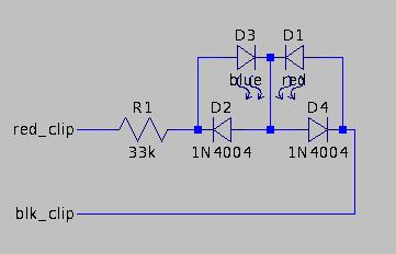

where i work, we regularly get Klipsch powered subwoofer amp modules for replacement. along with the amp module comes an LED with 3 wires, one side is blue the other side is th red LED and the center wire is a common cathode. with a couple of 1N4004's and a 33k 2W dropping resistor, and a pair of clip leads, i made one into an "offset sniffer". regularly Pioneer, Yamaha and Denon amps come in with blown channels, and the protection mode only allows a couple of seconds before tripping the power relay off. so hooking up the sniffer to the output lead to each channel and cycling the power makes it easy to go through a 7.1 surround amp and find the blown channel without getting confused by the slow sampling rate of a DMM flashing nearly meaningless numbers (the chances of a DMM sampling exactly when you want it to is slim to none (and Slim is out of town)). a solid red or blue LED while the power is on is a quick indication of a bad channel. it's much more portable than a scope, and not all the techs where i work have one at their bench, especially the "triage" techs the 1N4004's are for "steering" the applied voltage. the device comes in handy for checking for the presence of DC voltages, as well as checking for output signal at the speaker terminals (it glows purple in time with the music). the LED's turn on at about 3V, so it can test for the presence of 3.3V rails, on up to the power supply for the amp.
...an LED with 3 wires, one side is blue the other side is red LED and the center wire is a common cathode..with a couple of 1N4004's and a 33k 2W dropping resistor, and a pair of clip leads, I made one into an "offset sniffer".
Excellent!
Another fine example of a CHEAP tester!
I will add one of these to my "arsenal".
Thanks uncle jed!
-Chas
I once made something similar but with two bright LEDs in inverse parallel and in series with a 5w, 15k resistor. Works nicely from 5v to 240v, AC or DC. Add another circuit with a neon bulb in series with a 150k resistor to indicate high voltage.unclejed613 said:where i work, we regularly get Klipsch powered subwoofer amp modules for replacement. along with the amp module comes an LED with 3 wires, one side is blue the other side is th red LED and the center wire is a common cathode. with a couple of 1N4004's and a 33k 2W dropping resistor, and a pair of clip leads, i made one into an "offset sniffer". regularly Pioneer, Yamaha and Denon amps come in with blown channels, and the protection mode only allows a couple of seconds before tripping the power relay off. so hooking up the sniffer to the output lead to each channel and cycling the power makes it easy to go through a 7.1 surround amp and find the blown channel without getting confused by the slow sampling rate of a DMM flashing nearly meaningless numbers (the chances of a DMM sampling exactly when you want it to is slim to none (and Slim is out of town)). a solid red or blue LED while the power is on is a quick indication of a bad channel. it's much more portable than a scope, and not all the techs where i work have one at their bench, especially the "triage" techs the 1N4004's are for "steering" the applied voltage. the device comes in handy for checking for the presence of DC voltages, as well as checking for output signal at the speaker terminals (it glows purple in time with the music). the LED's turn on at about 3V, so it can test for the presence of 3.3V rails, on up to the power supply for the amp.

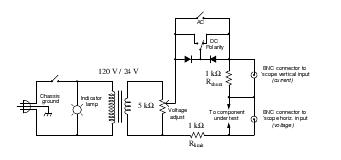

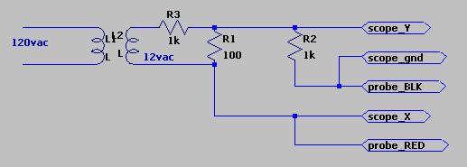

i was going to build the curve tracer adaptor that uses an AC source like a 6v or 12v transformer and a few resistors and a couple of scope inputs to test components in-circuit. i know i can find a few 12V standby supply transformers floating around, only need a few milliamps.... yeah..... kinda like this......
hmm.... got the schematic off the web in a pdf..... something don't seem quite right here.....
or burn a disk with various test tones on it. i can make whatever i need for .wav files using LTSpice's .wav out function to build sound files. there's even a frequency modulator function to make sweeped tones or stepped tones. the same function block also has an AM input, so i can make stepped amplitude signals or swept amplitude signals. i add a pot to the cd player output so i can get a variable amplitude on standard test disks that have 0db tones on them
