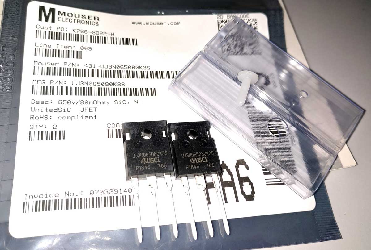

New Toyz!
Edited to add - Tracking Mouser inventory in my area. Currently 450 available. How many gone before ZM publishes a circuit? How many months wait for inventory back in stock after the circuit is published?

They will probably sound better when they get unobtainable.
Oh those Russians...(C)Boney MYou mean this one? 😉 I know, I know, everybody and their dog have seen it already…
Too funny, I had these in my cart last week but deleted them as I thought the high Vgs may be troublesome...let us know how they work. I may have to get a few and see how they look on the curve tracer.
