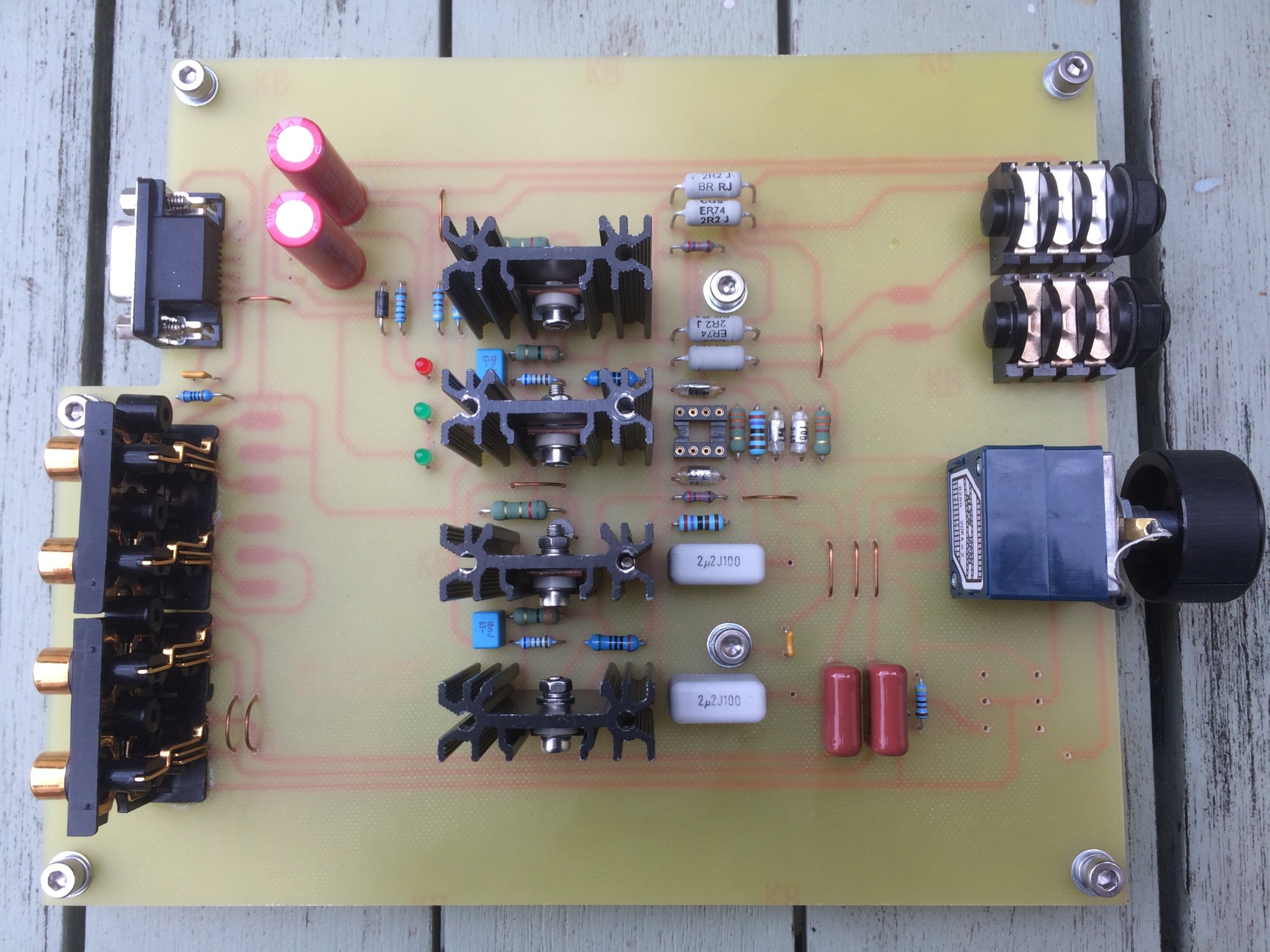

@starcat Where can I find BOM and build guideGet Kevin Gilmore's CFA3 and stop bothering.
@baggerbole could you please tell me where the find build plan and BOM for CFA3Hi starcat, do you have more information about the CFA3. May be a link or an instruction guide?

There is no build plan. You populate the PCB by looking at the silkscreen and cross-checking with the schematic. I have a BOM but it's probably out of date by now.@baggerbole could you please tell me where the find build plan and BOM for CFA3

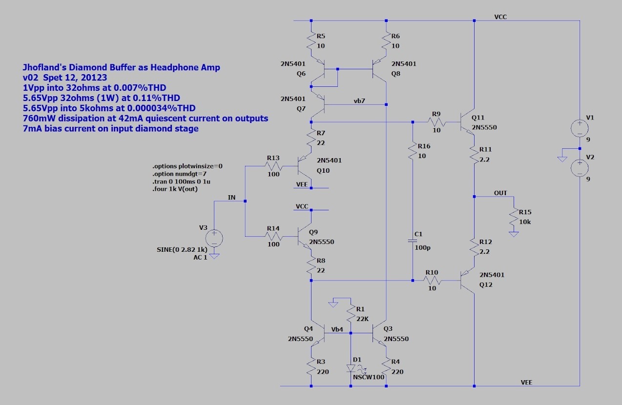

Jhofland recently designed for me a push pull diamond buffer output stage headphone amplifier with an opamp input stage in a nested feedback composite amp. It has direct coupled output and runs Class A for the first 50mw and can produce up to 1W into 32ohms (Class AB).
Here’s the schematic for the output stage. I’m using 2N5551 and 2N5401 models but actual outputs are SOT223 FT953/853. A green LED is used to control the CCS:

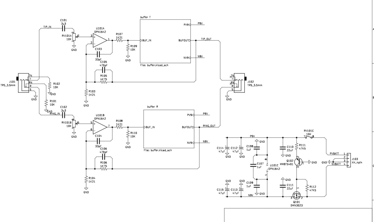

Here is the schematic showing the diamond buffer in a nested loop composite amp with an opamp providing 12dB gain, and a small circuit to enable turning on negative rail when the positive one is turned on with the volume pot click switch:

Good afternoon, xrk971. Can I repeat your project?
Very intrigued. I want to use it with headphones Sivga Audio P-II
If possible, I would like to ask you something.
1. I see you used a dual transistor instead of two single ones 2N5401. What is it called?
2. Is there anything else that I need to finalize in the scheme? In addition to adding an RC lock scheme.
The dual parts are DMMTxxxx. I use DMMT5401-7 and DMMT5551-7 parts. The SOT-223 power transistors are FZT953 and FZT853 - nice units capable of a lot of drive. The complete BOM is here.

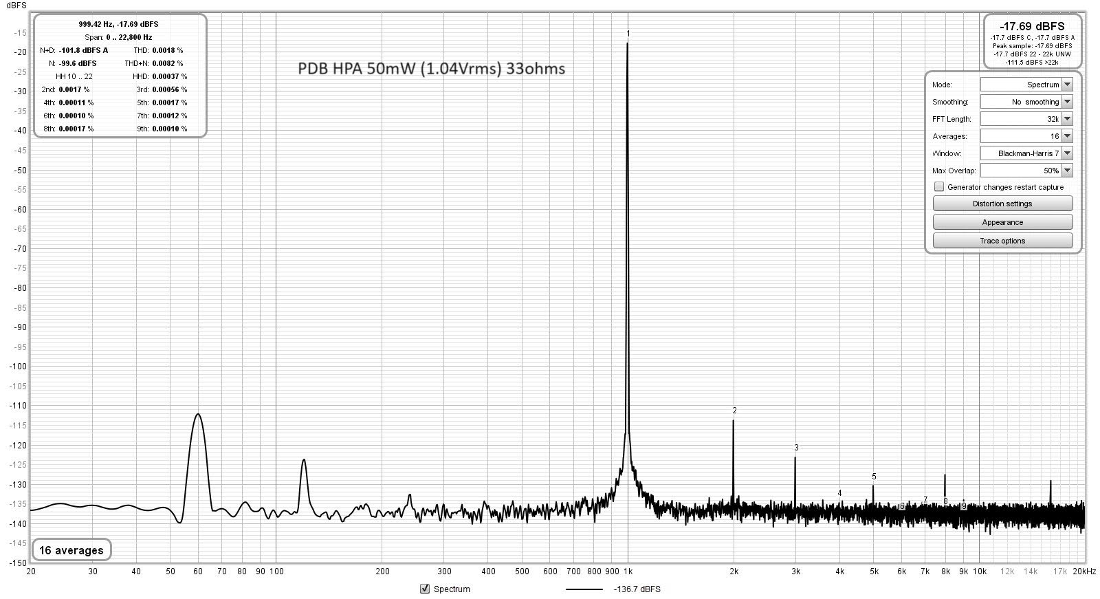

I recently made measurements of this same amp, but as mounted in an Altoids tin and two 9v rechargeable batteries. The performance was very good - nice SE Class A like harmonic distortion profile.
Here is 50mW into 33ohms, about 0.0018% THD. Max power was 373mW before clipping, but nice harmonic profile up to 270mW.
The 60/120Hz noise peaks are just ambient lab noise picked up through the air as this was battery powered.

The schematic as shown above works (albeit runs pretty hot circa 70mA bias current in practice when LTspice predicted 40mA). The circuit just needs an output snubber to resist oscillation at 7MHz. So with the addition of 10ohm (8.2ohm to 47ohm try various values with O-scope to check oscillation) and 100nF to ground on the outputs, it should be good to go. Member @lineup suggested a resistor in series on the output before the headphone load to ensure stability under a capacitive load. I suppose one could put 10ohm and 15uH air coil inductor (parallel) as a Thiele network at the output to ensure stability.
On the pocket version, I used 8.2ohms and on desktop version 47ohms seems to work for the output snubber.
If you really want to make it great, add a DC output protection relay. I would use a solid state relay (SSR) scheme with a 2 second turn-on delay and instant-off at power off feature to prevent thump and protect from headphones from DC in case one rail collapses before the other. I ran out of room to implement the SSR on this small board though. You may want to tweak the bias current by increasing the 2.2R emitter resistors to 4.7R and this will let it run cooler without really affecting performance too much. But if you have good heatsinking, it’s fine as is.

Do you think you could send me information on this as well? I am new to the site and so cannot pm yetPM'ed already Happy building.
