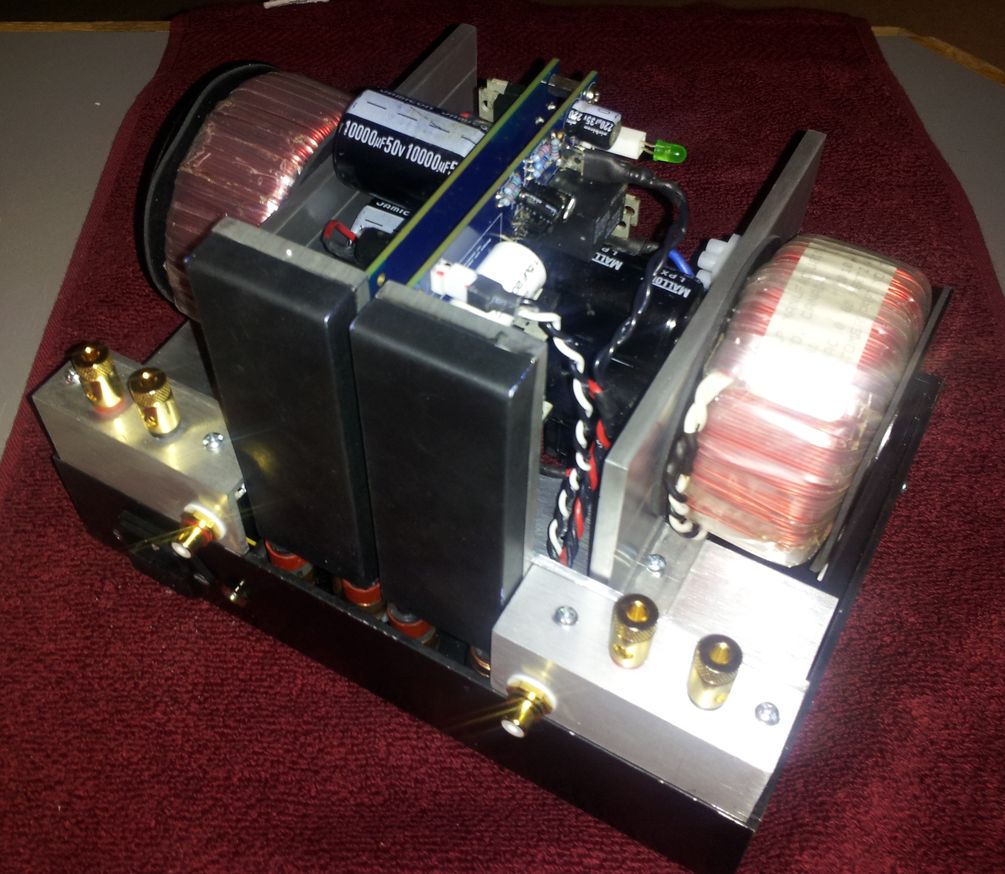

Some developments.

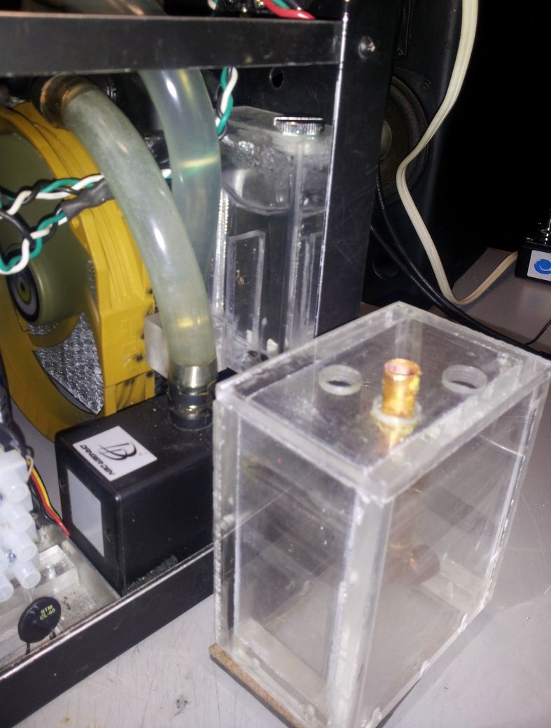

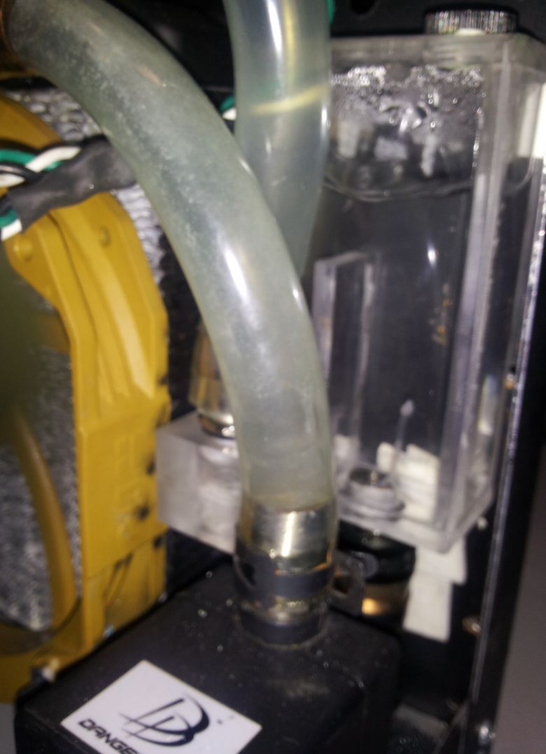

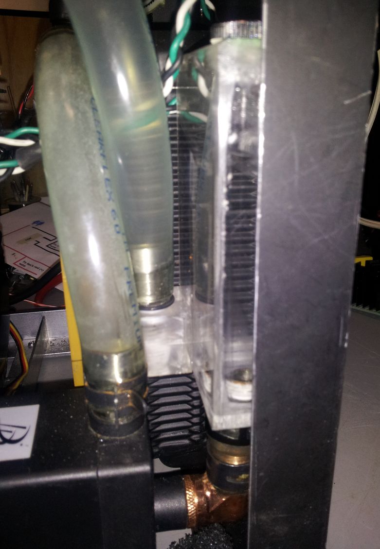

I had two more pump failures with the submersible approach. They weren't due to electrical changes, but the seals had either separated or were never installed properly by the manufacturer. I have not given up on that setup, but will apparently need to shell out more than $8 to get something more reliable.
In the meantime, I went for the small $49 Danger Den external pump I have, which required a new reservoir design. It worked out great as it is less than 1/4 the size of the all-in-one. The two most important elements here are a small space for air bubbles to escape, and an air tight seal. With the vertical placement of the cooler, even the tiniest leak allowed the weight of the water to force it to the top of the reservoir and flow out of any small crack. Careful construction, liberal use of Teflon tape and air pressure testing solved the problem.

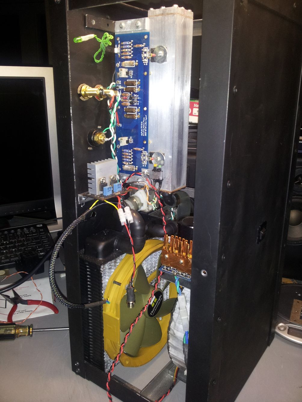

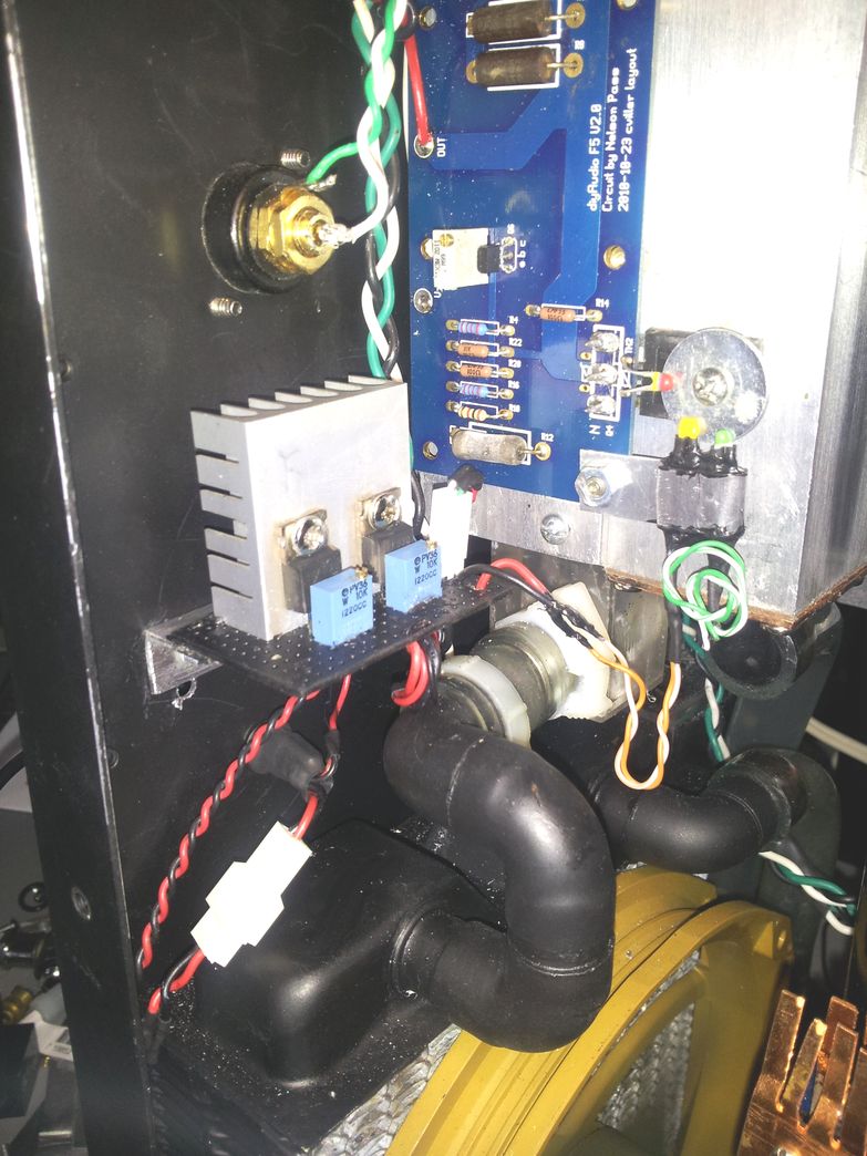

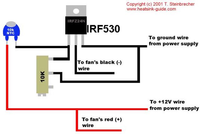

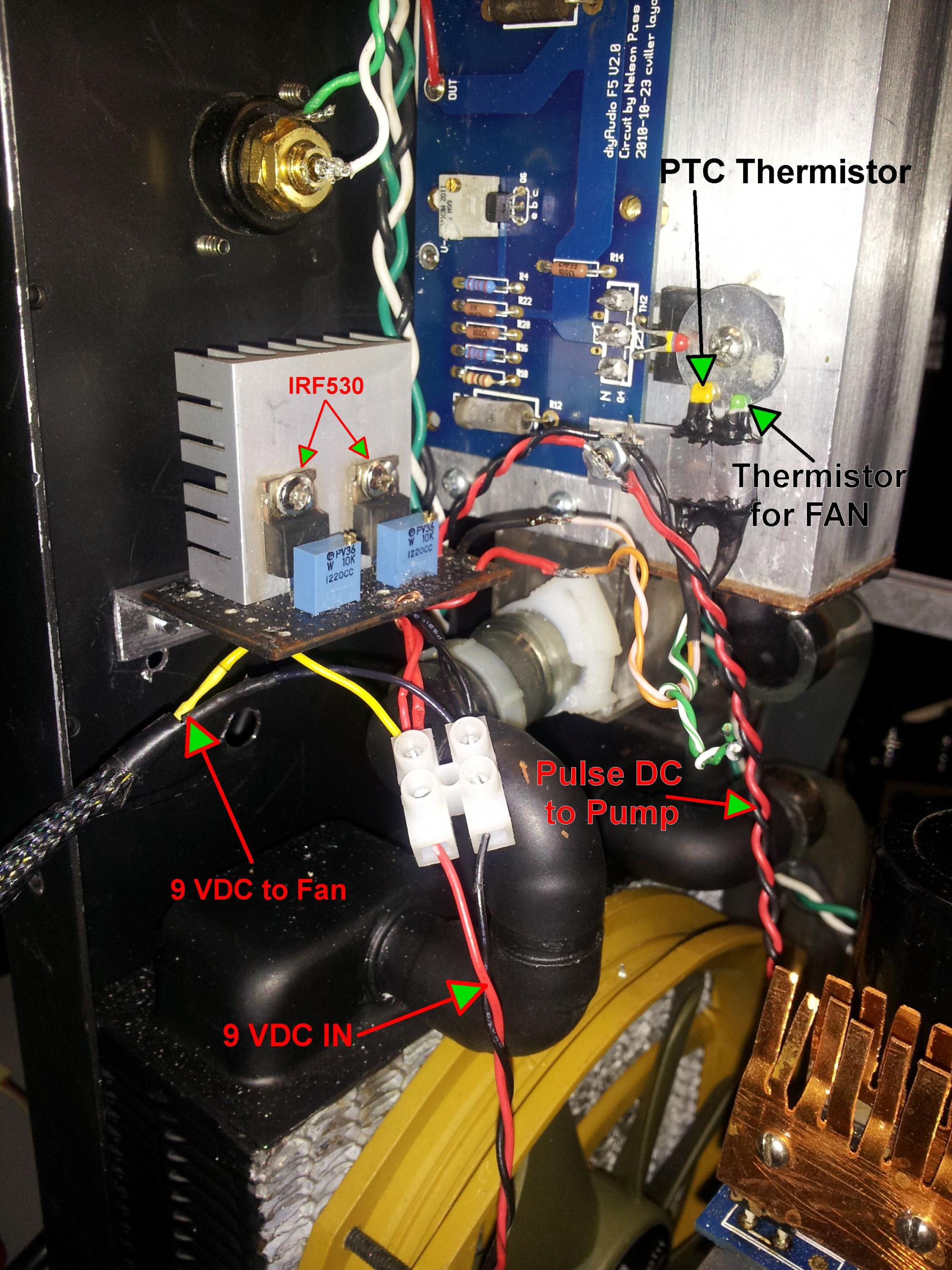

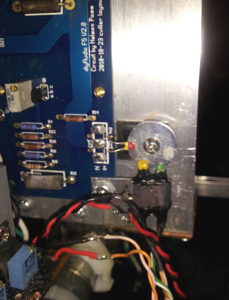

The next big development was applying the thermistor/regulator referenced by evanc over on the Pass Pictures thread. His suggestion was to use that circuit to increase the fan speed at higher temps. I built one and it worked as described (wire connections/junctions must be exactly as shown) However, slowing the water flow and holding it in the radiator longer is just as important. I discovered a PTC thermistor that works backward - increases resistance as temperature goes up. Replaced the standard thermistor with a PTC and it worked as I had hoped.
The tuning involves letting the amp reach it's highest temperature and then adjust the trimmer to run the pump at the lowest speed desired. This time I'm using a 9 volt wall wart to power both fan and pump, with the fan at full power. I did try to use both thermistors on one power supply - but the trimmers were too interactive to allow useful individual adjustments. The fan noise is still undetectable at 9 volts. The adjustment range is wide enough to allow safe start-up voltages and the low speed is protected by the pulsed voltage from the PTC chip. Here is a short video that shows the flow/temp relationship. Watch liquid activity in the reservoir.
Still need to tidy up and shorten the wires, install the 9V power inlet socket at the back of the chassis and start on the chassis cosmetics. The Burning Amp build is taking shape and will hopefully appear near the end of next week.
Thanks again evanc - you got the ball rolling.

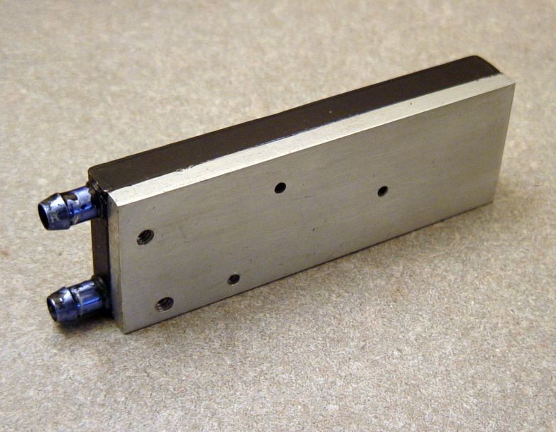

I enjoy the fabrication process as much as the amp building itself. I was employed as a machinist for a period of my work history and it's fun to discover how much of that is still rattling around in this aged brain.
😉 Over the years I've collected a comfortable set of tools and small machines (drill press, band saw, sanders etc,) which may not be available to others. Not having those should not deter one from investigation the concept.
I might go back and try to modify the water block I used for a MyRef build to cool the F5. It is attached to a piece of 1/4" aluminum with an Arctic Silver two part thermal epoxy to avoid drilling. Simply making the slab a little longer should work. There are several items available from the vendor I used, so jump in if you feel the urge 😀
The clamping technique you mention is part of the BA-3 project. Selecting the appropriate radiator and fan size is the trial and error process I'm in currently. I've discovered there is a great difference in heat transfer efficiency depending whether the fan draws or pushes the air. Single fan at high speed vs. multiples at slower speeds effects overall system noise levels.
