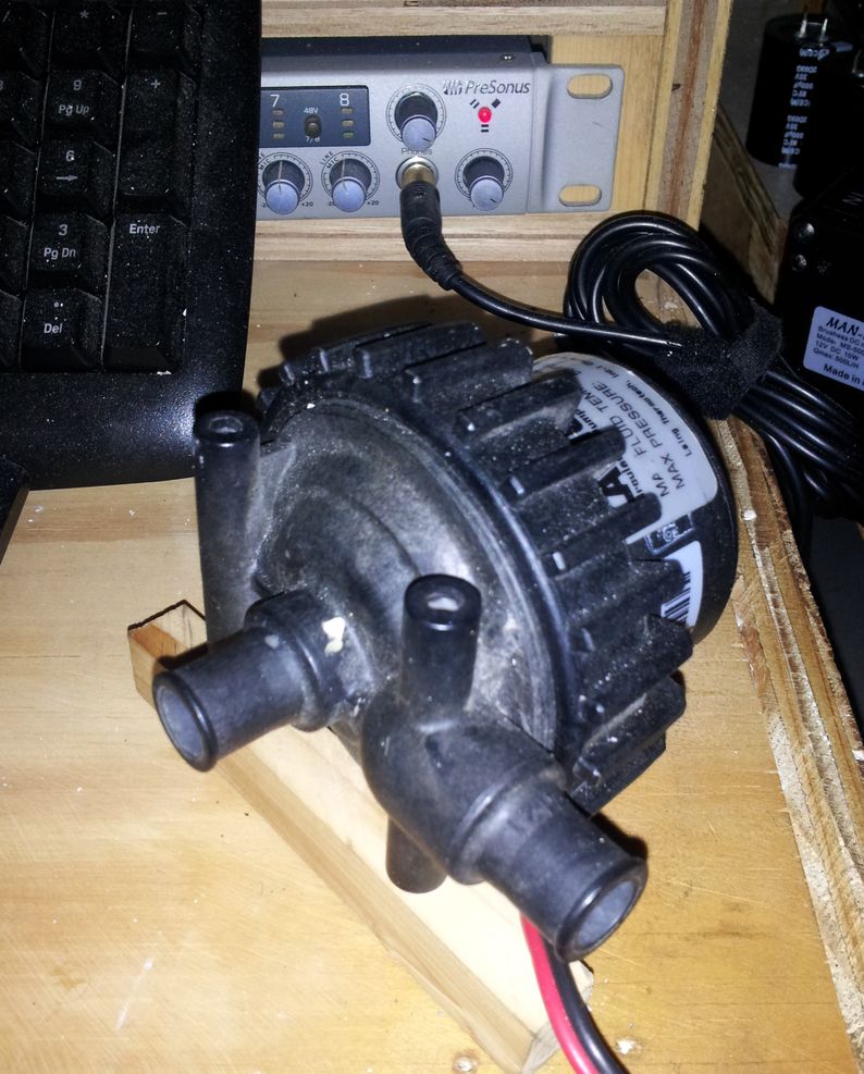

Your information was thorough and accurate - thanks. There are many pumps to choose from and that will be my focus over the next period. I do have one with the necessary circuits built in, but it is non-submersible and larger than I wanted for a compact chassis. May have to go in that direction eventually. The pump I used yesterday was an $8 eBay special. Now that I know the cooler works I'm willing to make a bigger investment. Might need a small IC circuit for start-up control.

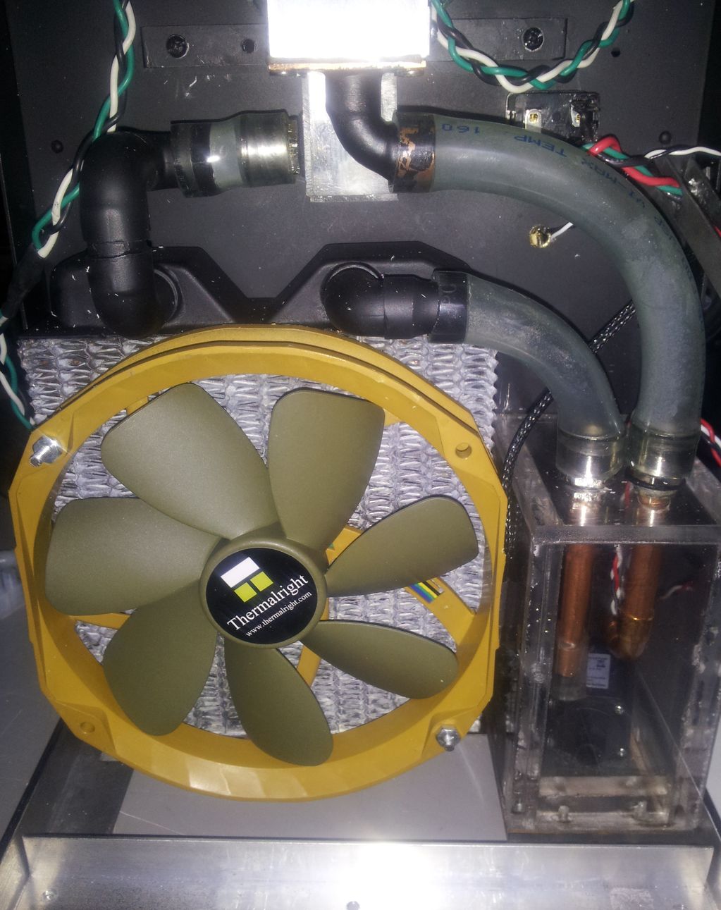

REG, that technique has been mentioned often and I'm sure it could be applied effectively. However, my primary project guidelines include:
1. Reduce the bulk of the heat dissipation elements.
2. Use readily available components.
3. Maximize simplicity by using as few components as possible.
4. Insure any potential leaks are isolated from all active circuits.
5. Allow easy dis-assembly of three discrete modules -cooler, PS and amp.
6. Have some fun doing it. 😀
I have seen enough interest/response in these projects to convince me that implementing liquid cooling for audio equipment, if the process is practical, simple and safe, could be a realistic alternative for heat management.
Thanks for you comments and for participating on the thread, but I doubt LN would pass the WAF approval test in many households.
In keeping with the list above, I have made several mods to the F5 project.

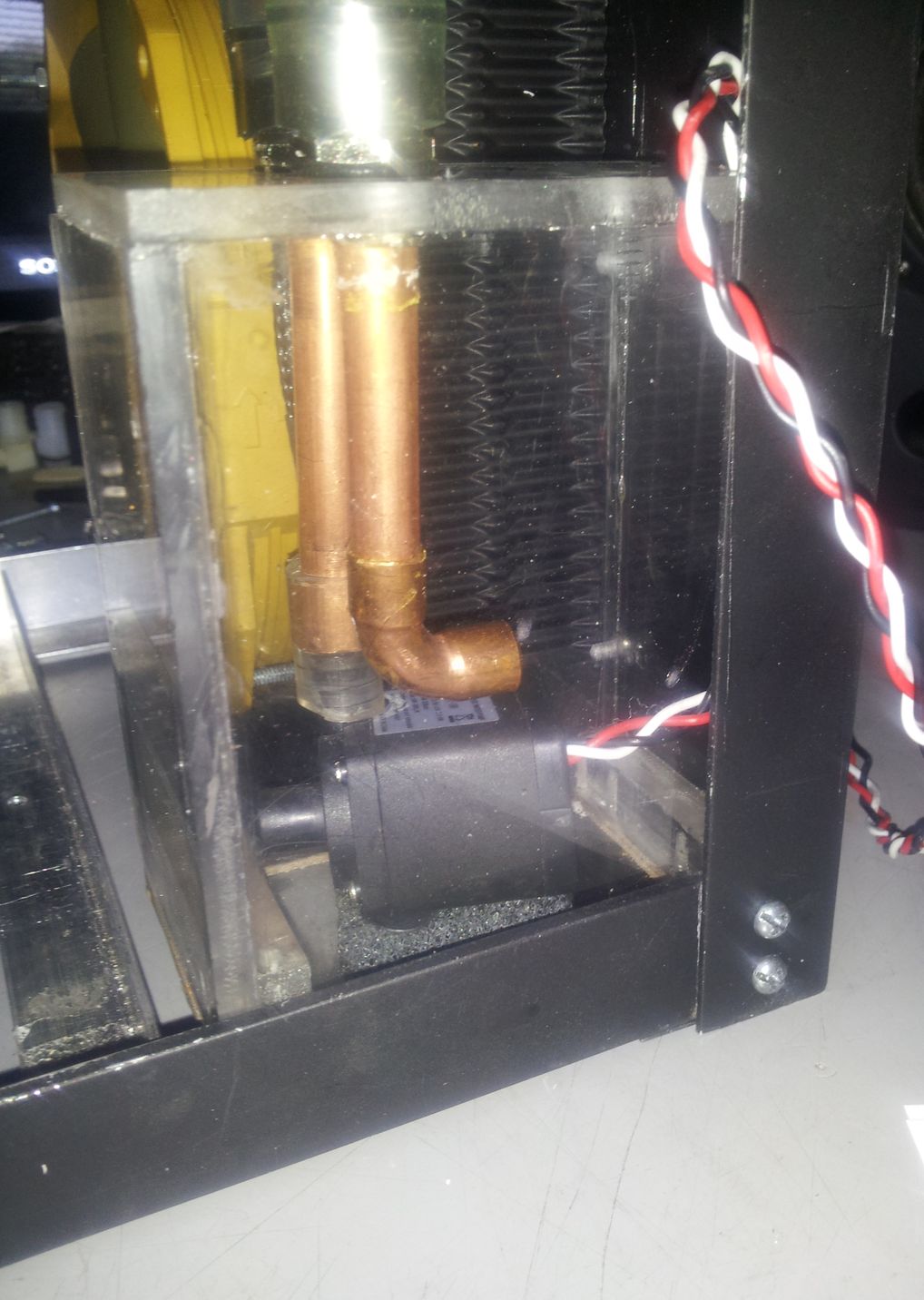

Disconnecting the pump/reservoir was a real pain. Adding flexible links allows better access. It required shortening the tank but also eliminated several components in that section.
Added a back facing elbow to eliminate pump cavitation caused by air entering the pump during initial fill process.

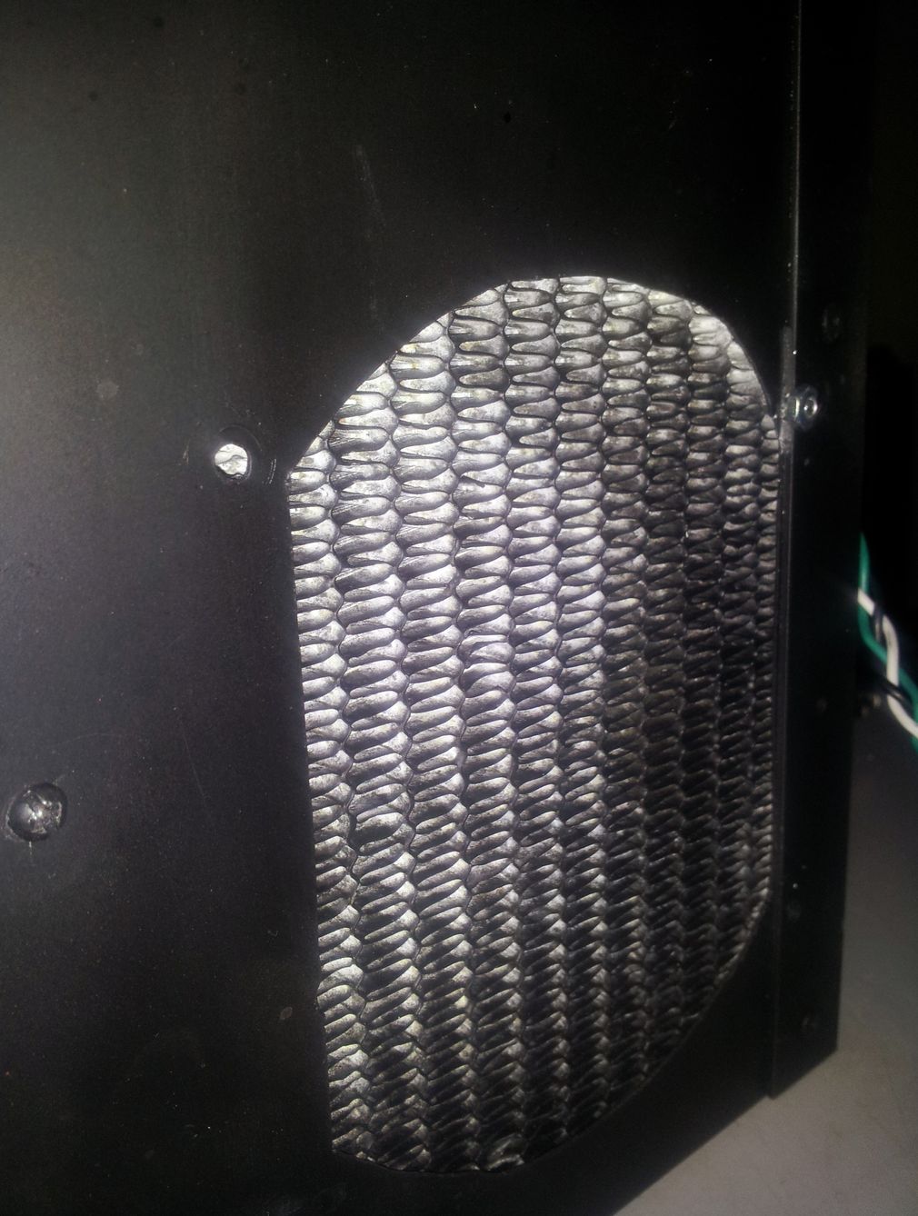

Use of threaded rod that passes through the fan, radiator fin plates and chassis. That eliminated the wood mounting plate with blind screws, and the acrylic adhesive on both sides of the radiator that was applied in the earlier construction.
Also reversed the fan to push air through the radiator. The original orientation had the potential to reduce fan noise, but the amount of heat pushed through the chassis was excessive.
I'm in the process of adding the AC mains switch and thermistor system.
