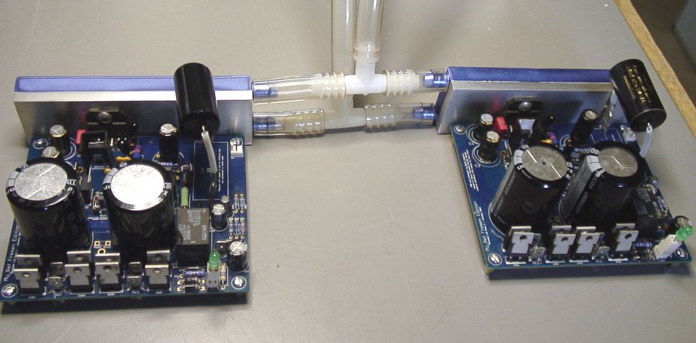

I have several PCs with liquid cooling and mostly out of curiosity wanted to apply that method to audio. Purchased two of these on a whim and collected the necessary parts from the stash. No way to drill into the coolers so a standoff plate was built.

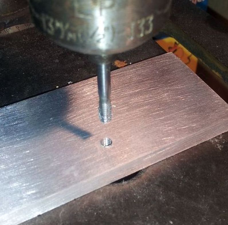

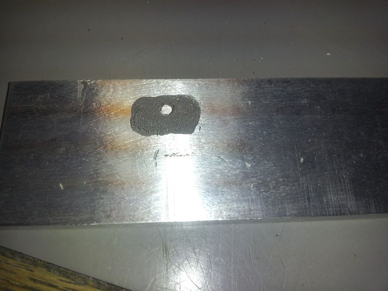

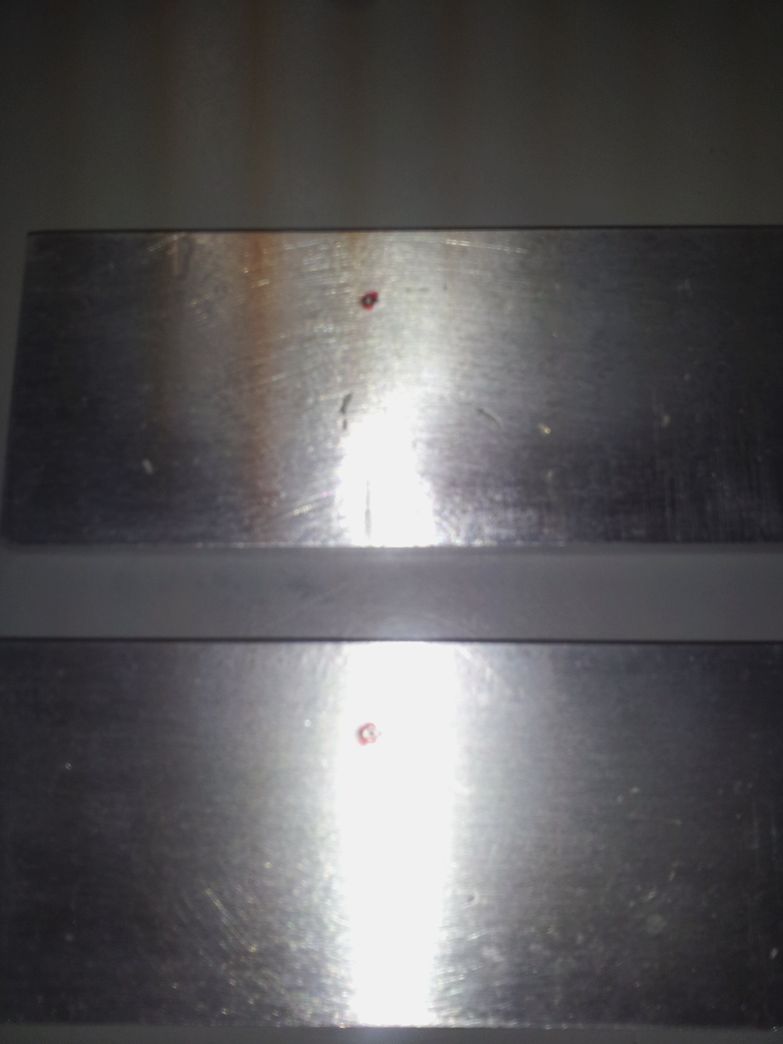

Located the mounting hole by spreading compound on the chip which was soldered to the PCB with standoffs attached.

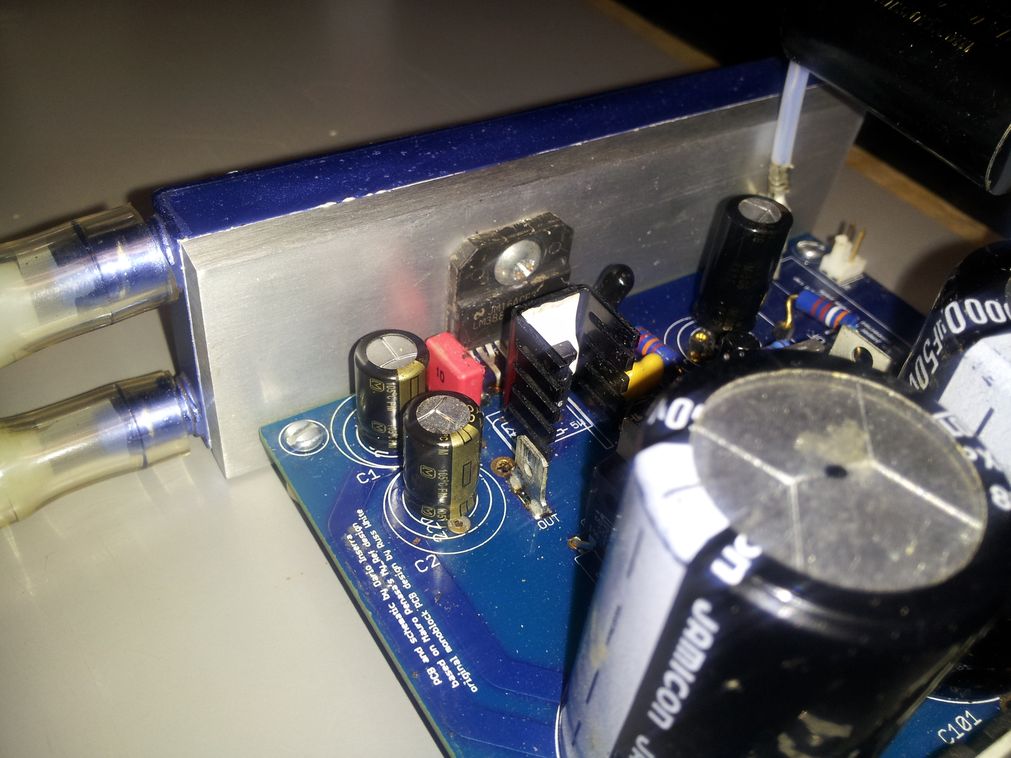

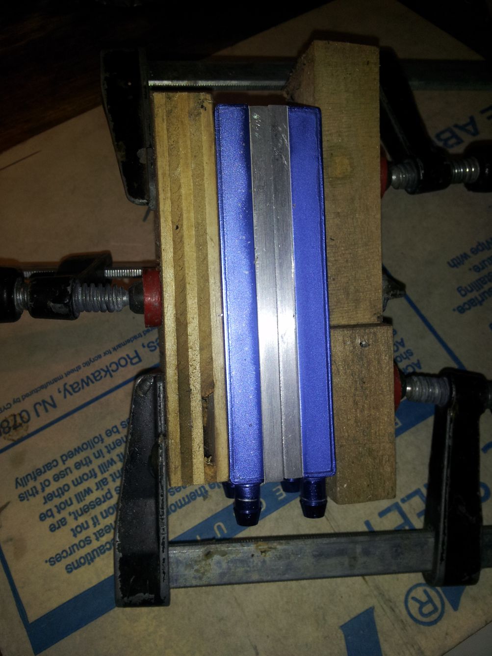

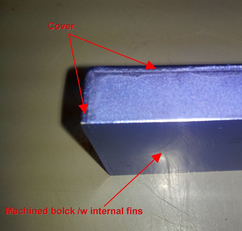

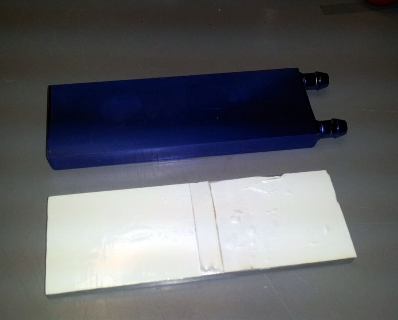

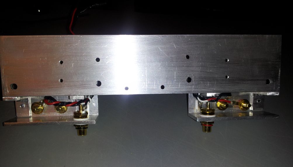

The simplest, though not most efficient way to combine the plate and the cooler was double sided heat transfer tape. They were clamped together overnight for a solid set. If I do another one I'll make some sort of bracket that will allow the use of paste instead of thermal tape.

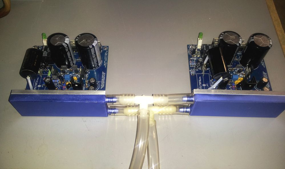

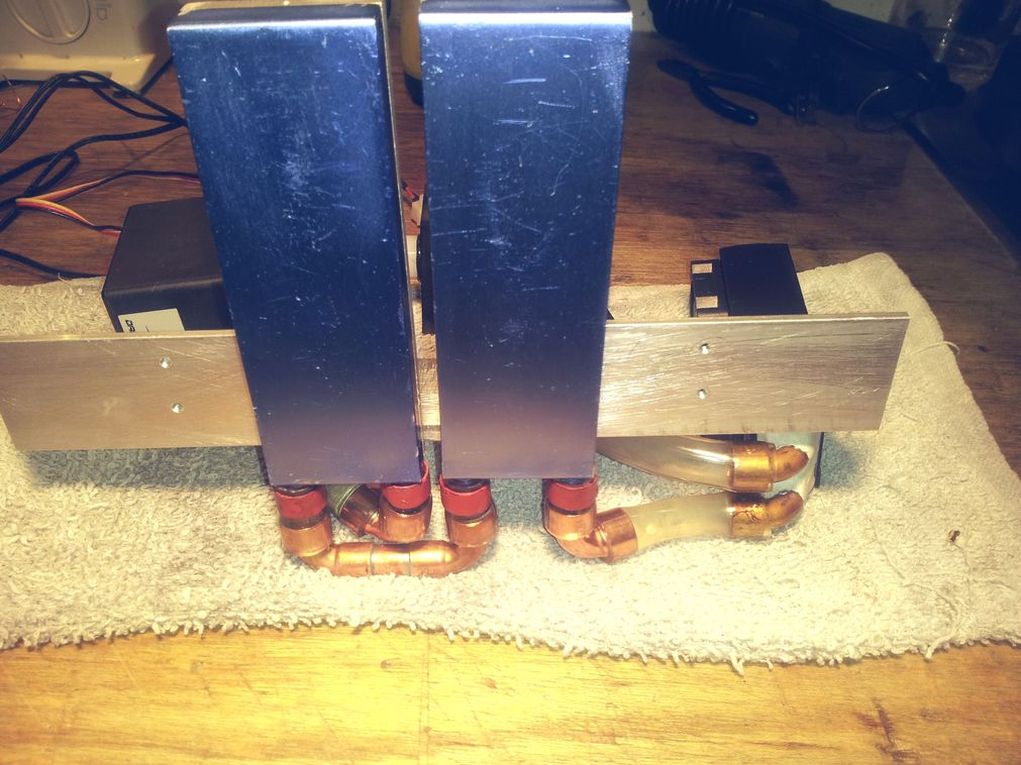

Mounted amp module to cooler and cut tubing links.

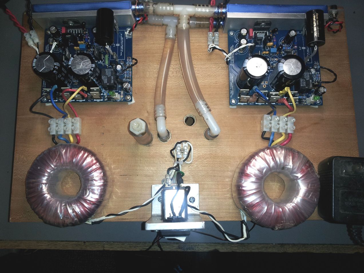

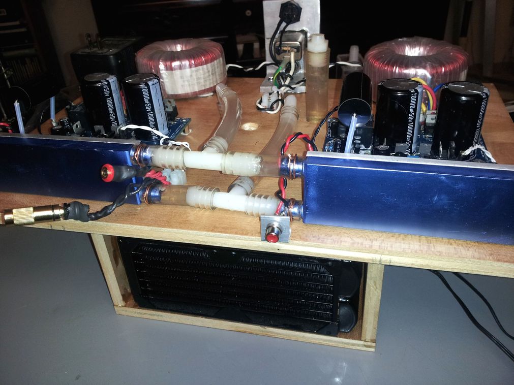

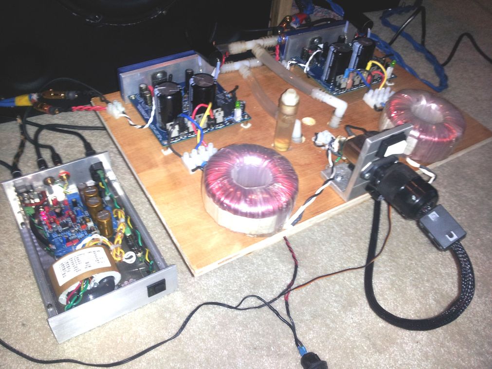

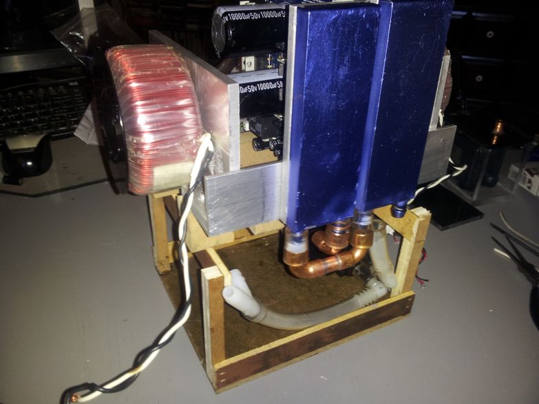

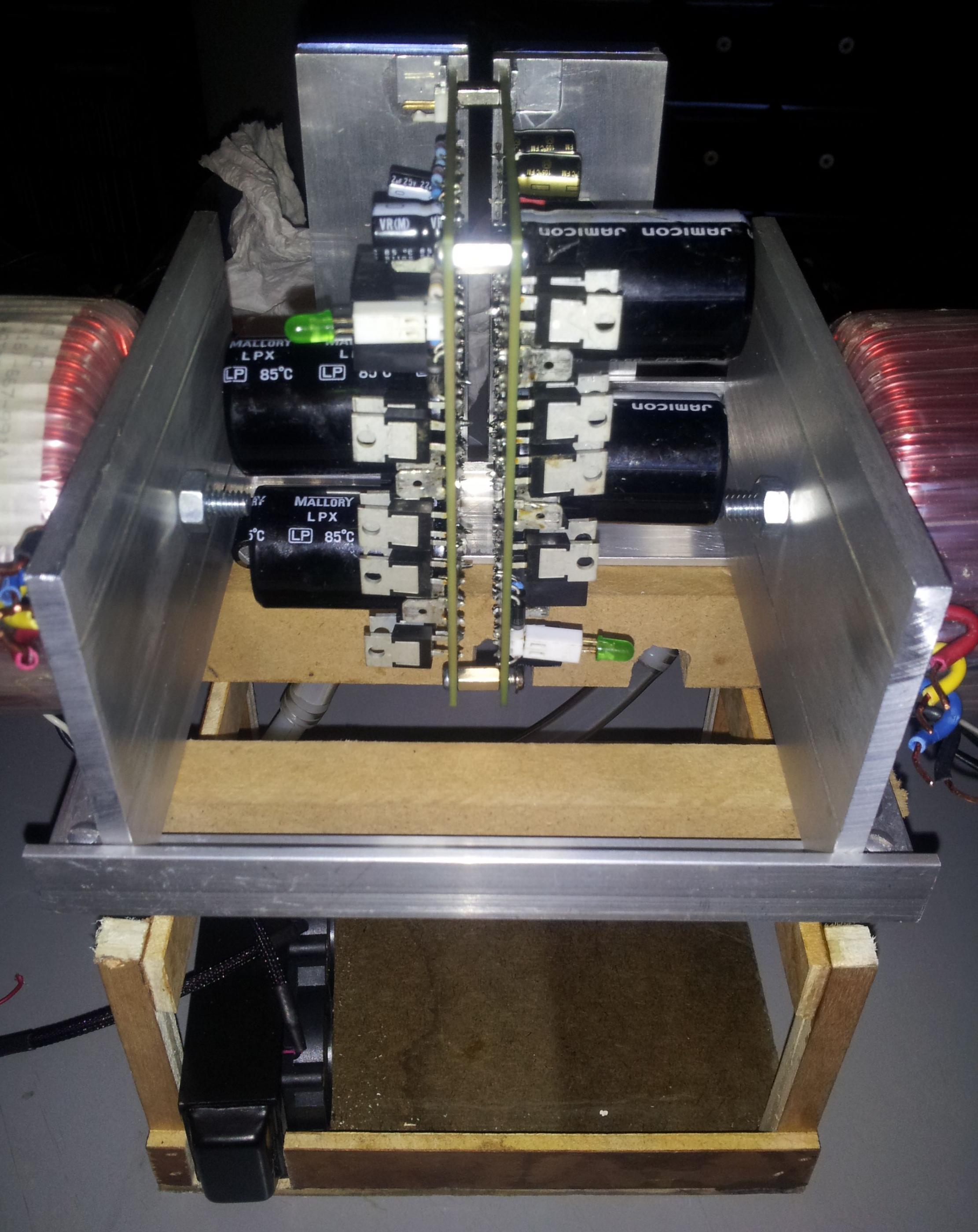

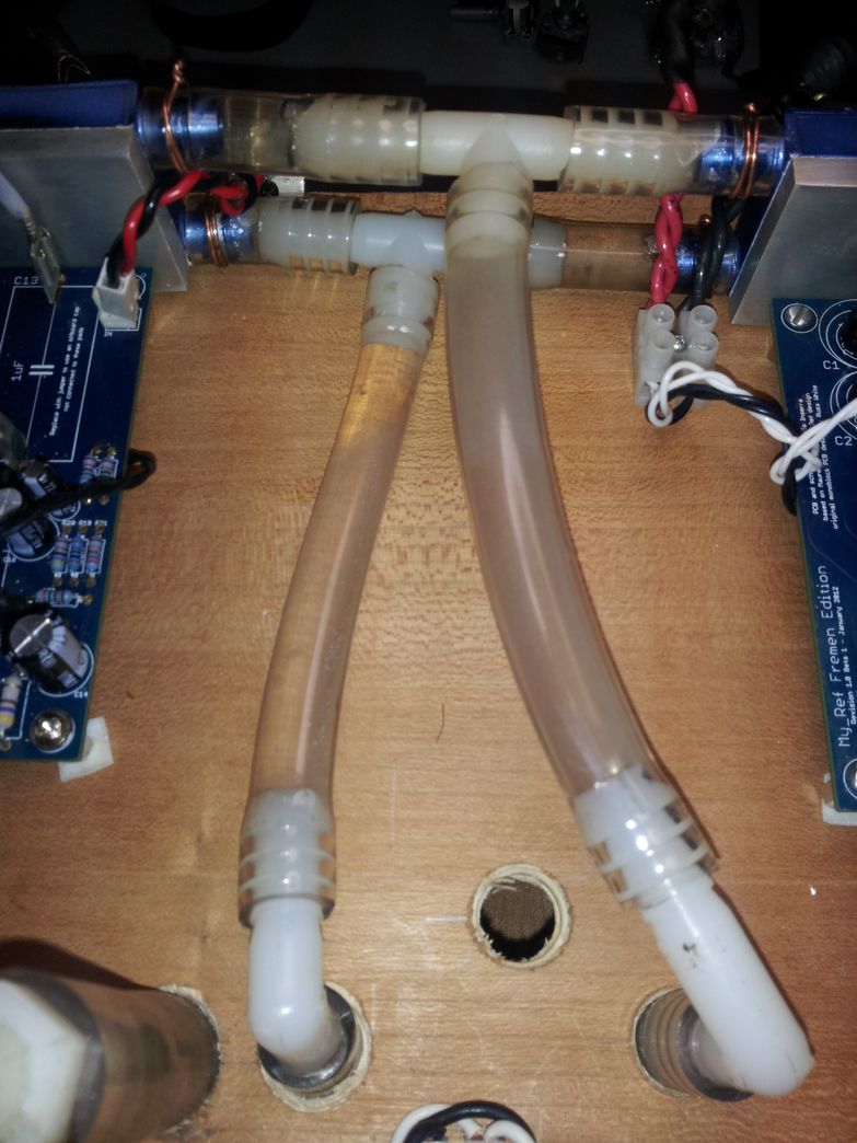

]First shot was built on plywood frame. The cooling elements were all standard 80 mm format.
Fill port/air release worked great but I didn’t like having the liquid that close to the amps.

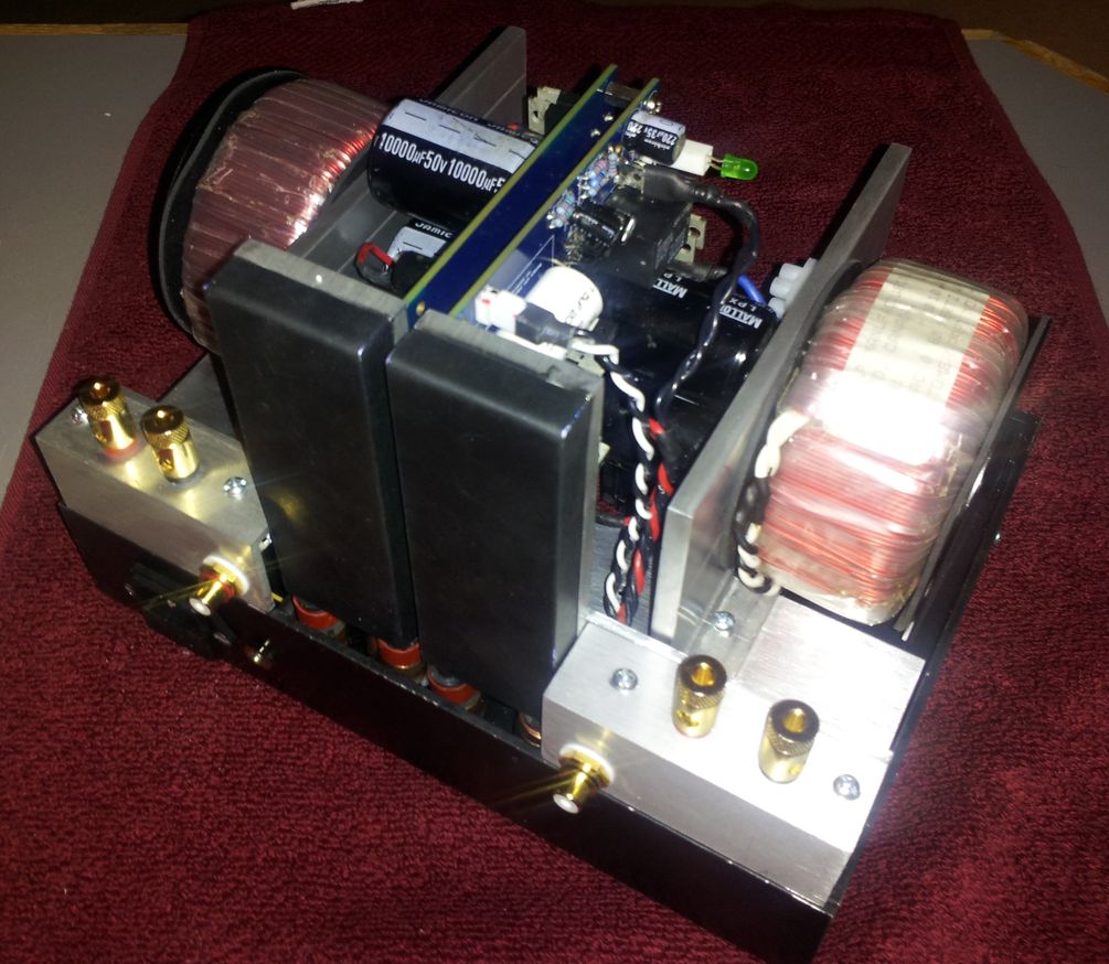

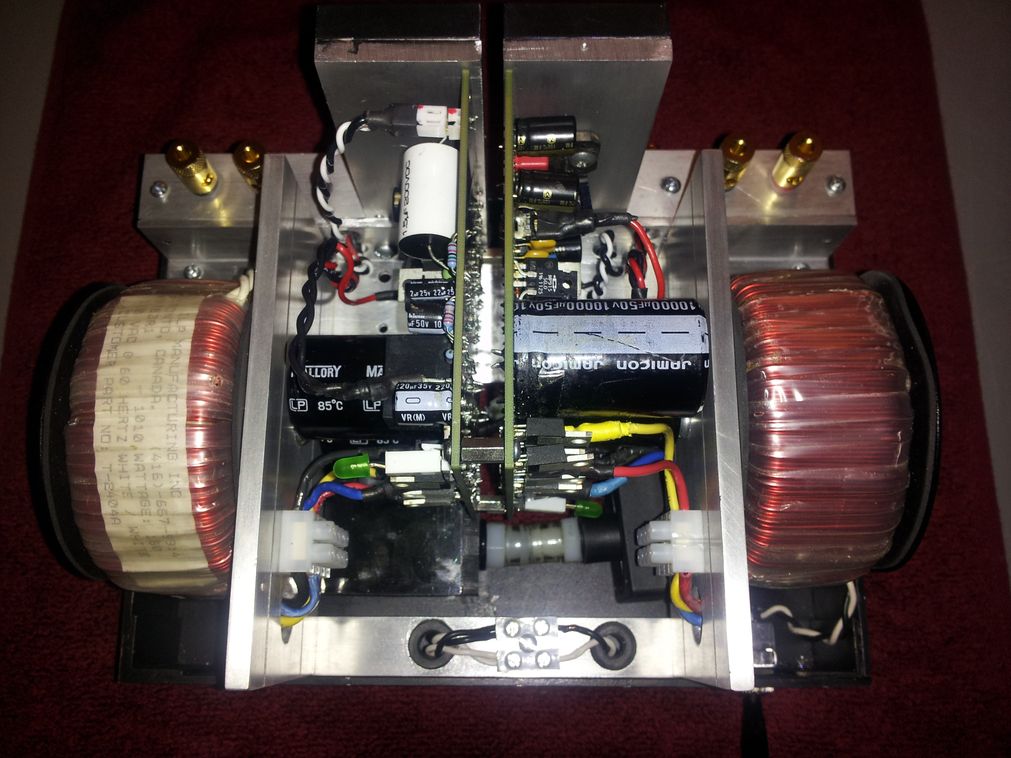

Here the system is making cool music with no leaks and a stable temp just above ambient.

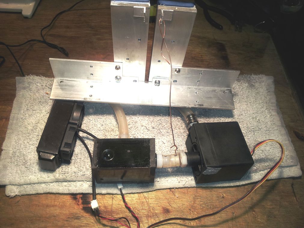

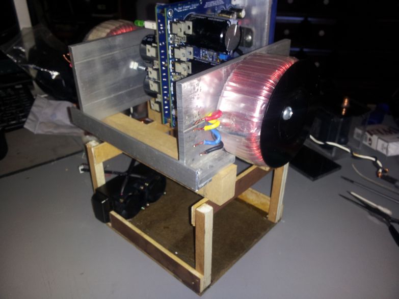

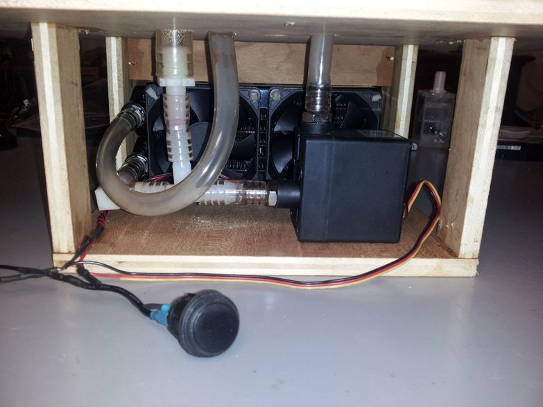

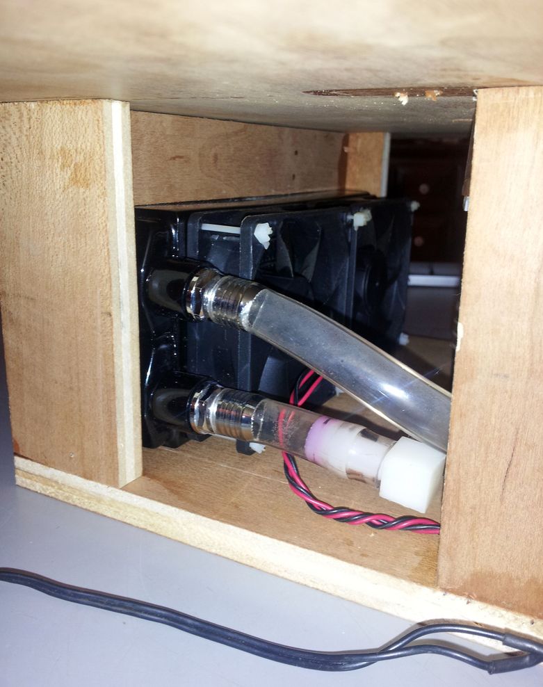

Second attampt was centered around the idea of keeping the liquid below the amp. Cobbled up another woden frame and placed my chin firmly on my palm and began to ponder.

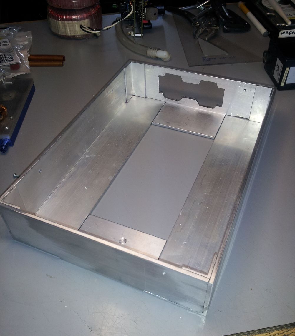

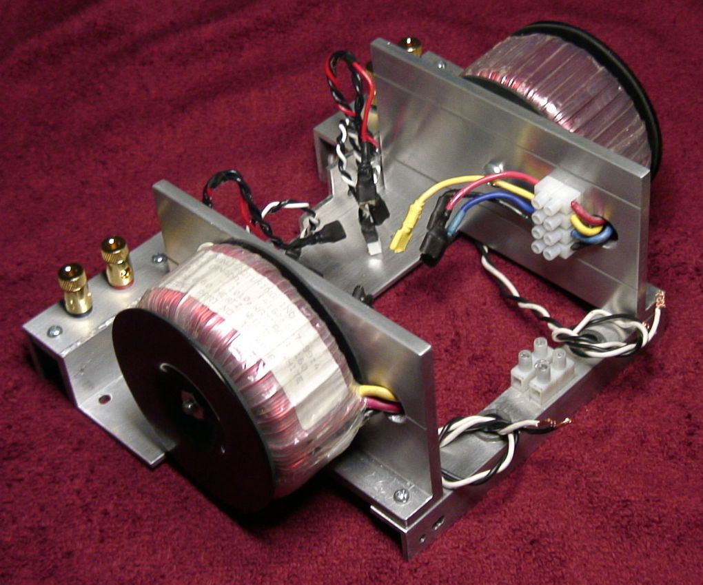

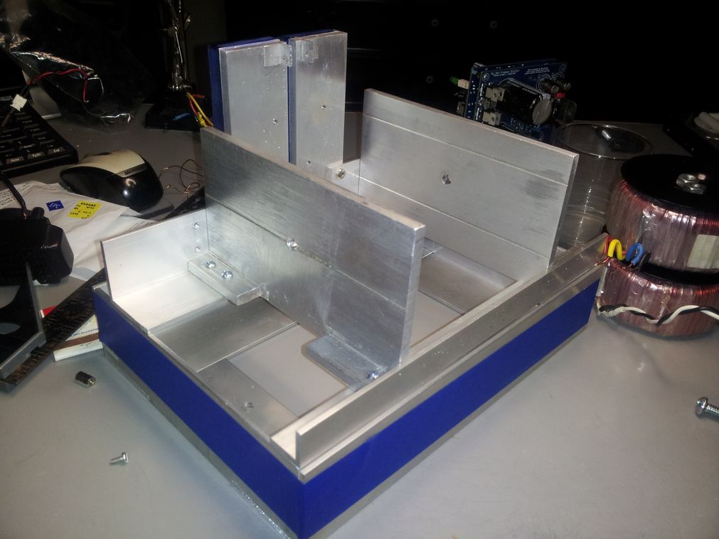

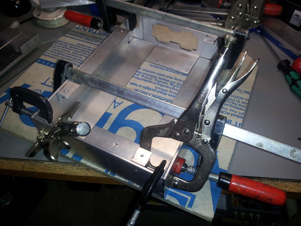

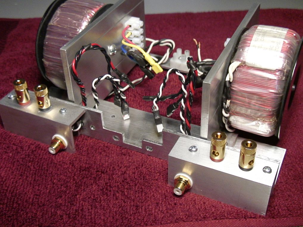

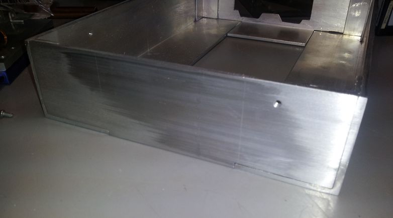

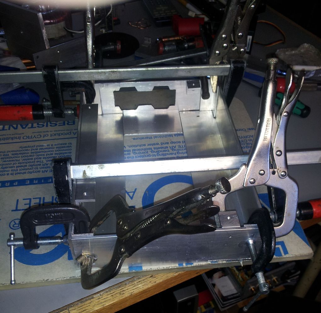

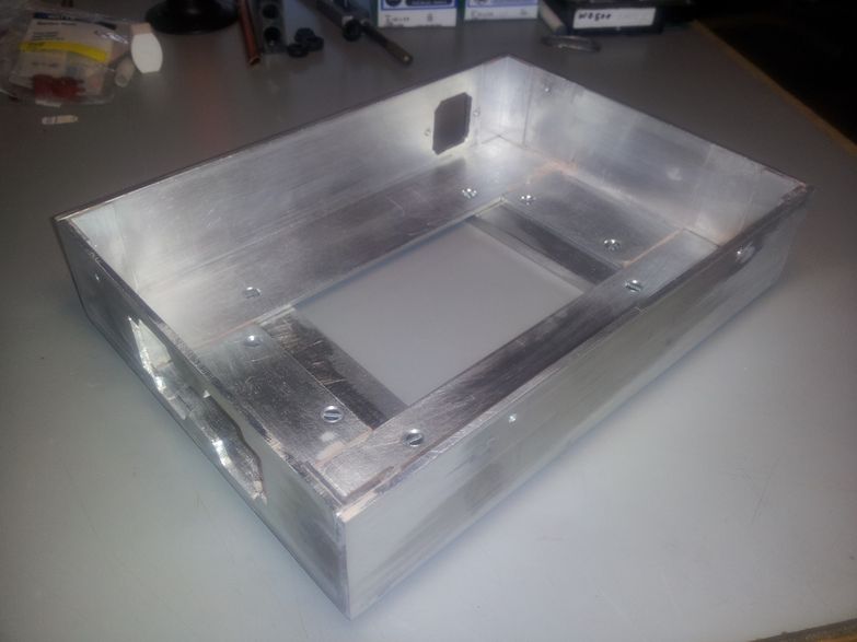

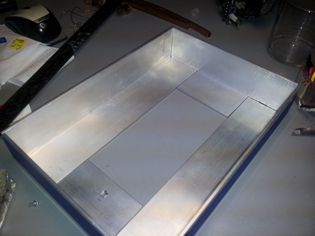

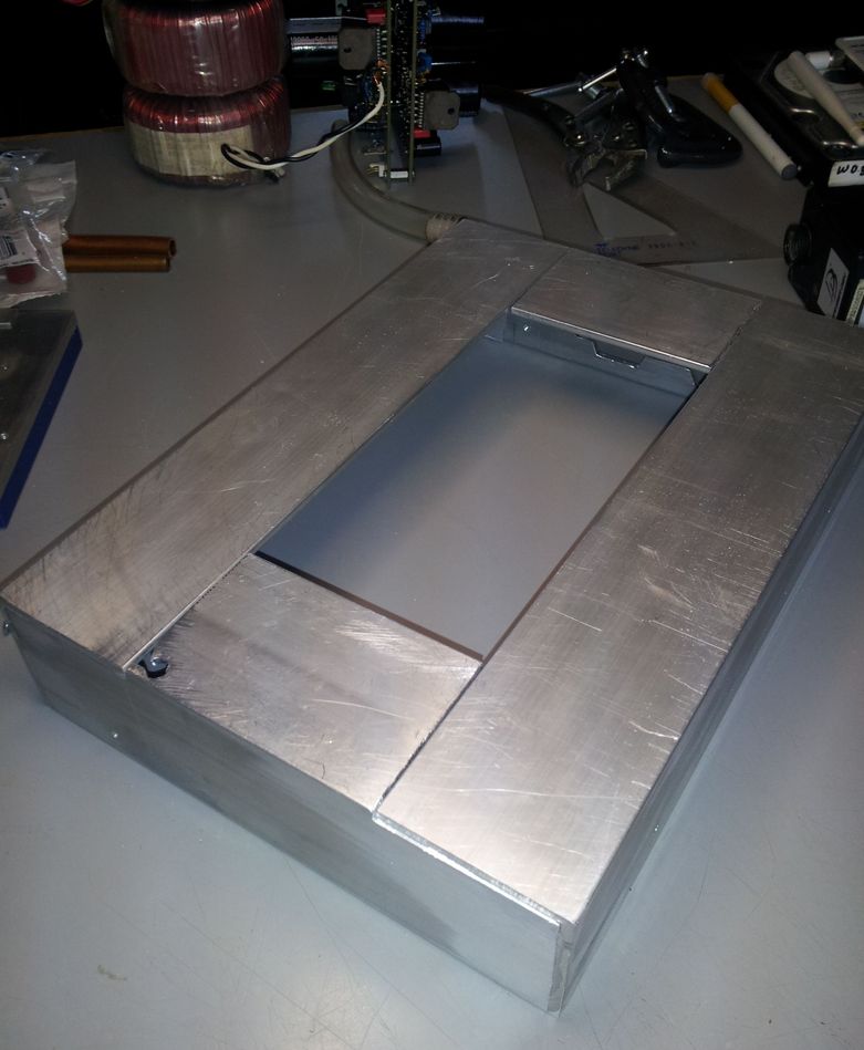

Started fabrication of base for cooling system with 1/8” x 2” aluminum angle from the local hardware store. Transformer brackets are from ¼’ x 3’ angle.

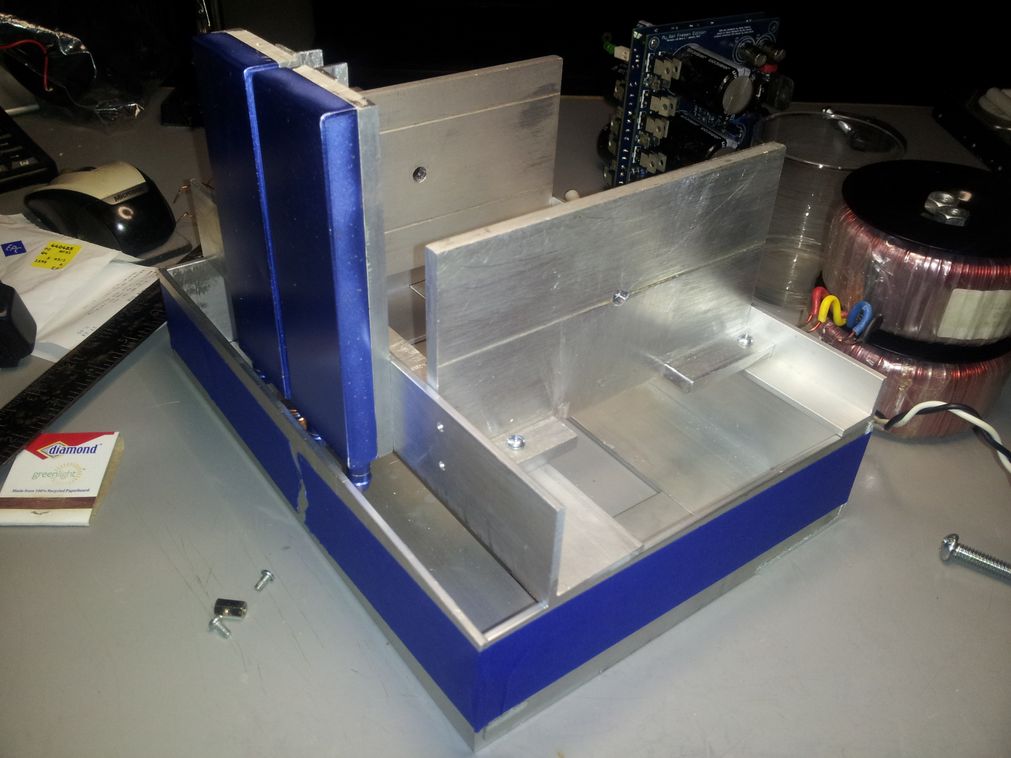

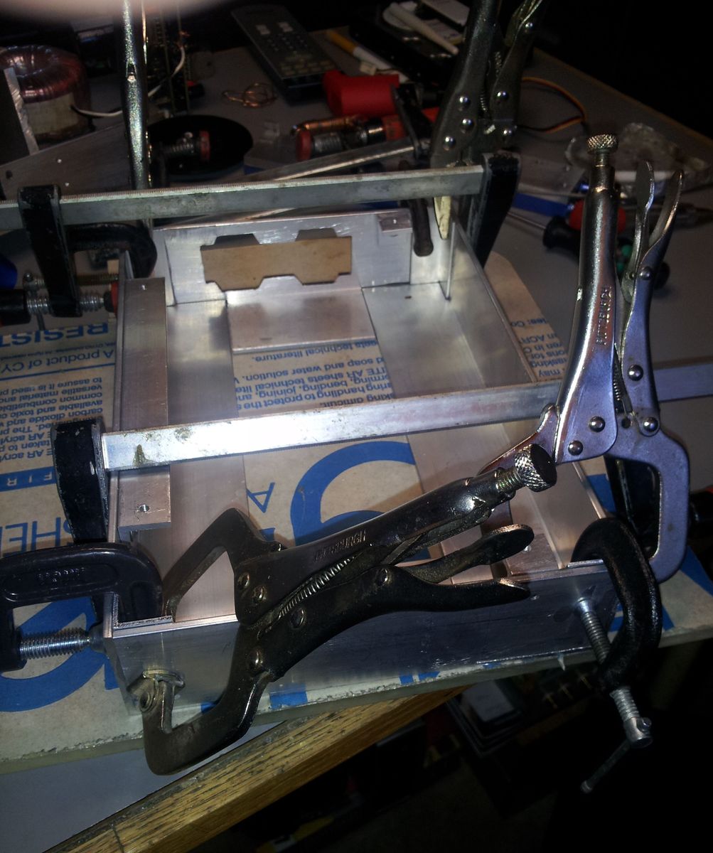

Attached 1/16” corner braces with two part epoxy for both stability and squareness.

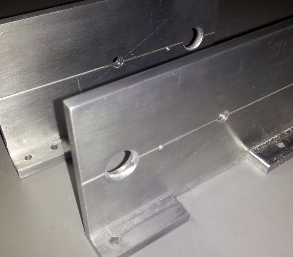

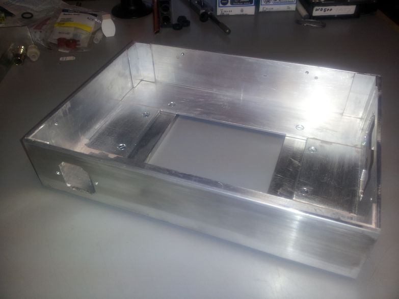

Photo of lap/inset construction.
Underside with support/feet and a touch of Bondo for the oopses from hand cutting.
Holes for bottom supports are countersunk for flathead screws.
Corner reliefs for wire paths on transformer bracket.

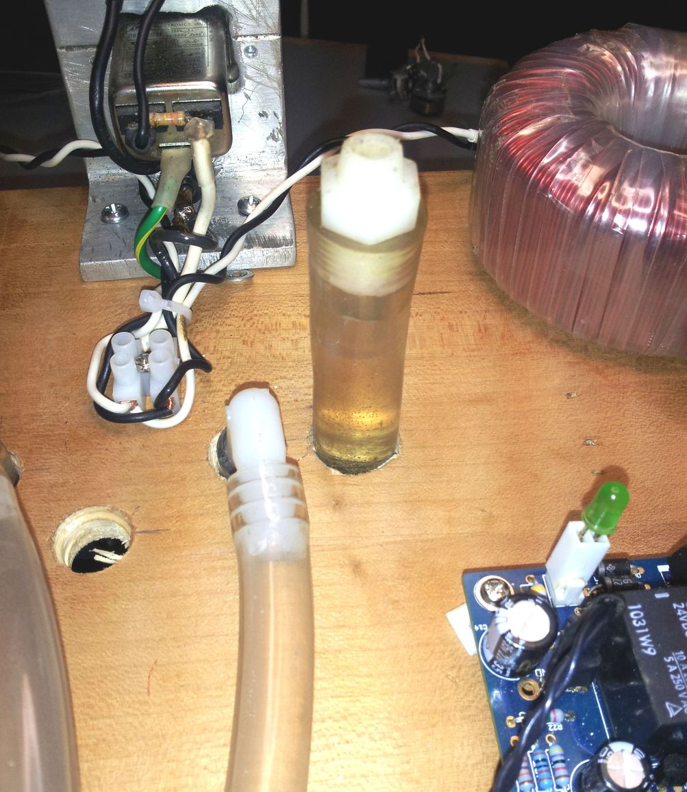

Looks like it’s going to work so now on to the reservoir.

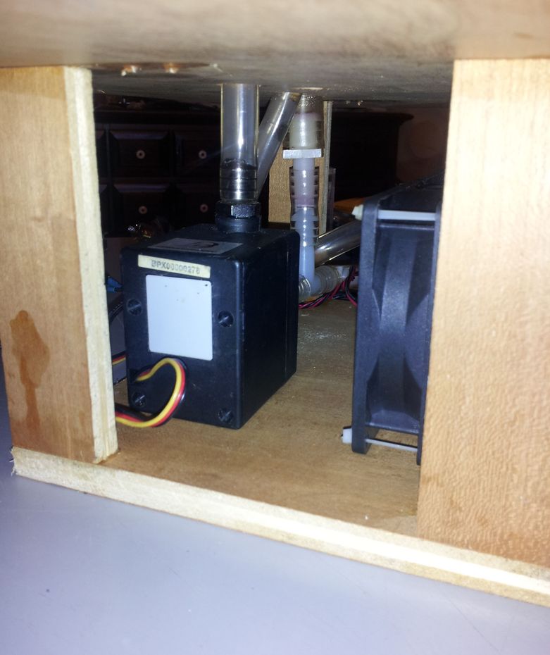

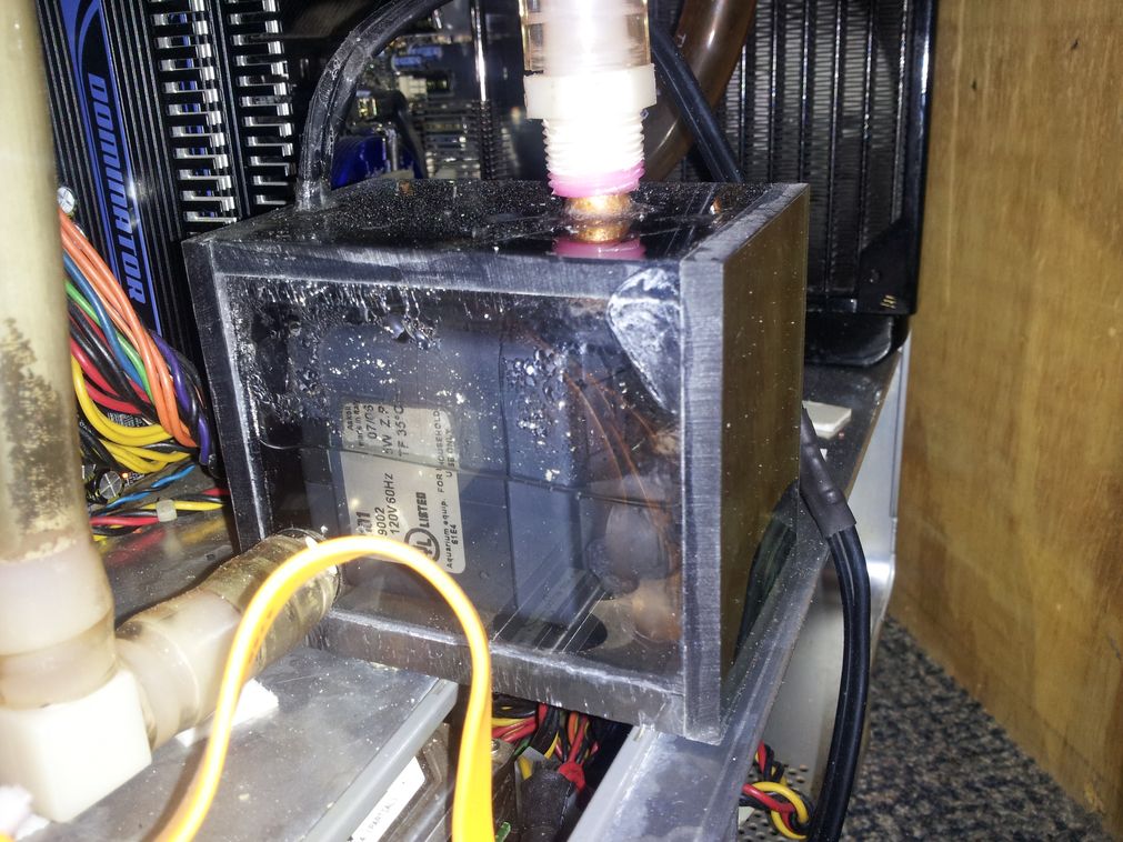

Initially hoped to do a combo pump/reservoir with a fish tank AC powered unit. But it was too big for the cooling box. As luck would have it, the seven year old pump in my main PC lost a bearing during this time so it wasn’t a total waste.
Right method but still to awkward for installation in the BLAT.

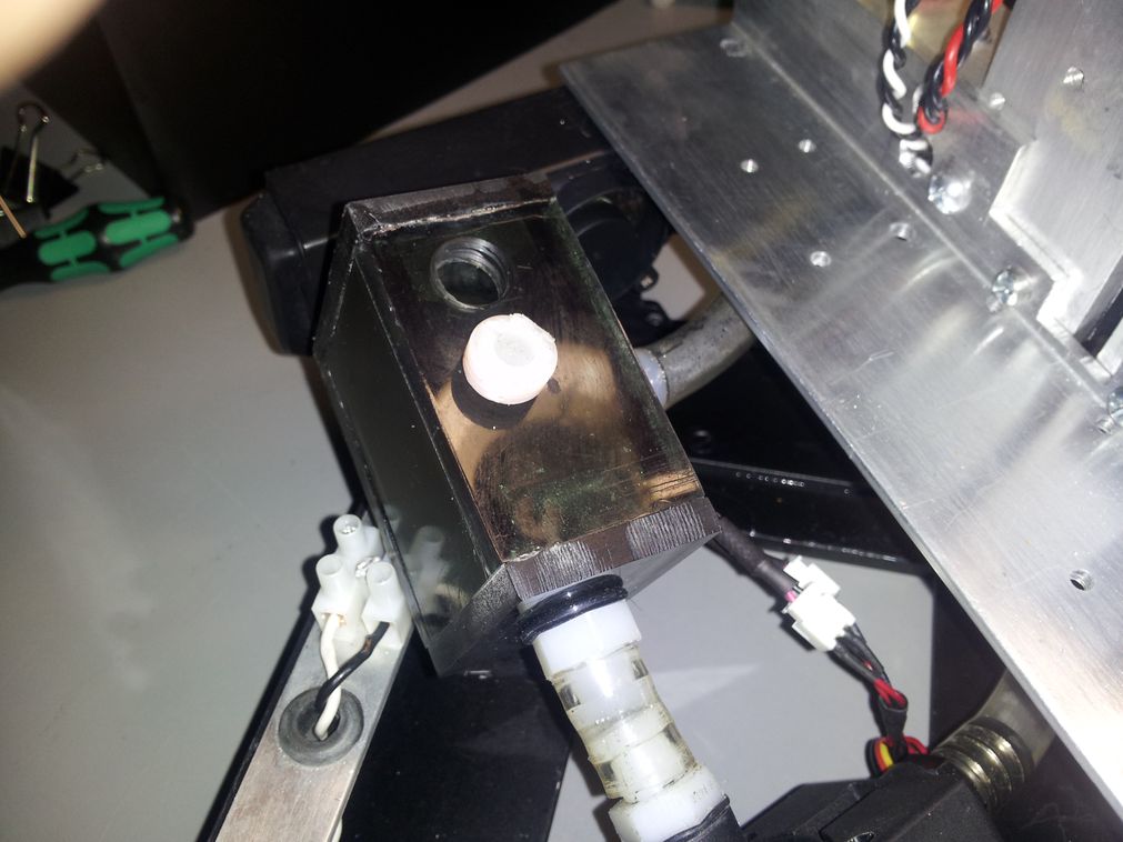

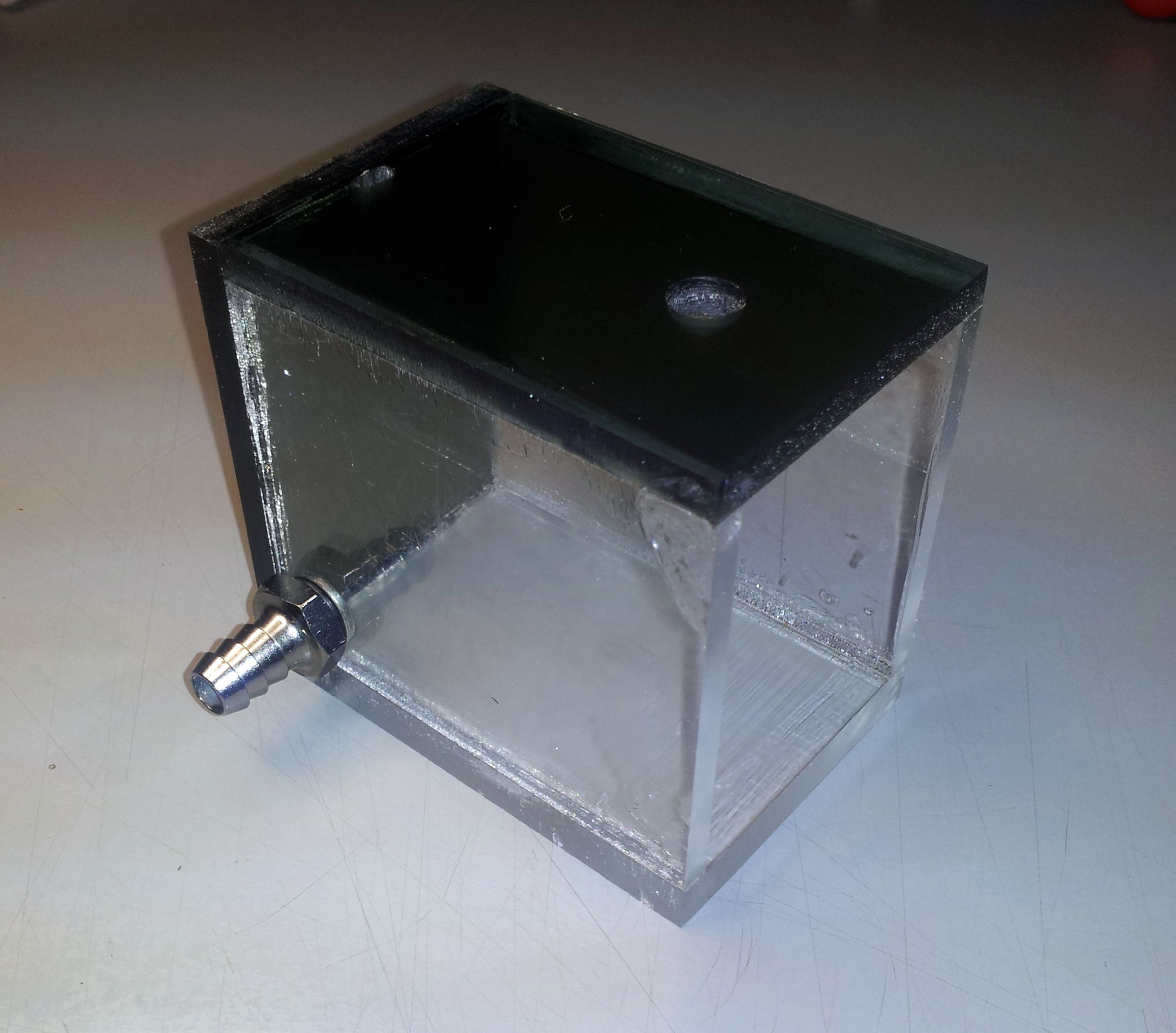

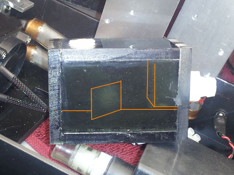

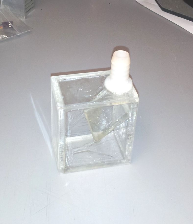

Gave up on the combo unit and built a res I knew would fit.
Shows outline of inlet deflection plate and square outlet suction tube.

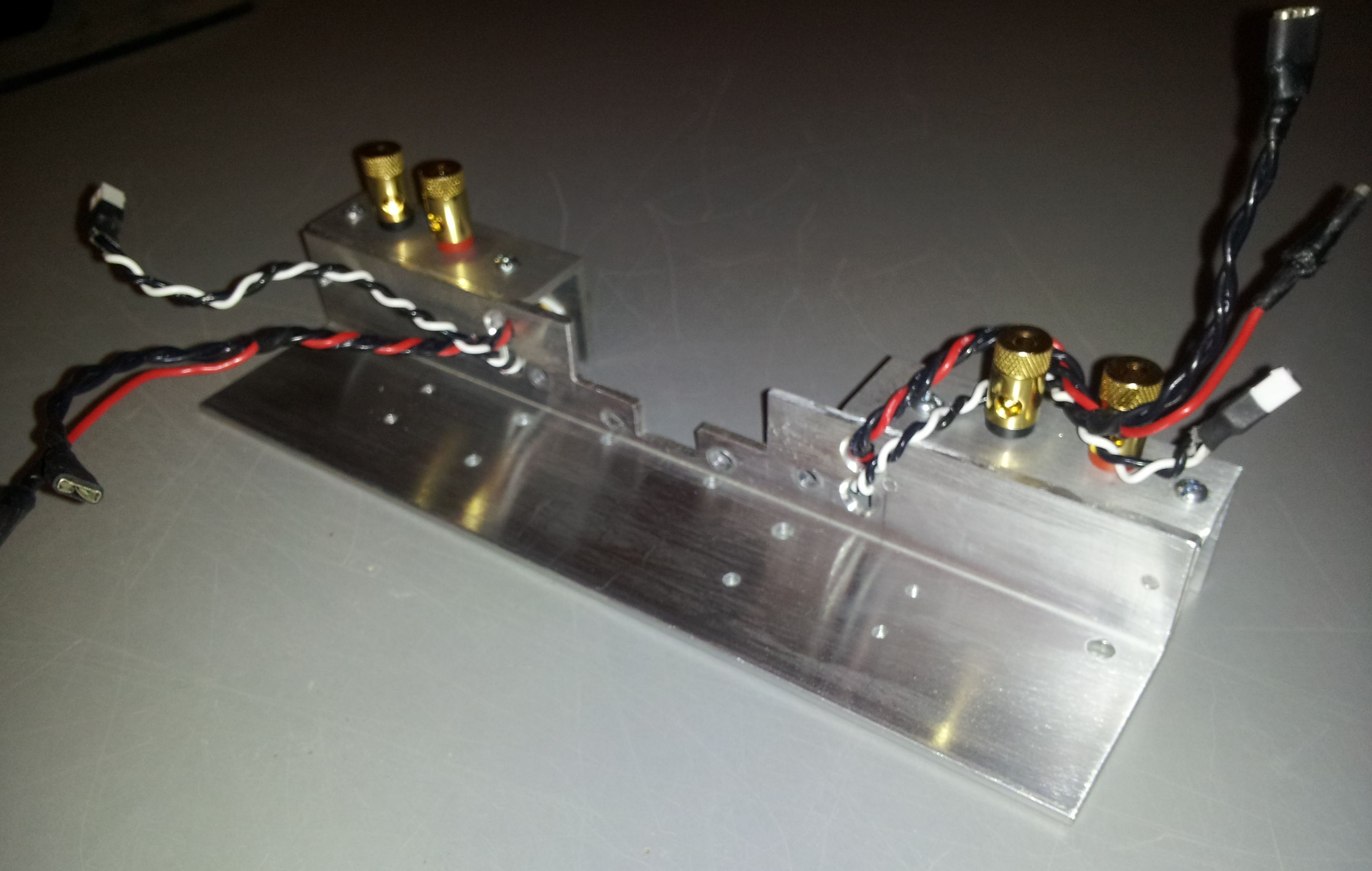

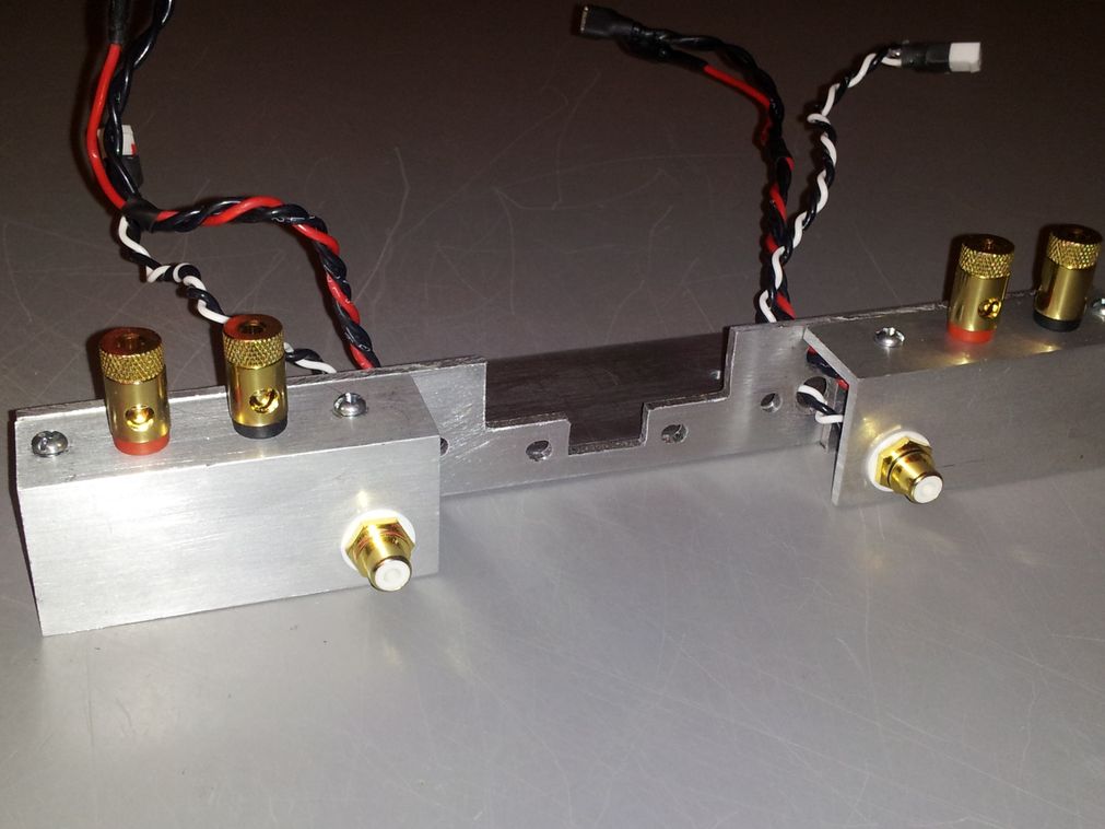

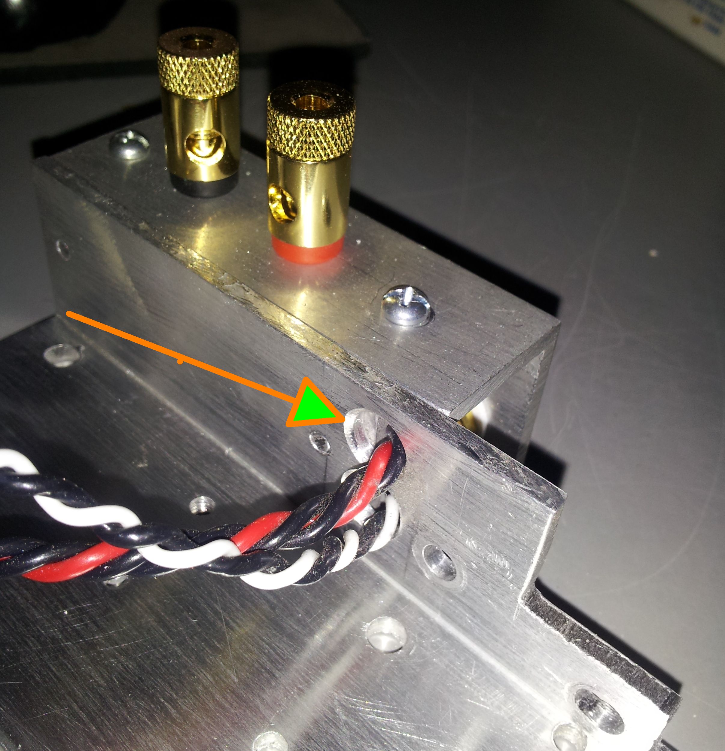

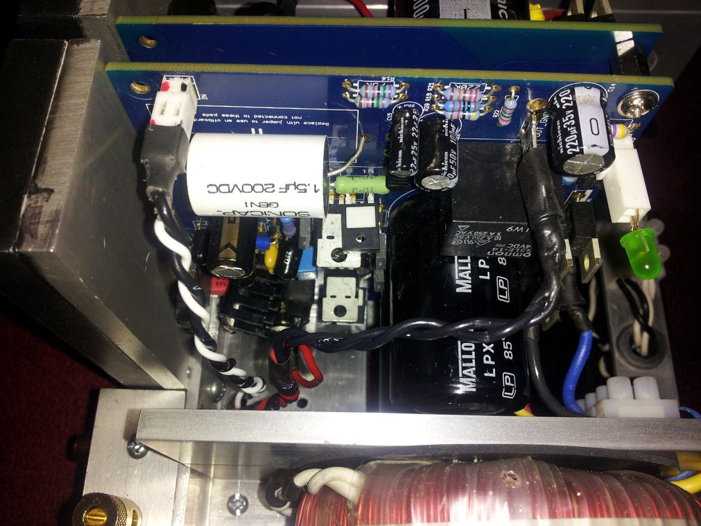

Oh, I forgot about the signal. With my chin still firmly mounted on my palm (visualize “The Thinker”) the following developed. There wasn't enough room to mount the posts in the standard position without inteference with the cooling tubes. A 90 degree flip did the trick.

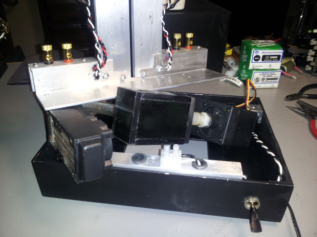

More corner removal to prevent the possibility of a short from insulation damage.
Looks like everything fits.

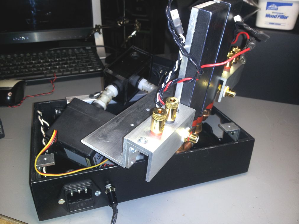

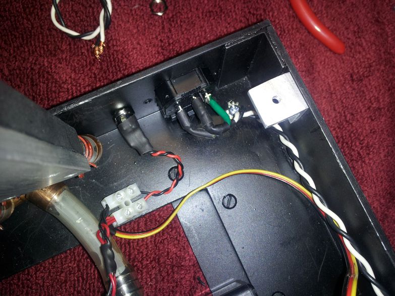

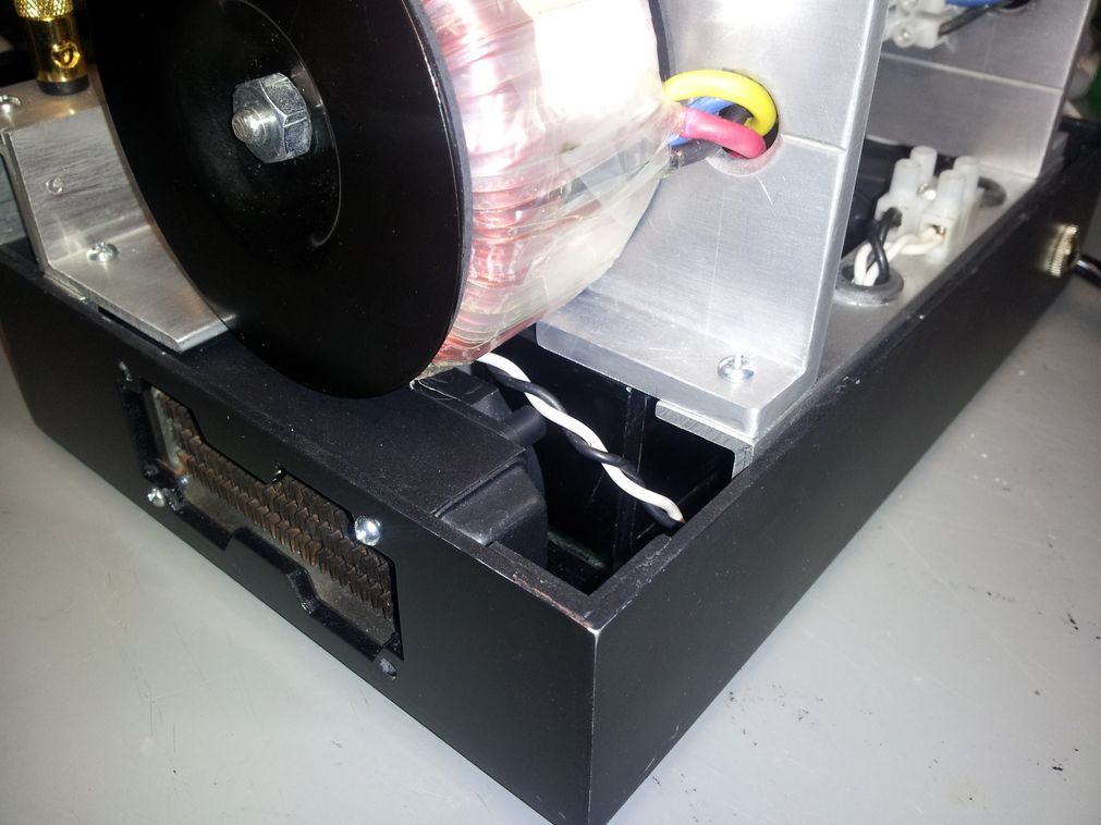

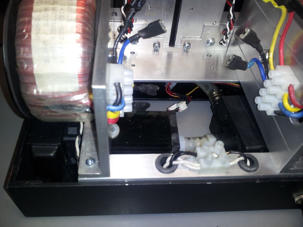

Wall wart DC socket for pump/fans, AC inlet with self-contained fuse and safety ground lug.
Putting it all together with wiring. Hoorraay!

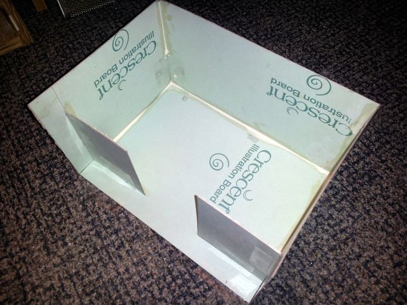

Cut and tape together possible cover from postboard. It was then glued together and all the tape removed.

There you have it. The anatomy of a BLAT. Great fun and a worthy challenge. Probably not where Dario thought his excellent design would end up, but I couldn't resist. :devily:

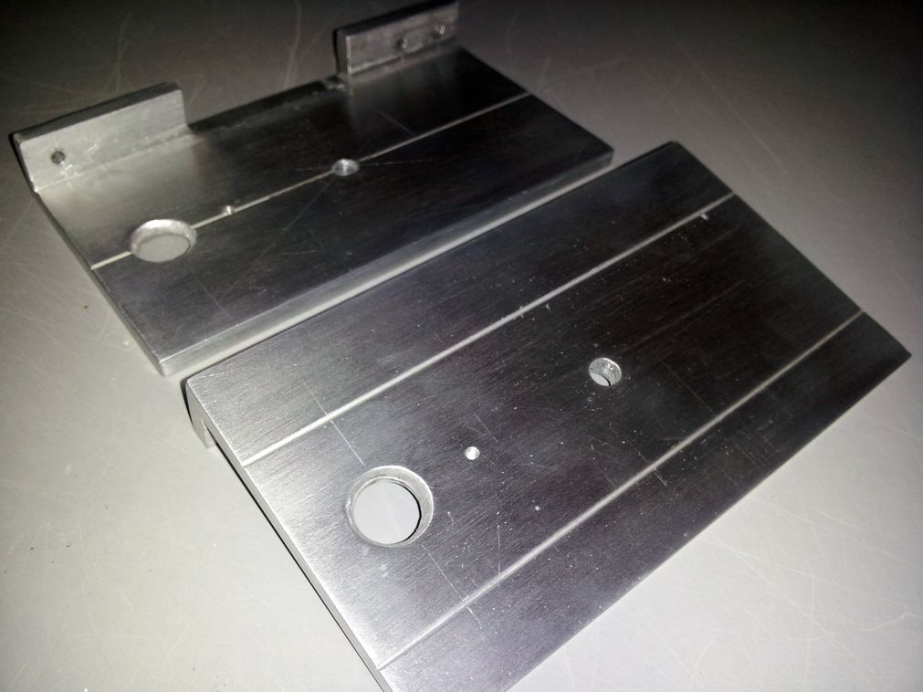

The third version uses a product with a thicker base that allows direct drilling of blind tapped holes for component mounting.
Layout marks for outer fin removal to establish final width.
Mark fins to be removed to create inlet and outlet paths.
Metal was removed using a carbide tipped blade on a table saw.
Here the halves have been drilled a tapped (one side) and placement of paper automotive gasket material to isolate I/O channels from main cooling segment - attached with GOOP Marine Adhesive.

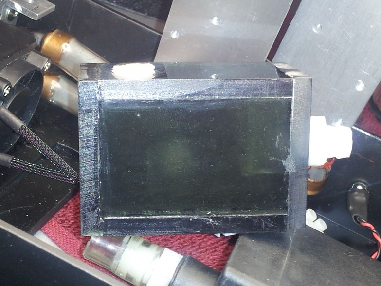

Full width flow holes are drilled. Marine Epoxy Putty is used to cap and divert alternating front to back circulation paths as needed. (Not completed on this unit) Various holes will be either plugged or added to create optimum flow pattern.

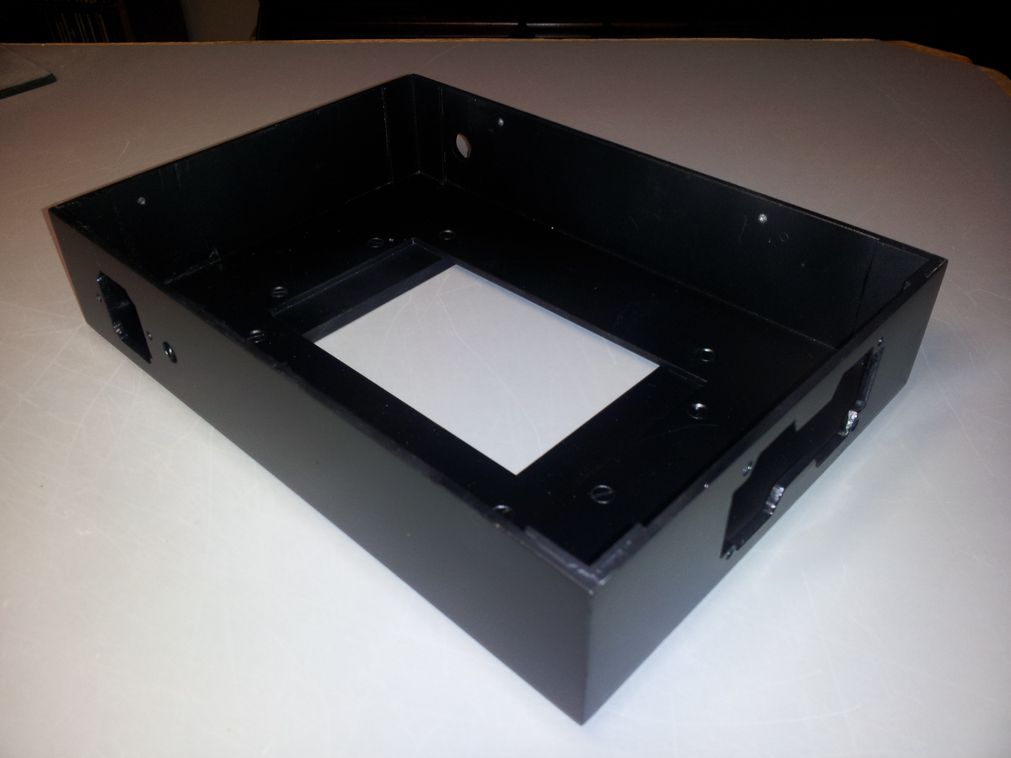

The major change in this third version is the elimination of several copper and plastic tubes by using a laminate of thick Plexiglas. Here is the construction before final drilling.
This is the current module with inlet (low) and outlet (high) passages with internal 90 degree turns.
The bottom element consists of a paper gasket (not shown), a matching flange and another right angle turn drilled module.
Upper flow tube unit is attached with threaded rod anchored in the aluminum plate at the opposite end and secured with acorn nuts that prevent leakage. The original steele rods and nuts rusted quickly and were replaced with brass.
The lower unit is attached to the amp floor using 6-32 screws.
The chassis is designed to be modular - amp, power supply and cooler. Again, the use of thick Plexiglas aided in quick prototyping and adjustments. The base is a pair of Peter Daniels Universal PS boards populated with 33,000 uF caps and Fairchild Stealth 8A 600V rectifiers. That's an Antek 500 VA toroid.

Rails are standard local hardware aluminum angle.
Switch, fan and mains inlet cut-outs.
Amp module floor riveted to intermediate rail supports. Added braces, cooler cut-out and rubber grommets for power leads.

For the reservoir Plexiglas again comes to the rescue. Any size/shape can be made and the medium threads almost as cleanly as metal.
The copper fitting is called a "stub rotating 90" and allows for easy adjustment of placement, angle and connecting tube length.
The plugs are modified standard fittings.
There is a diverter plate that enhances the potential for air bubbles to disperse to the top of the cooling fluid.

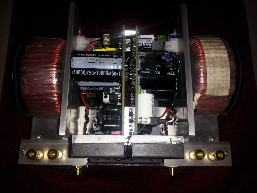

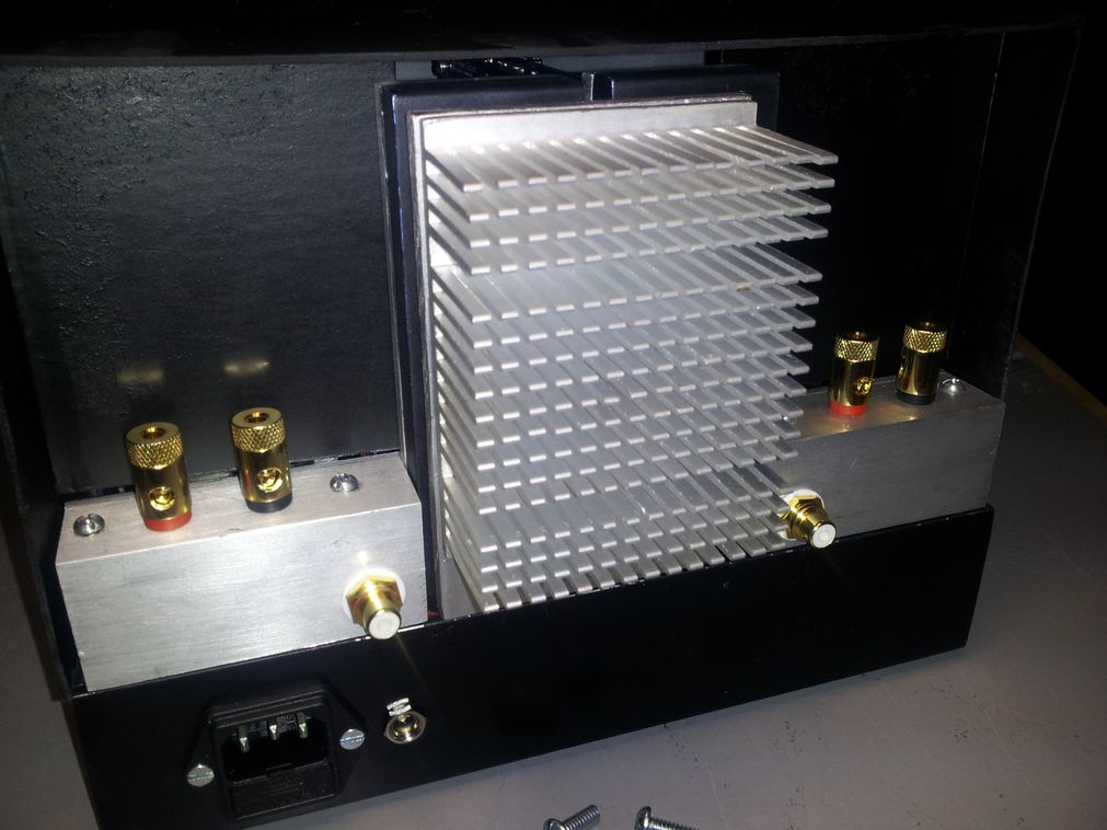

Putting it all together!!!
With Honey Badger Clone
With F5 module.

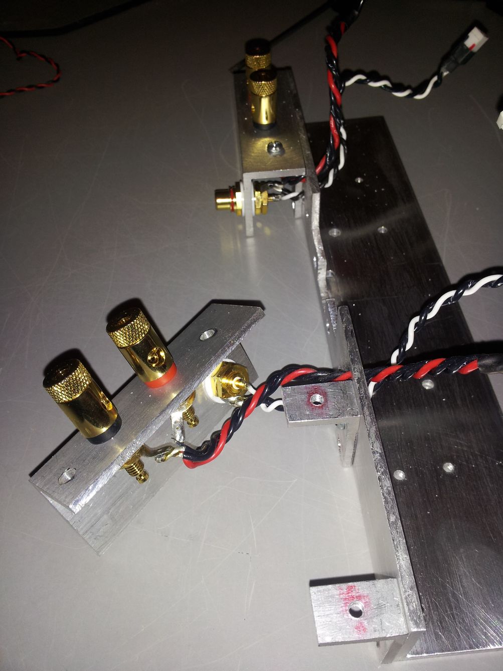

I/O RCAs and posts now installed. The yellow fuse is on the hot speaker lead and was added at the suggestion that the 500 VA transformer might be a little overpowering. Not sure if/how it could affect the signal quality.
