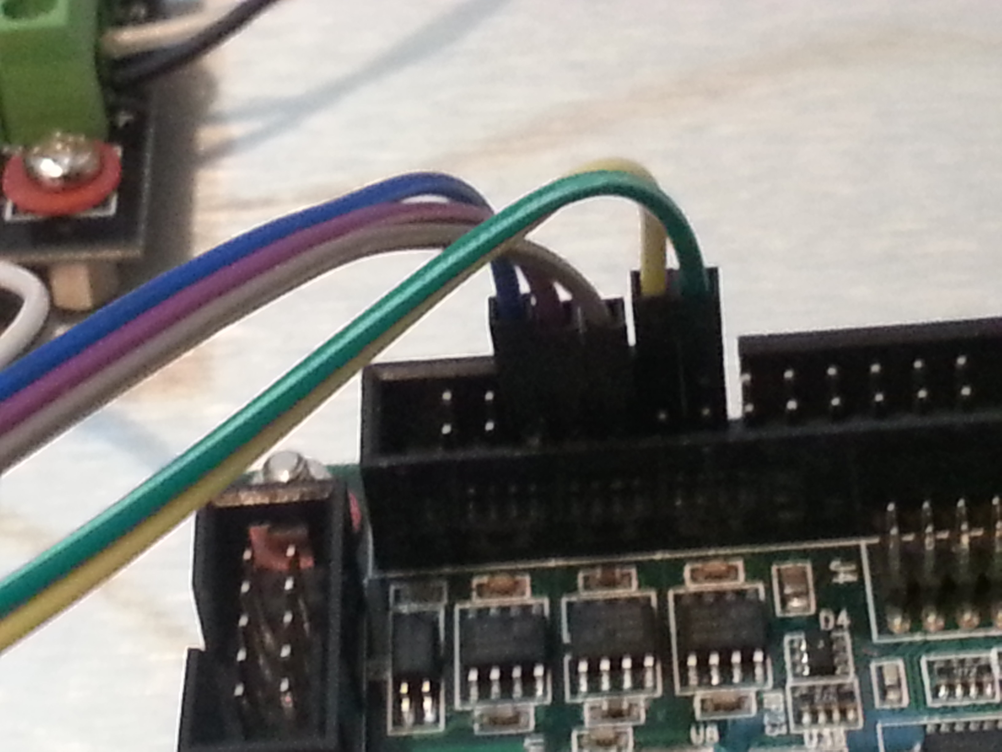

I've connected DAM master clk out to BBB master clk in, and clksel respectfully.
So fat I've got 48/96k locking (constant light on on DAM). But the music is some how distorted.
And 44.1k is not locking at all.

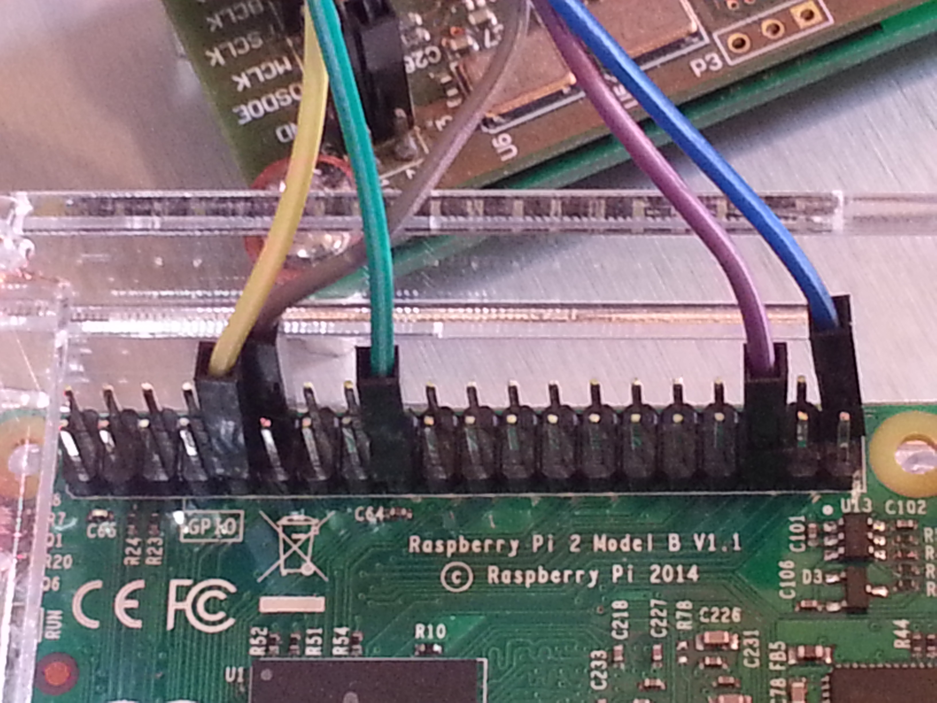

When I issued aplay -l through putty.
I got the message " no soundcards found...".
I followed the instruction from here (Configure to work with Soekris DAM1021 DAC) :
Raspberry Pi B+ & 2B | Voyage MuBox
I found the Dam1021 led brinking, suggesting that it cannot lock the source.
Did I make wrong connection?

Think I got archphile to work.
Chooses i2select ang mamboberry dac.
Reboot
This made 24bit material work. Not 16bit
Then
Uncomment device_tree_overlay=hifiberry-dac in /boot/config.txt
Added device_tree=
Like this.
Then edited:
/etc/modules-load.d/raspberrypi.conf
to:
Reboot and voila 16bit worked.
Just the same recipie as voyage
However the problem described earlier remain.
Now the dam1021 "relocks" on every track and pops come for each song.
