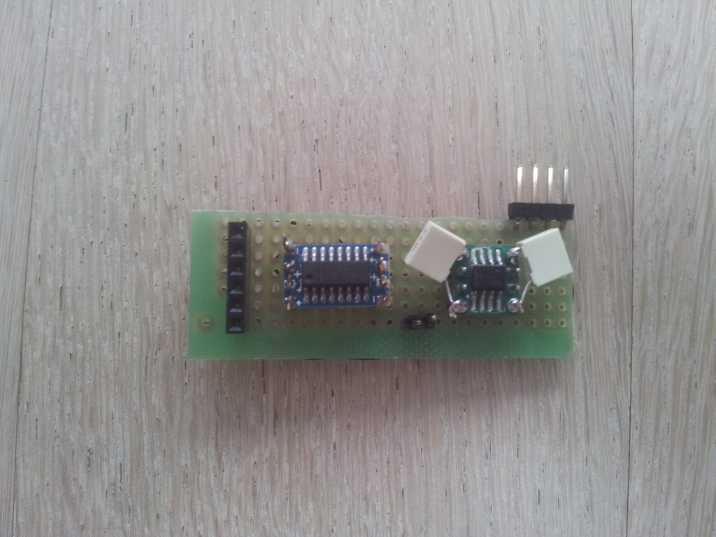

A cheap RS232 to TTL serial converter with isolation barrier. MAX3223 + ISO7221M used, because that's what I had at my disposal. But any similar combo will do. Can be powered from 5V or 3.3V dam1021 rails.
Yeah, it's ugly, soldering wires to header pins can be tiresome, but it works!

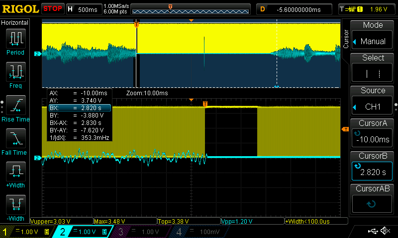

I did a small investigation about DAM loosing lock with Volumio RPi source when changing tracks or skipping to a different location within the same track.
This is with unmodified DAM hardware, using firmware v0.9 and EQHQ_v2 filters.
It turn out to be the word clock signal (LRCLK/FSCLK) that stops for about 20 ms. This is different from Amanero, where bitclock is interrupted. The result, however, is the same. It causes DAM to loose lock for 2.8 seconds with all the accompanying ugliness of DAM relocking. There is that high frequency 4Vpp destroyer pulse in the middle of locking period, and the ramping up of sound after the pause also happens with a very ugly blurp.
As reported by several people here, it does not happen with piCorePlayer because it does not stop any of the clock signals when skipping tracks.
piCorePlayer uses sndrpihifiberry I2S driver for the generic setting, while Volumio uses sndrpirpidac driver. Configuring Volumio to use sndrpihifiberry driver does not change the relocking behaviour, so the problem does not seem to be with I2S drivers. Perhaps it is caused by some mpd behavior in Volumio.
In summary, piCorePlayer works well if you have Logitech Media Server in the environment. Volumio, on the other hand, is pretty useless in combination with DAM.

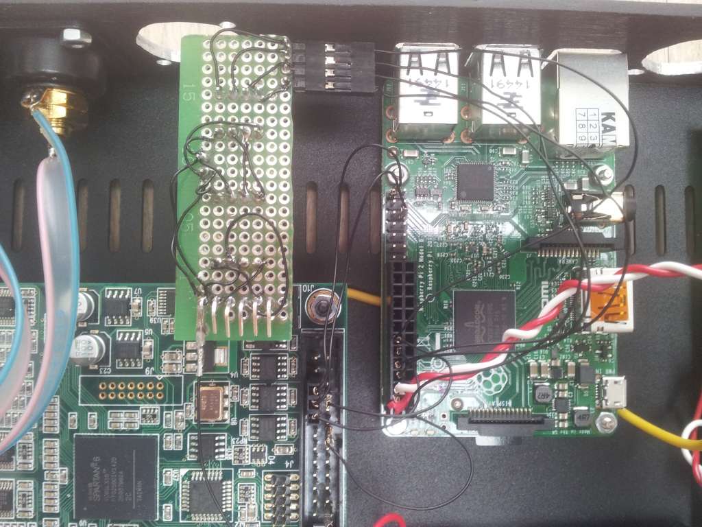

sketchy diyaudio 101:
Got external clock synced with r2r
BBB is running volumio with Botic kernal
with master_clk option 9
BBB uses external master clock for 44k1 and on board for 48k
