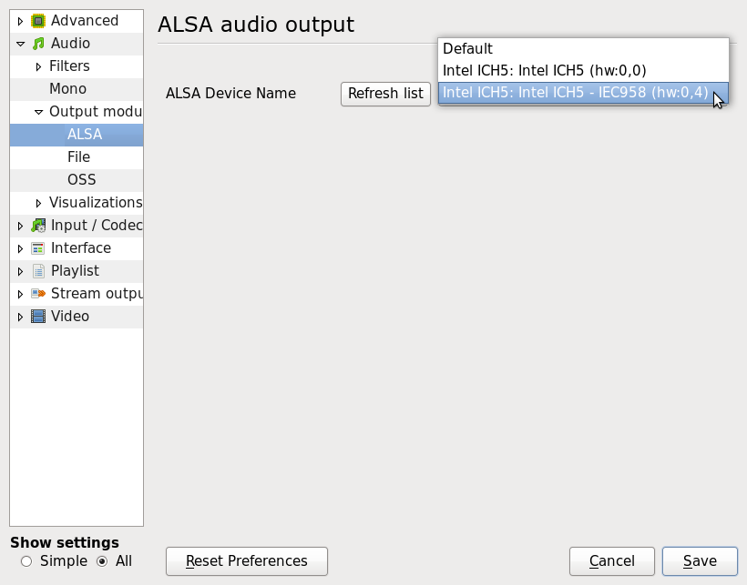

VLC has a preferences screen (Ctrl+P). In the audio section you just choose alsa as your output module and select your desired sound card. Did you actually look at the configuration screen?

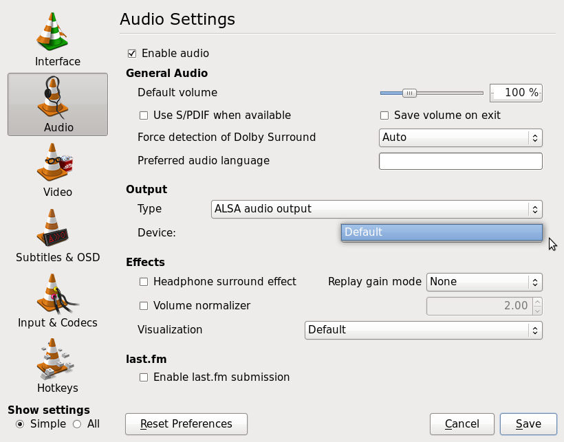

Yup, tried this before. It is possible to choose Alsa output, but for the device there is no choice but "Standard"; no soundcard or similar. And with this configuration it always plays via the onboard card.

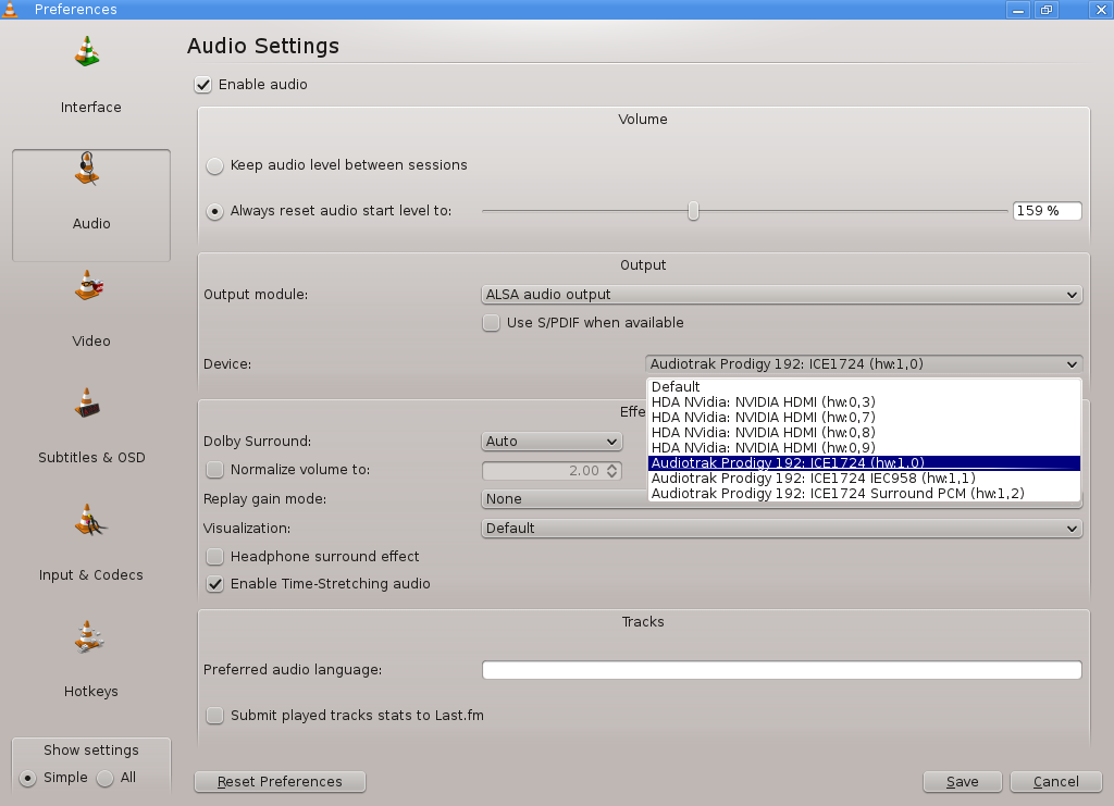

Interesting. This is my VLC config on archlinux:
Yes, interesting. Looks the same on my netbook, except the choice of devices, just "default".

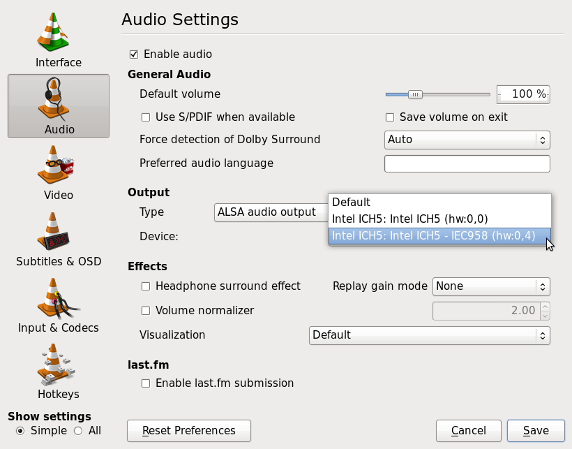

Indeed, VLC 1.0.2 on my ubuntu karmic does not open the roll-down alsa device select - see the first screenshot. But the advanced config mode (ALL) works correctly - the second picture. Voila, afterwards even the simple mode lists all the devices ok - the third screenshot. Buggy, ancient, but apparently there is a way.
Yes!
